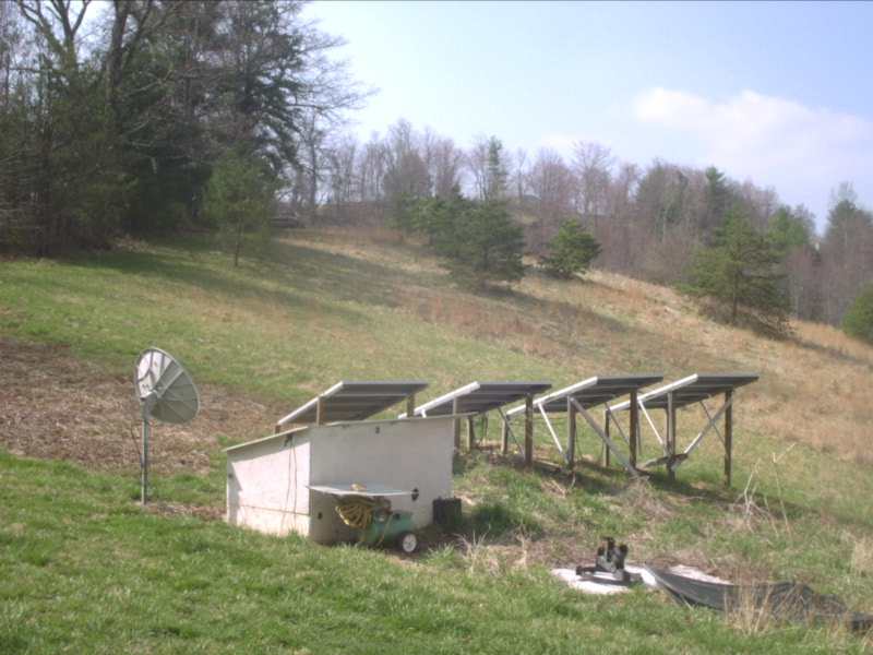

The above is our system as it sits currently. The dish is our
internet satellite uplink, from Starband.
The shed contains the batteries, electronics, and generator.
Wiring back to the office is buried. The disassembled C band dish
on the lower right will be converted for two uses, a radio telescope,
and a solar concentrator using aluminized mylar as the reflector.

For background, here's the basic system. We have 16 120 watt
Solarex polycrystaline panels, 12 375 Ah 6v batteries hooked up as a 24v
bank, a Cruising Systems solar charge controller, and a Trace SW 4024
inverter. All of this is outdoors, the batteries and major
electronics are in what we call the energy shed, a 4 ft tall 4 by 8 ft
little building with a roof that hinges up in segments and side doors
for access to things. That's just the business, my house has it's
own system and they can back one another up. One bay of the energy
shack holds a fairly unique and very efficient backup generator.

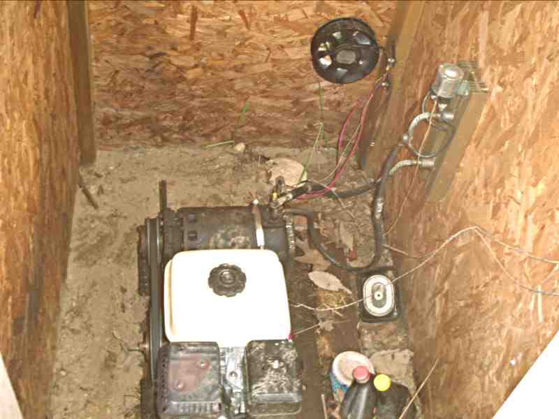

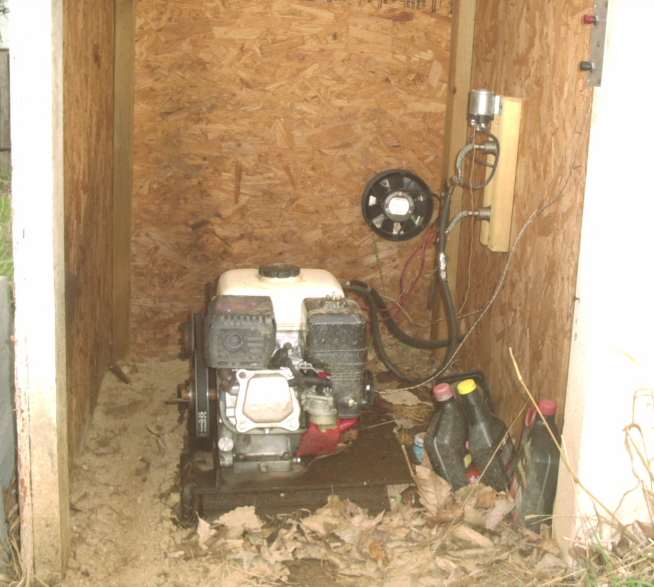

In the picture, you can see the actual surplus generator, the 24v
cooling fan, the coupling diode on a heatsink, the starter solenoid, and
the field resistor (mounted by fan, red wires). And, oh yes, the
mess one accumulates in a few years runtime. The wires trailing
off to the right go to the start/stop buttons. We have, in the
past, made these remote-start. This was a bad move. It's
much better to force the user, even us, to at least look at the thing
before starting it. Not having a big remote gas tank ensures this
as well. Failures in the past have included trying to start a
motor that was hydro-locked due to a piece of grit getting into the
float valve, filling the engine and crankcase with gasoline, and putting
the rest of the bulk tank on the ground. A 1000 amp fuse blew,
luckily without igniting the gas! It's better to enforce some sort
of inspection each time, one catches the odd loose bolt or bad belt
before vibration damage that way.

To make a long story short, a lot of putzing around established that we
wanted a 7" pulley on the 5.5 hp Honda motor and a 4" pulley on the
generator, so that we could run the Honda at it's most efficient RPM and
the generator the same. Larger pulleys are better than smaller, as
at around 5hp, you are pushing the torque a V belt can transmit. A
massive approximately 2 ohm resistor made from part of an old electric
dryer heating element (thanks Dad!) handles the field current
setting. This was adjusted until with the Honda throttle wired
wide open, we got the best current and fuel efficiency -- running the
Honda at its torque peak, rather than at maximum horsepower. In
our application, even with "no sun", about 3/4 gallon a day (about 2
hours of runtime at roughly 100 amps output) of gasoline is consumed to
run a rather large computer network, complete with color laser printer,
satellite internet uplink, chemistry and physics labs, machining, and
anything else our engineers think they need to play with. Of

parts. If the belt gets into "whipping" it generates huge
vibrations and side torques on the various bearings, a bad thing.
This is especially bad for the Honda's crankshaft seals, which will
start to spin in the casting and leak oil if severely abused.
Currently the best we've found is an oversize V belt used in Simplicity
Legacy tractors for running the PTO. These last seemingly forever
compared to "extra good" belts from the tractor supply store, and have
low losses otherwise. I've yet to find a generic supplier for
these, but since I have one of the above mentioned tractors, I have "hot
spares" available, and worn belts from the tractor work fine for
this. Basically, the design uses the shortest practical V
belt. This is to keep the overall size down as well as reduce
whipping. A little length adjustment is provided for via slots in
the generator mounting. It's rarely needed however, as the glory
of the V belt (the good you get in exchange for accepting their other
sins) is that they pull themselves down into the V of the pulley when
torque is applied. Generally, when it's time to adjust, it's time
to replace it anyway.
Did I mention, that in the usual C-Lab way, this was cheaper to build
and to operate than anything normally commercially available? The
reliability is awesome, and this thing will start in sub-zero
temperatures even without using the choke. The generator, used as
a starter motor, simply cranks the thing so fast it will warm up quickly
from friction and oil viscosity (the same thing) and then start.
Even "dead by solar system standards" batteries will crank this just
fine, but of course you could always pull the cord. Once started,
the solenoid is released and a 400 amp diode on a heatsink carries the
current to the battery bank. This is a safety issue -- I'd love to
get rid of the diode losses. An older system used a latching
solenoid, but what if the engine shuts down (or tries to) due to low
oil, no fuel, and so forth? This puts the generator back into
motor mode, drawing about 200 amps and the only symptom is the slight
change in noise level. You can imagine that this only happens when
the weather is terrible and it's in the middle of the night on a
Saturday (no parts available till Monday), and you would not be far off.
