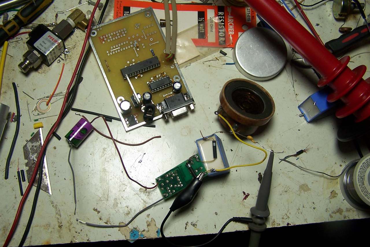

Standard counter kludge parts
The PCB in this picture is a dev board I did awhile back for working with 28 pin PICs. Kinda handy to start right off with RS 232, power supply, and in-circuit programming all working.
