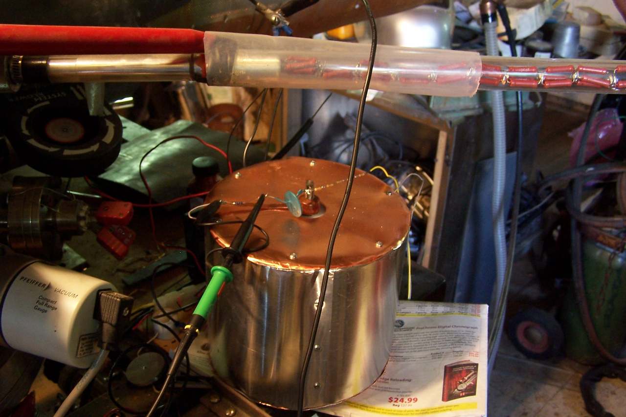

Temp lashup for testing. Neutrons coming out from about where the fan in the upper left is.
Here's the lashup. I pretty much used what the data sheet Joe found suggested. 5 ten meg resistors in series. 210 pf coupling cap, 10k load R to the scope probe.

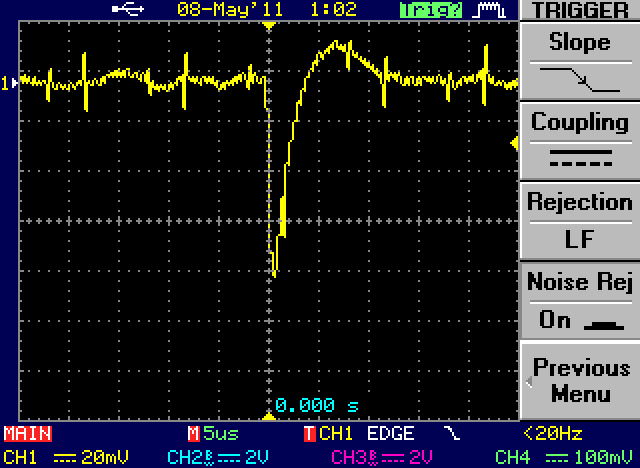

Screen shot from scope
So here's a typical pulse. I could have cleaned it up a bit more with scope settings (heck, it was in 1 ghz sampling peak detect mode which gets *everything* no matter how slow the sweep), but till I get rid of the radar interference, no point really. I got pulses from about 1 div up to about 150 mv or so, various backside ringing, nothing all that hard to deal with compared to any other detector. If we didn't know it ran in the mysterious corona mode, you'd never notice. The normal overshoot after the pulse due to cap charging, nothing special -- looked better than in that paper Carl found.
The thing is, it's not real sensitive at all. The B10 tube below it on the same rack was going 100hz or more while this was doing 1-2 hz counts (lousy eyeball estimates of course), and the 3He tube was cranking at hundreds of HZ on the same neutron output. On the good side - it has next to zero background, undetectable right now till I clean up that other noise. Note that this isn't way off scale from the estimate you'd make based on the comparison of tube volumes and surface areas -- the other B10 tube is enormous, and so is the 3He. There might be another 2-3x if we can pick off the marginal pulses from reactions oblique to the tube walls with a lower trigger threshold.
It's already a cubic crap-ton more sensitive than a BTI, and realtime -- bonus.
The datasheet says "1400-1600v" for this. I tried 1400, it worked, I tried 1500, it works better -- and now I'm up here typing. More to come, perhaps, since the fusor is ready to go with a single button press right now. But it really looks like I need a nice, tightly shielded loud output analog preamp before doing much more with this. Should be a matter of two transistors more or less, probably off a 9v battery, as that will all fit inside a little box I can mount on there tight, and give nicely big pulses out that will make this noise not an issue at all. I'll see if I can design one for this signal that won't run batteries down fast -- I'll shoot for 1 ma.
Looks like a qualified winner -- I'll see if I can get it better. If we can kill off that RF noise (which isn't this thing, as I said, the scope shows it with shorted probe just being on, and not even connected to system ground to pick up ground loop noise) maybe we can set a decently low threshold and pick up more sensitivity. It does count even when the big fusor is very much underperforming -- it would work fine for someone just starting out.
FWIW, I happened to have a spark plug wire connector sitting on my end table that fits the nub on the tube perfectly, so that's what I used for this. A type plate cap ought to fit too. I grounded the detector tube with a bit of spare flashing I shoved down in the hole with it for a tight fit.
Interestingly, even with the very sloppy looking lashup, even when I had arcs on the main HV very little of that got into the scope signal...that last modification to clean up any radiation from that at the source really works nicely.

More pix so you can see another viewpoint. For these, I put the thing right where I normally put the neutron oven == right on the tank, but about an inch spacing as it's too big to fit inside the flanges. So, call it about 4 times closer to the "source" wherever that really is.
See the radar antenna turning?

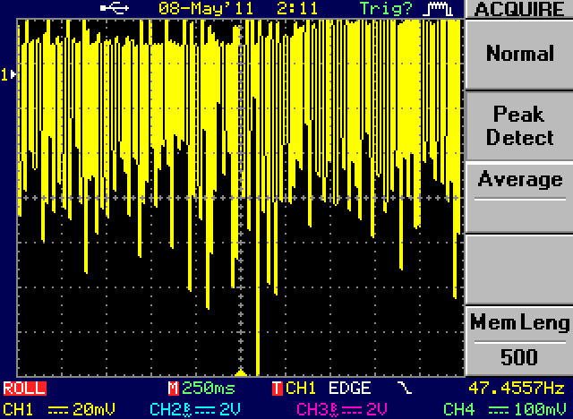

It does clean up a good bit when not in peak detect mode on the scope, but with a slow roll, you don't see anything real either, so I left it that way. See the radar antenna going around? It has back and sidelobes, so it's never gone completely, but in a fast mode (as in the previous post) you can see the rep rate....The HV is on in this picture, just that there's no gas in there till I hit the inlet solenoid button. Plenty of X rays of course and HV for this is 50kv (since it's not in current limit). All the phosphors in the tank are glowing brightly and my geiger counter is about 5x background (behind 2" of lead). It will go to 10x background at full fusor power, but only was getting to about the same numbers for the picture below.

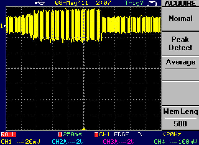

Now, here with the fusor running very conservatively ( 35kv, 15 ma) here's what it looks like.
Should be able to tell the difference, eh?
This was with the fusor not really cranking - I have a sort of stable, low output mode I use to test things like this. Boy, putting it up close to the action (no other changes) does make a difference.
Could be since it's near the 3He tube here it's seeing some neutrons reflected off its moderator too.
