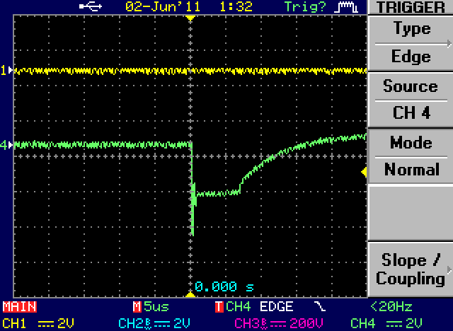

Postby Doug Coulter » Thu Jun 02, 2011 1:07 pm

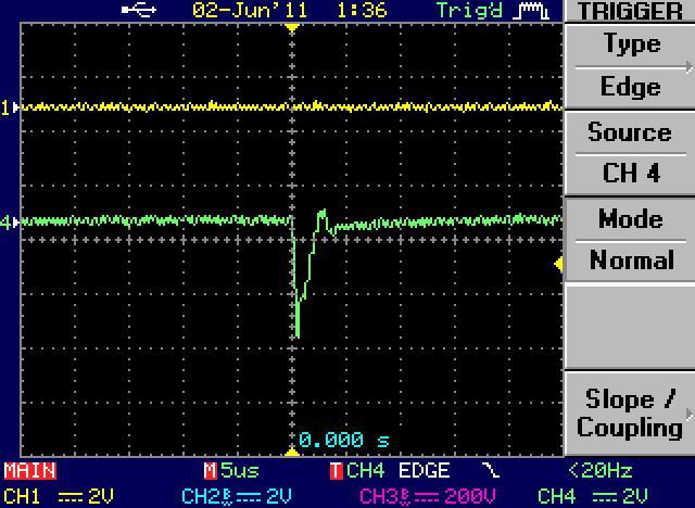

Here are some scope traces of the strange fake pulses vs what you see normally:
Fake pulses
There's this flat place in the fake ones.
Normal or cosmic hit
That isn't there for a normal pulse.
So far, this has cleaned itself up in some single digit number of minutes after turn-on of the HV, but I'm watching it close as I want this for my second fusor, and I want it reliable.

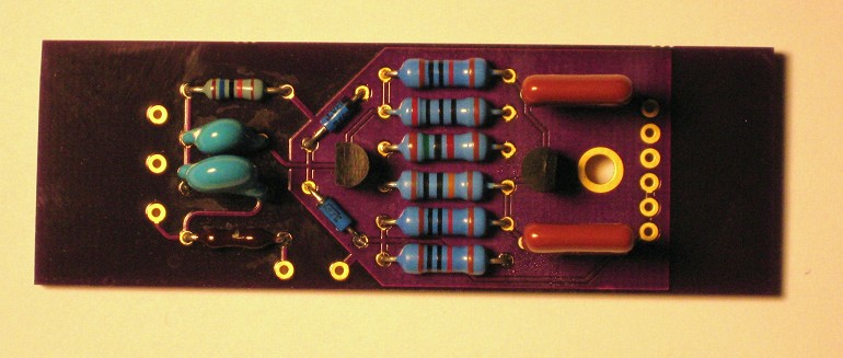

Postby Joe Jarski » Tue Jun 28, 2011 11:43 pm

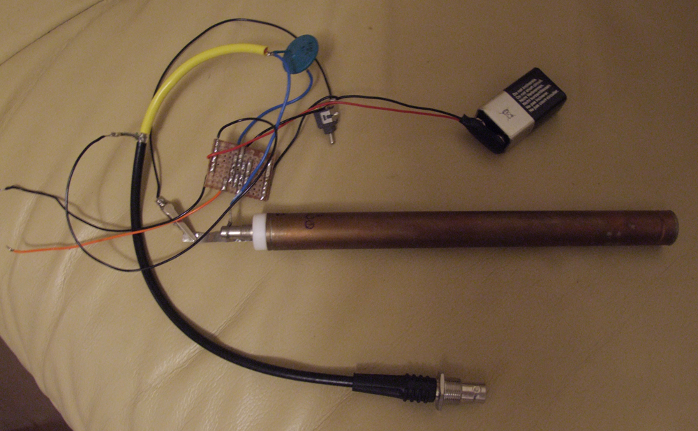

This could go any number of places, but since this preamp was built based on the schematic in the first thread I'll give an update here for now and maybe start another once it's complete.
This is the PCB that I made for the corona neutron detectors. The plan is to stuff it and the battery in a piece of 1-3/8" x 3" long tubing with the required BNC connectors on each end and a small toggle switch, then attach them directly to my B10 tubes. I haven't been able to test it yet, but I'll probably throw something together over the next few days and maybe listen for some background Ns.
Re: First light on SNM-17 3He tubes
Postby Doug Coulter » Wed Jun 29, 2011 8:09 am
Looking good - but a test is always a good idea, and you should get something "at all" from cosmic rays - you might have to be patient (a good DSO helps as it will save the last screen until the next trigger). I only get about 1 per minute here. Any new layout of parts this fast needs a test to make sure it doesn't oscillate from changed stray capacities between the connections - I took serious care in that other layout for that.

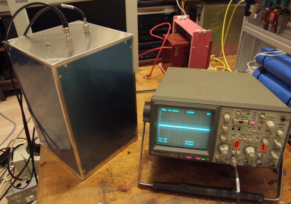

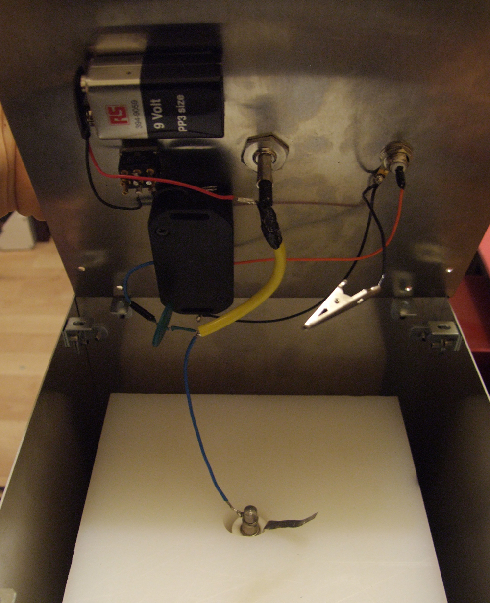

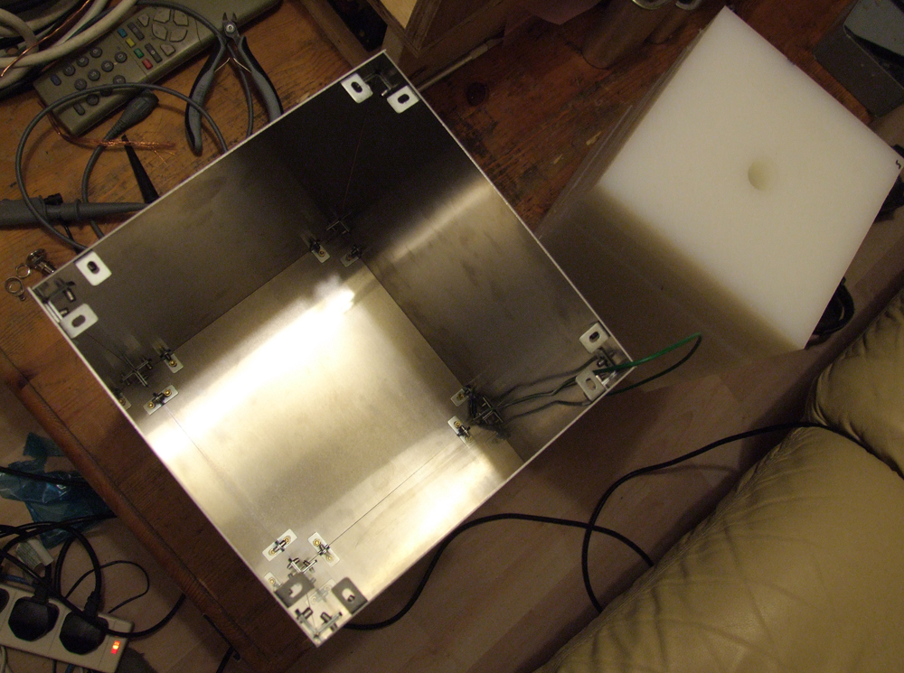

Postby JonathanH13 » Sat Aug 20, 2011 8:39 am
I have recently completed the housing for the 'other' 3He tube (the one mentioned in this thread). I have had it up and running for sometime - since Bill F came to visit - he actually witnessed it registering neutron hits from the fusor during a couple of runs. But it was housed in a large vegetable oil drum for electrical shielding, which did the job, but was too large and rather smelly. So I have built a customised aluminium box for it, which is smaller and better shielded.

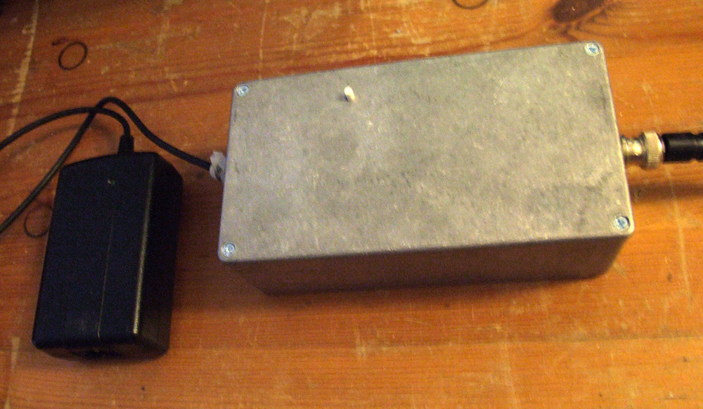

I also built the power supply for it described in the link below, and made sure it was well shielded in its own aluminium box:
viewtopic.php?f=9&t=290&hilit=power+supply
The tube registers a cosmic ray hit about every 10 minutes, and appears completely immune to noise or signal from anything else - all in all, a very stable and quiet detector. I will post some results soon - the next step is cooking up something to count the hits (maybe it's time to replace my 30 year old scope).

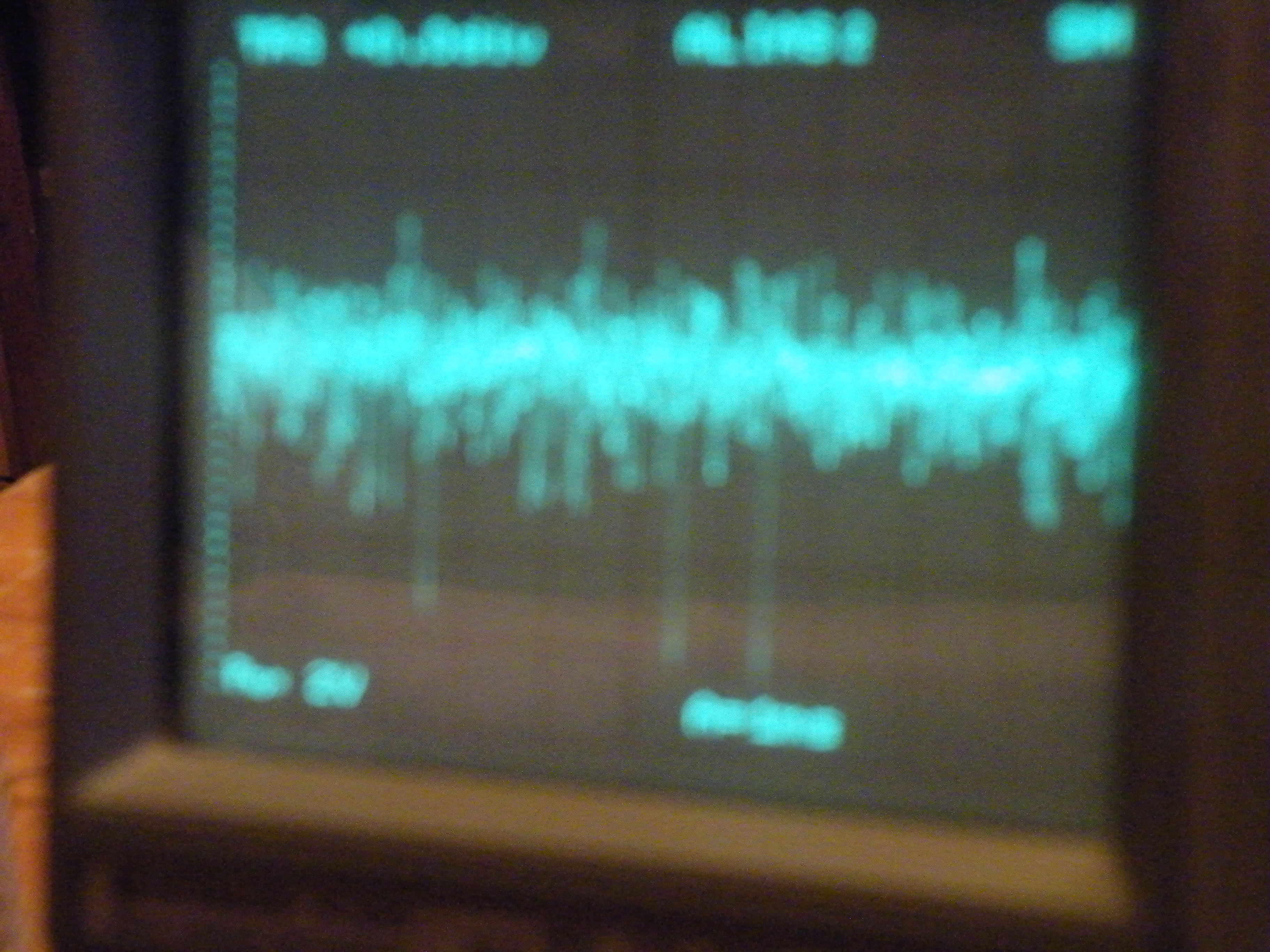

Postby Bill Fain » Sat Aug 20, 2011 2:23 pm
Jon, Hi. That's quite an upgrade from the "Charles Chips" type container you were using a couple of weeks ago; nice and clean looking. I did manage to snap what I thought was a "picture" of the scope when we were at neutron conditions (reasonable pressure, voltage, and proper looking poisser). It's rather out of focus, but after the 8 hour flight, no sleep, customs, tubes not operating, and walking completely around Paddington station to look for the bus stop, this might have looked in focus to me at the time. BTW thanks for picking me up when I got off at the wrong stop. Although blurry, your scope trace looks like Doug's, but with less hits, though hits nonetheless, I think. Compare this with Doug's last static shot of his scope at the end of his comments on page 1 of this thread (new3heFusionroll.gif). Again sorry about the quality of the image. -bill
a myopic view of Jon's He3 tube output

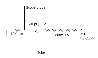

Could someone please clarify something for me, please. I'm a bit fuzzy on the intended meaning of this...
These tubes' data sheets say to stick a 50Mohm in series with the power. Then they say operational voltage is 1600V and typical coronal current 20uA.
Is the 1600V the voltage on the power supply, or across the tube? If I stick 1600V on these tubes I get a few 100 uA across them, but if I put 1600V across tube and 50Mohm resistor, then there is around 20uA through the circuit but this would only be around 600V across the tube.
Postby JonathanH13 » Sun Aug 21, 2011 2:54 pm
This is what I used to test mine & I think Doug has the same setup...
JonathanH13
Posts: 53
Postby chrismb » Sun Aug 21, 2011 3:57 pm
So, what voltage do you think is needed across the tube to make it work?
(..and does the 10k to ground achieve some funtion that the internal resistance of the scope can't?)
