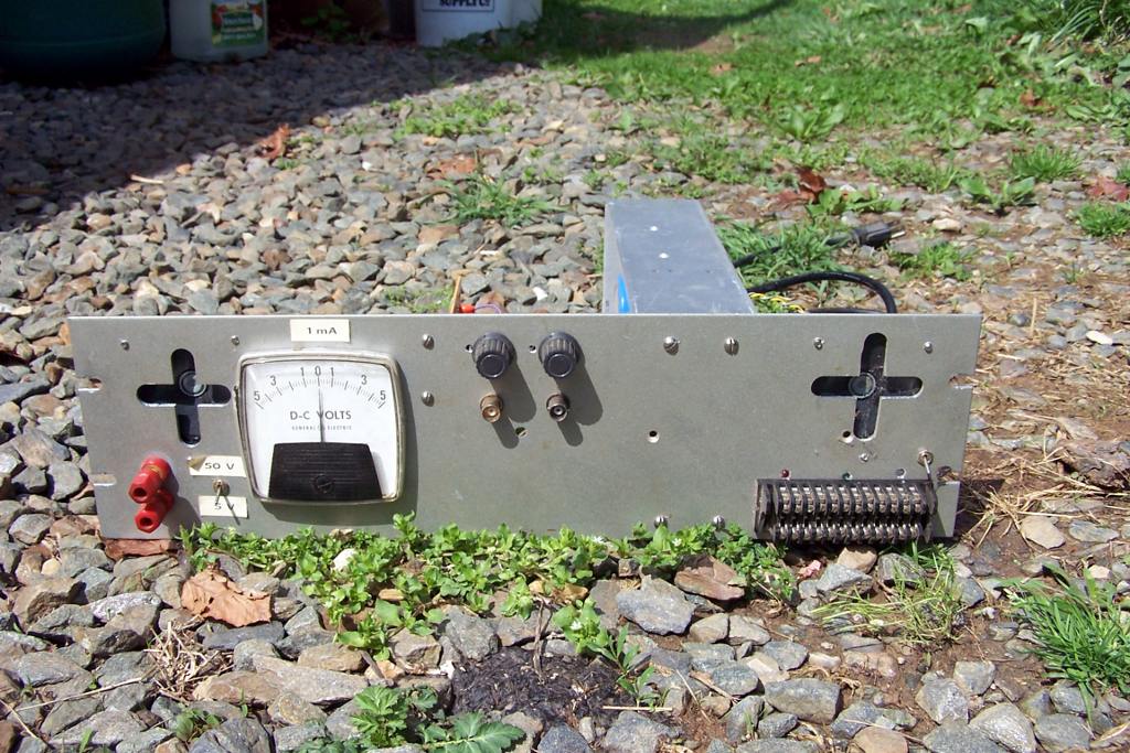

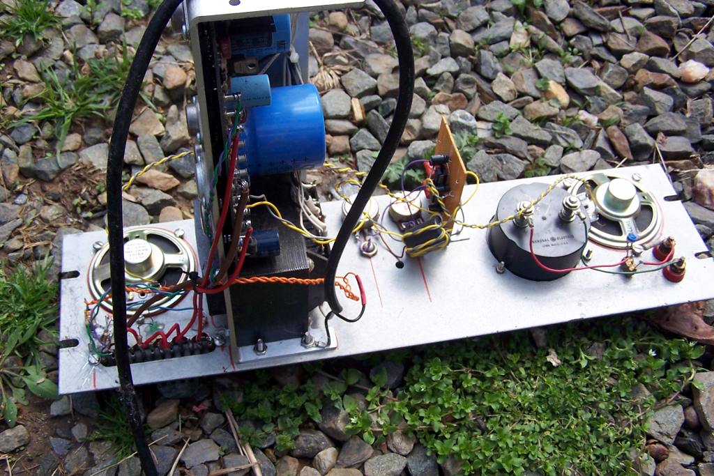

Edit: Here's what my new one looks like. The panel had the meter in it when I got it, but I added a lab analog supply (+5, +/-12v) and the little lm386 kludge and speakers from something out of a dumpster.
- Front
- Back
