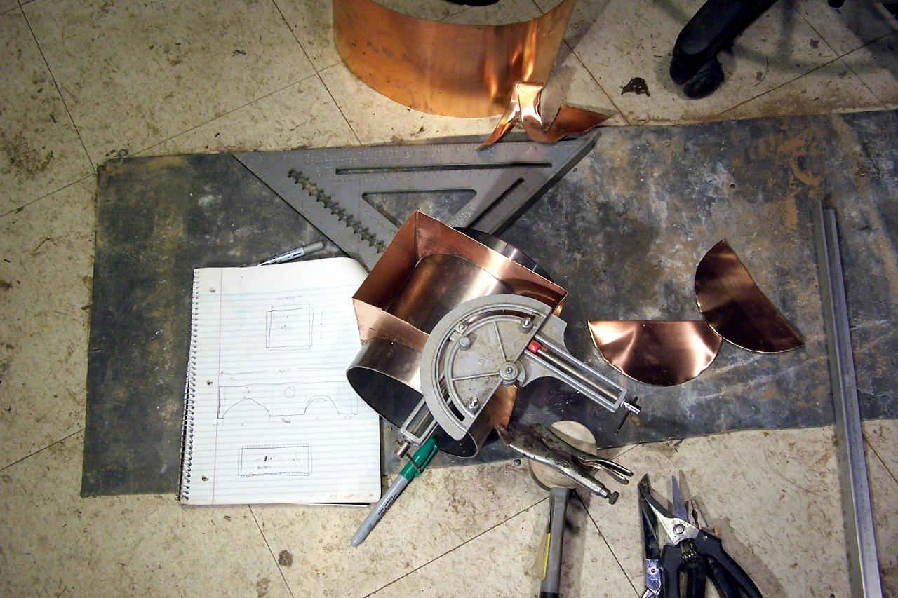

Here's where it starts:
The sides for the new oven sitting on a piece of SS pipe that's just like the one in the fusor, ready for initial silver soldering. I haven't put in the hole for the elbow for the copper pipe yet, it's pretty floppy now for that.

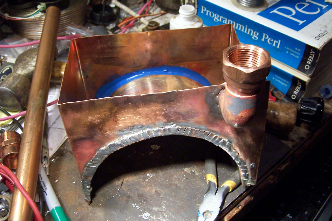

Another day, a little progress. I cut the bottom piece, shaped it, and soldered it on. Silver solder for some spots, hi temp solder for the rest, and I'll probably go back and touch up leaks with regular plumbing solder. I thought I might want the strength of silver solder and the high temp stuff, as regular solder gets weak fast when hot, not that this will be under more than about 2" of water pressure. Still to do is add the copper angle fitting (there will be a tubing straight up from this for filling, and condensation so it will drip back into the thing), and of course, the top (of this part, which is the bottom of the entire thing).
While far from perfect, this will be a lot easier to get the lead tight fitting around to stop the other X rays from leaking, and simple to make a lead-encased HDPE top part for, with our usual silver sample inbetween. Actually, we may have to move to indium or gold with the new output levels we're getting (way over 10m neuts/second is now all too easy for one's health). The odd RFI/EMI in the shack means we need to retain this so as to be able to trust our "quick feedback" detectors we log with a computer, along with results of activation. If it doesn't all agree - we know what to trust, and it's this. Of course, there will have to be a calibration phase here...a pain, but worth doing.

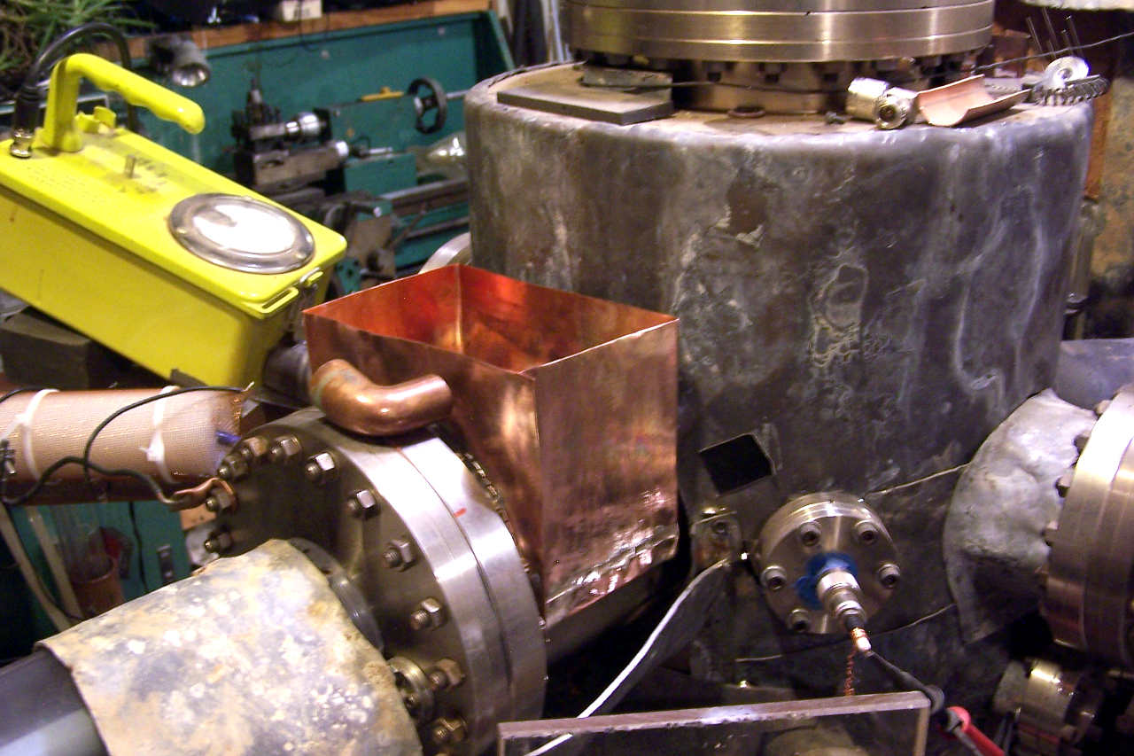

Here it is, sitting right over the place where the action is. It should also help keep the fusor shell cooler - I may even put in some heat xfer compound between them as once in place - it's going to stay right there anyway.
Fit on the real thing. On an identical piece of SS pipe, there's not a lot of light between them - it's a decent fit despite my sloppy work.

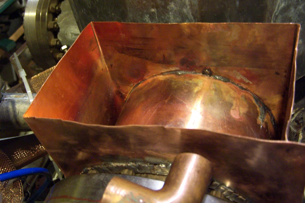

A closeup. I have no idea whether we gain much of anything (I doubt it) neutron wise from the long sides, but they should help with cooling if nothing else, and it being rectangular (well, nearly) will make putting the lead around it that much simpler. The 2" of moderator (ethylene glycol/water) won't quite get neutrons to thermal here - but it will get them down to the 1 volt range where the silver and friends are most sensitive. A thicker top cap of HDPE will thermalize any that happen to reflect back into the sample.
Closeup, I hope I never see the innards again. A few cuts from sharp burrs will do that for ya.

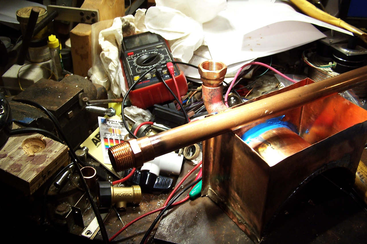

A litle more progress today. I've been making extensive use of the fact that I have solders available with very different melting points (protip) to do parts of this. Most structural integrity stuff was done with BAG-7 silver solder. I used high melt (mostly lead, 1% each tin and silver) for most of the soldering where sheer bulk was required (priced BAG-7 lately?). I then used regular plumbing solder (50-50) to fill in any little bad looking places. I will use that to solder the other fittings and the top, once I get there. While I solder pretty well, both electronics and plumbing, well, I just don't want to have any leaks or any leak testing process to speak of - time is money, hence the permatex blue (about the only kind you can use with copper, the ammonia the other types give off corrodes it and destroys any seal).
There will be a removable couple foot long 3/4" copper standpipe, then another few feet of quartz tubing (not because it's quartz, it's just the only clear stuff I have that fits right) to the ceiling, where it'll be cable tied to a screw sticking out of a joist. That way, I'll be able to see any evaporation/condensation that happens and know if things are getting too hot. I'll stuff some stainless steel wool into the top end to keep stray insects and so forth out of it.
Once the Permatex cures, I'll leak-test the bottom, solder in the threaded joint so the standpipe can be removed when wanted (filling, level check etc), and solder the top on. Then I get to make the other half, which should be easier. Just a bunch of 7" by 4.5" by 1" stacked HDPE blocks inside thick lead which will stick down to over-lap this part and keep the gammas down. I'll probably make that part 4-5" thick to get all the way to thermal neutrons reflected back into the sample. This should be a pretty good "oven" for silver and other activation "baking". And it might just help keep the fusor shell cool. We see some fusion at the tank walls when the shell isn't too hot - any is appreciated, and before we had to seriously limit (runtime * power) to keep the old oven from melting and stinking. This has a lot more thermal mass, and a way to dump heat as well. We'll just have to see.
To make the 90 degree angle fitting more robust, I actually made a too-small hole in the copper, then "flanged" it by driving the right sized peg through it while it was resting over that hole in the piece of wood in my vise. That one's mostly silver soldered as well, so that joint won't do something funky when I plumbing-solder in the threaded fitting.

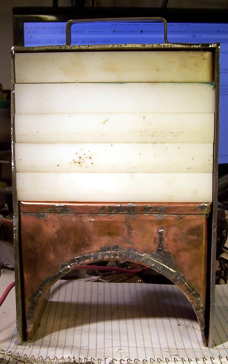

Had homestead chores today, so I only got the top and sides made for the top part. Front and back soon. The HDPE will be screwed in via the handle holes, and through the sides for the bottom piece, so I can lift this part off the sample, which would be sitting on top of the copper. I'm going for a low-rad diet here, so I'm not skimping on the lead anywhere - especially here, where "the action is" - this is only one of several layers of shielding back there - but this one I have to be able to get to quickly for measurment of sample activation, at least if I keep using silver (I may "graduate" to indium or gold, since our output is now so much more and expected to continue on that trend).
The remove-able part of the moderator assembly, which will also have some X ray shielding. This won't do much for really hot gammas, but less of anything is good.
Obviously, the front and back will have cutouts for the fusor tube, as well as various clearances for the pipe and the fusor flange bolt heads...that's going to take time to get done, just a lot of fiddly bits and fjords.
I realized that with this design (after I did it, it wasn't planned) that we can have our choice of hotter or more epithermal neutrons via just putting less water in there...cool, or well, warm.

Getting there, and now it's seen "first light" and it seems to work just fine. It would be better if I had more-intimate thermal contact with the tank, working on that, and need some magic heat-sink grease or the moral equivalent of it (but something that won't creep away).

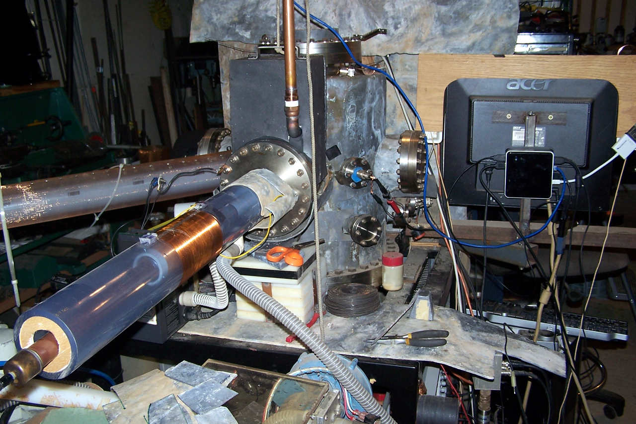

Looks like this now:
New oven in place. That top is HEAVY due to the thick lead, and a bit sticky to the bottom, so I painted it all with graphite paing and greased it. Still going to want a pulley for that rope instead of a simple loop stuck in the ceiling.
Tiny X ray leaks around this are nasty. I'm going to have to make some more leak stoppers that will still allow the top to come off for sample access. But it worked well on first light, can't really tell any difference from the previous one, which is good, I think I can assume the calibration is about the same.
