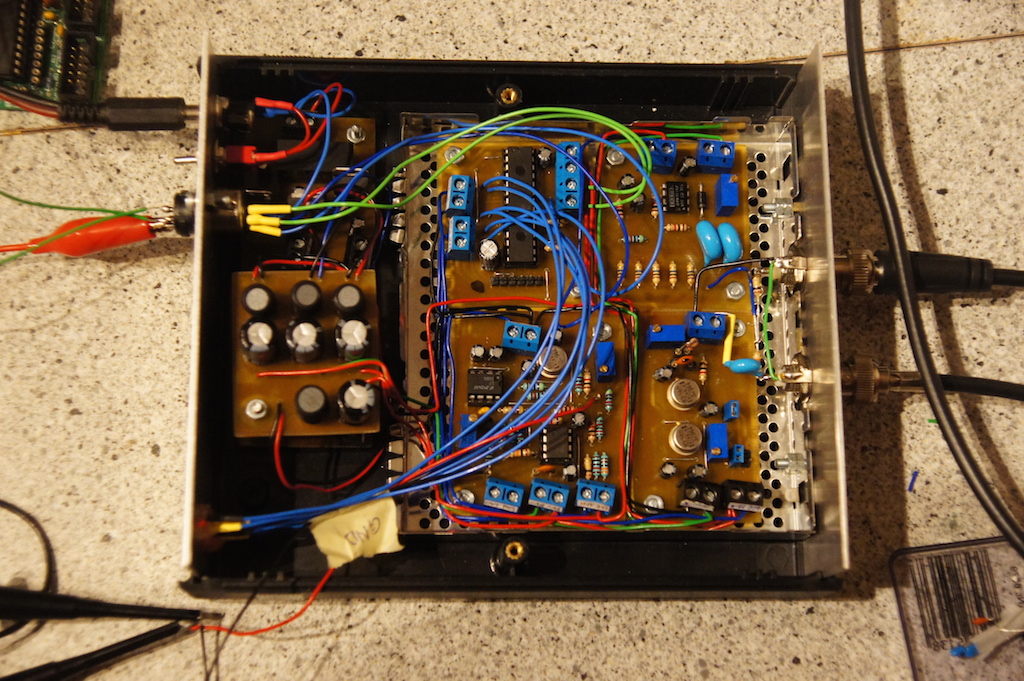

PCBs
This is how it looks inside with the shielding removed, all PCBs were etched at home.
These are the schematics of the 4 main boards (the ones inside the old TV-tuner box):
Preamp.pdf

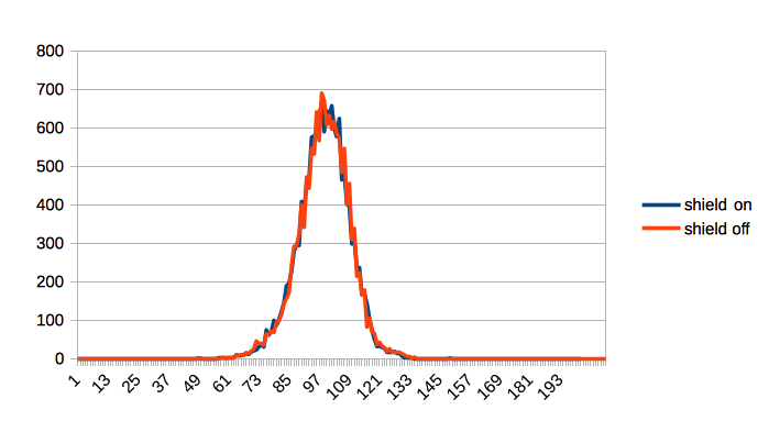

For a test, I fed pulses of well-defined height into the device using an arb-function generator. This is how the "spectrum" looks like:
"spectrum"
Looks pretty gaussian to me, the total width of the peak corresponds to about 40mV "noise" on the A/D input. (This is one of the things I don't know yet -- is it "real" noise from outside, or is it just the S/H circuit jitter?)

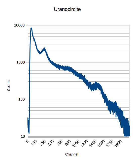

A "real" spectrum looks more like this (sample was a small piece of Uranocircite, reads about 0.8uSv/h on my pocket geiger):
uranocircite spectrum
Of course, this is nowhere near being perfect; but I think it's a start and good for some measurements -- if I can get neutron discrimination right with the energy resolution of the crystal, it's served it's purpose.

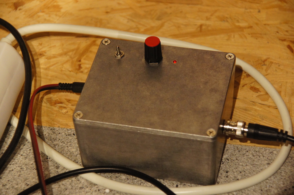

Since the output voltage of my HV-supply has about 1V of AC left at full snot (1500V), I added the stripper circuit to get the ripple down to the ~10mV range, where it does no harm.
And yes: my supply also has a very strong tendency to radiate noise all over the place, so it too has a nice metal box all of its own:
high voltage supply
I went down the CCFL path, too, for a while; but before I got the chance to get a commercial one, I guess I just wanted to try doing it myself once. (Actually this is the second transformer already, I fried the first one when I tried to determine its max. output voltage.) But it's certainly the most economic way of doing a HV supply quickly and efficiently.

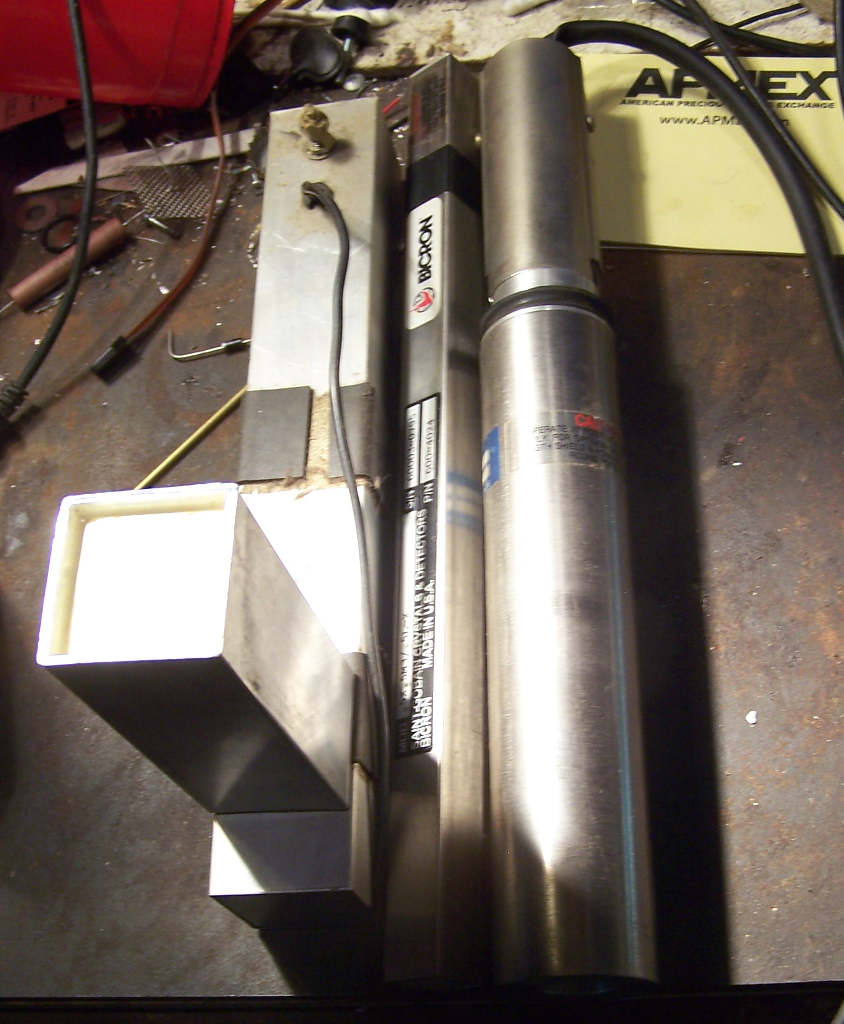

Edit: here's a pic of some NaI:Tl heads and a crystal I cut off one that had a bad phototube.
What I have spare here.
