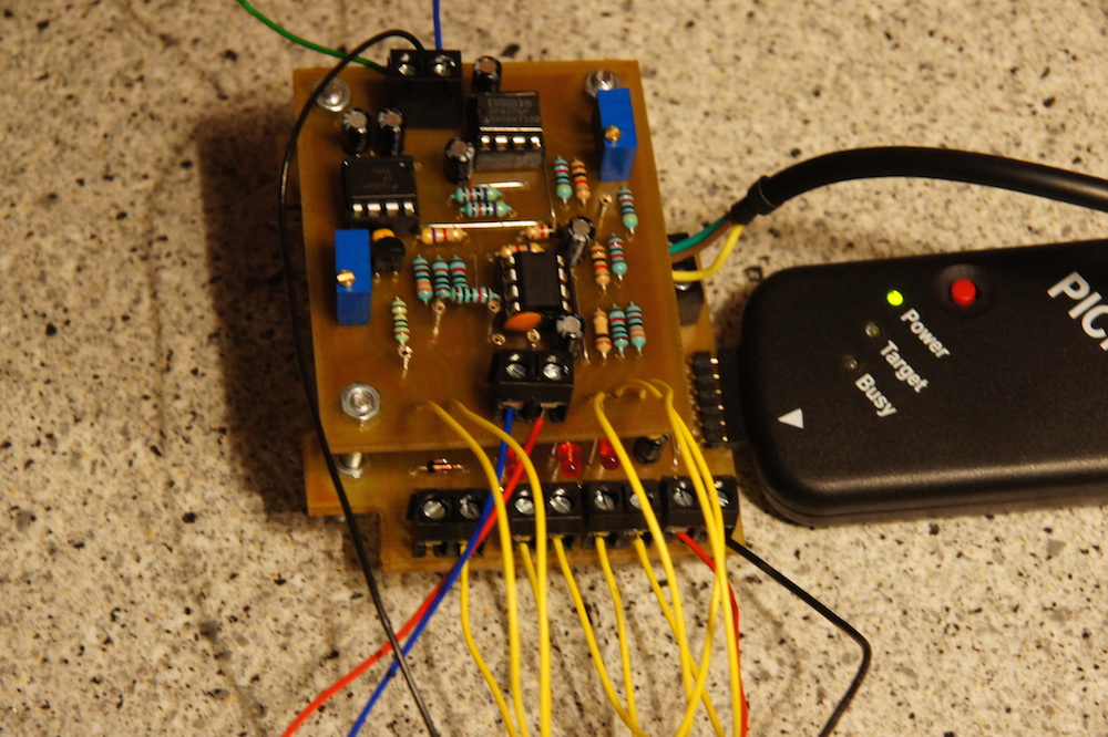

Okay Doug - here's what I've got so far in terms of MCA:
logic on bottom board, analog circuit on top
The two boards are currently mounted back-to-back using threaded rods - those are metric, M3. I can send you some M3 nuts, if you don't have them / can't get them easily in the US. I left the connecting yellow wires long enough so that you can also mount the boards side by side and still have flexibility - you can always make them shorter, anyway.
The rear cable carries the serial signal, which is also available on a screwclamp. The pinheads on the right connect to the ICSP dongle for PIC software download.
The very left connector on the front side (i.e. facing the camera) is a "pulse-out" signal, for each pulse detected and counted, a 3.3V square impulse is generated. Intended for fast and easy "cpm" measurement, just connect it to a counter.
The rear connector on the top board is signal in from the preamp. As for supply voltage: required is 3.3V for the logic part and +/- 12V for the analog circuit.

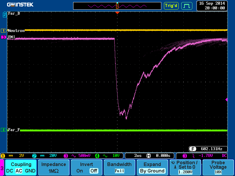

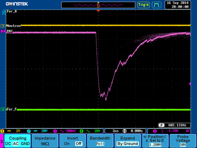

Here's the input signal waveform that I tested the circuit with (fast rising exponential followed by slow falling exponential):
input signal and output of peak detector (10us/div)

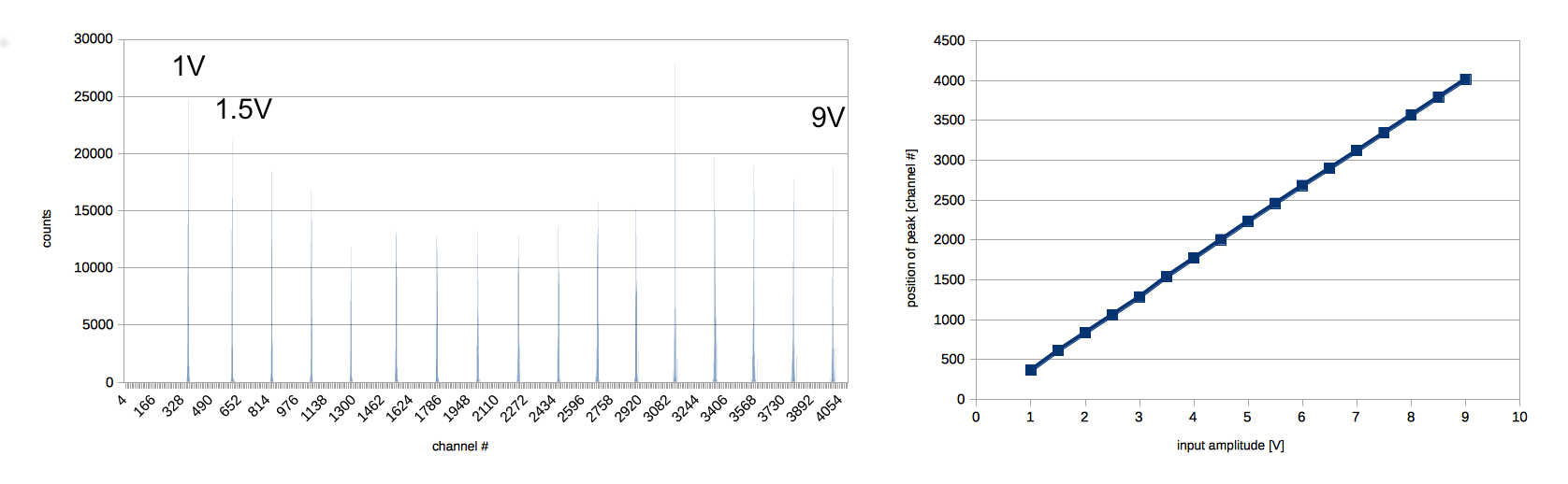

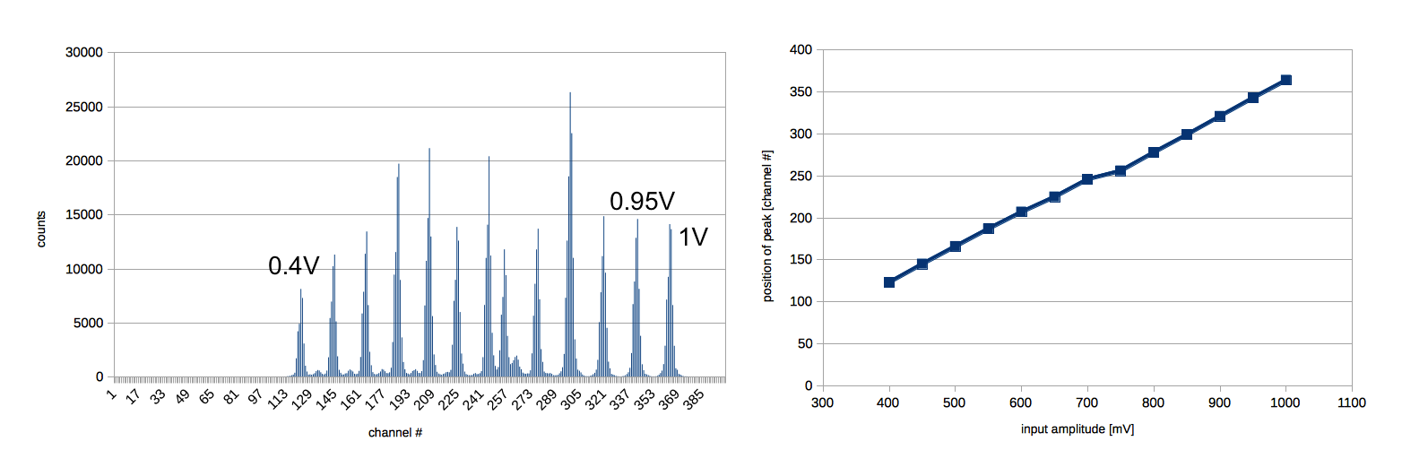

Here are some results (I just manually swept through some discrete voltage levels, so no precise timing and hence different peak heights in the spectrum):
entire 12 bit spectrum with peaks of various amplitudes

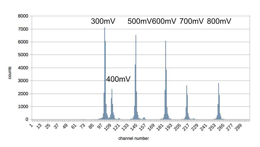

Below 1V, however, things start to get a little nonlinear. Peaks below 300mV are not detected or smeared out to the left of the spectrum.

Looks pretty good except for the bottom end, yeah. I see both stretching and compression down there. In theory, if it's repeatable, we could fix it in the PC later, though - it's a better place to do any heavy-lifting type math. I noticed issues even on the big-guy expensive stuff, actually. It's not like all the available detectors are perfectly linear across the entire range, or that you need 4k for anything but maybe HPGE - NaI has fairly broad lines by comparison, and 1k gets a little more than it really has anyway. Usually I wound up using a small crystal for the low end of energies, and another big one for the high end, at any rate - with appropriate gain changes so each one's max output was full scale for the converter - then do the math later to make them into real numbers. The big ones don't work too well in the few kv range for whatever reason, and the little guys excel there, but stink at high energies where more often than not, the photon just compton scatters out anyway.

The signal you show is a good bit slower than what comes out of an NaI (usually 5-6 uS total, <1 us rise), and tons slower than plastic scintillators (not that it matters for those, they have horrible energy resolution anyway). Looks about like ZnS speeds (slowest there is in common use). I'll post some real signal captures up here from some of my detectors at some point - right now I'm doing another project. I need to haul out all those NaI heads I have and a HV supply and check them all anyway.

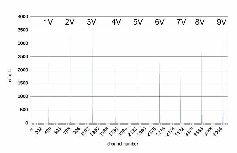

After this, I did another sweep of input amplitudes, here's the results (resulting spectrum to the left, pulse amplitude vs. channel to the right):
sweep from 1V up to 9V in 0.5V steps
sweep from 400mV to 1V in 50mV steps

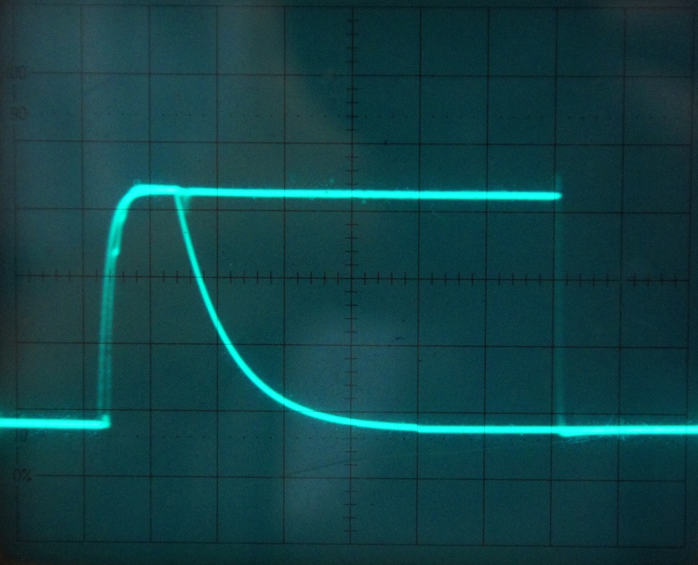

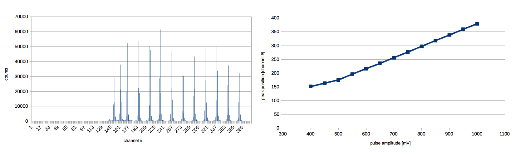

As for bipolar pulses: here's the same low-voltage (i.e. from 400mV to 1000mV in 50mV steps) sweep with a crude bipolar-pulse (1 period of a sine wave) and the result looks even better (beside some flattening at the very bottom of amplitudes):
sweep with bipolar signal

Yes, 100% of the MCA's we've used - along with 100% of the detector heads we've used, use negative going pulses. Canberra included, (and all the way back to the nim bin days with Ortec and LeCroy), as well as the one we borrowed from USRA here: viewtopic.php?f=11&t=337&p=1965 Paul thought 8uS shaping was much to severe, but that's the fastest that worked best with most of our heads in real life. He suggested 2uS.
We often used 16+ uS with our detectors.
In the nim bin days, there was usually a separate "shaping" amplifier that had the option of swapping polarity. In the new days it's universally built in along with the shaping. The fact of a uP a/d only taking positive input is a very new thing in this game, and it's considered to be "your problem" as far as the chip manufacturers are concerned. You might also have noticed that the days of 3 output power supplies for gadgets have been over for decades, and rail to rail opamps have been "the thing" for quite some time now, even at 3.3v. Having lived through the entire period, it's been a long strange trip. I personally still prefer 5v logic for things when I can have it, since it's easier to drive things like low threshold fets fully on with it...Both my data aq box designs (documented on this board) use 5v, since it's also usually a bit more robust in terms of input overloads (fatter diodes protecting the chip substrate). And of course, with larger a/d scale, reduced noise issues.
Note that since most of these sensors are capacitor or transformer coupled, it doesn't usually matter where the pulse goes negative from - could be the supply rail, but back in the day it was always chassis ground. The implied high pass was usually called "clipping" in the older literature, an unfortunate overload of the word.
It makes big trouble at really high count rates, as the coupling capacitor may not have recovered by the time the next pulse comes around. But it made things easier for the physicists who now could connect with a 2- wire cable (BNC or an HV version of that) instead of having to understand how things worked inside or have two separate cables.
It's always an option. Fortunately, it's really easy to have a high slew rate inverter with most opamps (easier than non-inverting gain if you look at the step input functions in the old application books).

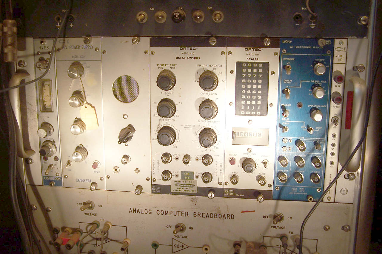

What it used to look like...

You're probably correct about physicists not having EE experience. It's one of the reasons I like having some background in EE, too -- the two fields just belong together (as least from the physicist's point of view).
Your NIM-bin setup looks nice! I've always liked to have as many knobs, meters and LEDs as possible...
I also like the analog computer below -- I've only read about them, but never actually seen one (although if I interpret the text correctly, yours is breadboard to test some functions before they're wired into the real computer?).

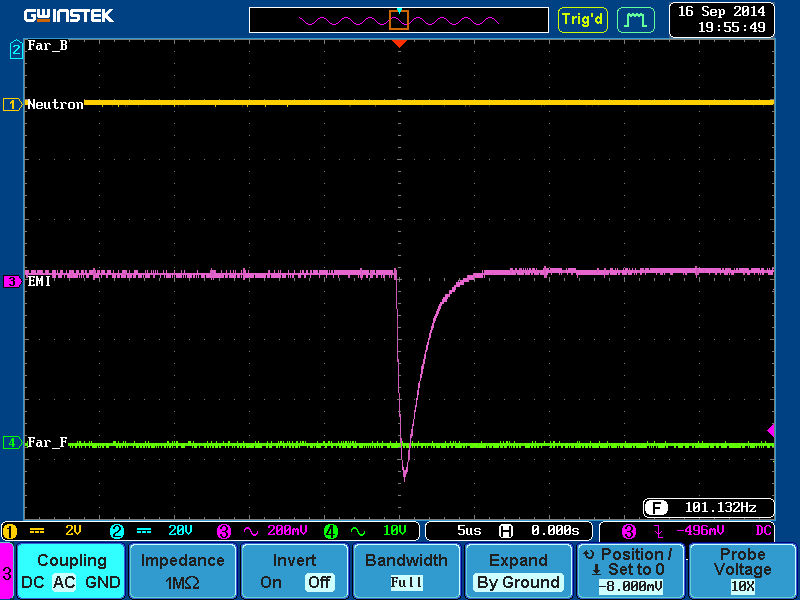

Here's a typical signal from a couple of NaI's I plan to send on to Phillip for his testing. These are 2 wire, and I used in the neighborhood of 820v with a 10k load driving the 1' provided (hardwired at the sensor end) cable and a .01 uf coupling cap to the ten meg scope probe to capture these.
From the .5" crystal bicron Cs 137 662 kev line
From the 1x1" by 4" deep bicron, looks like we caught a double here. (pileup)
