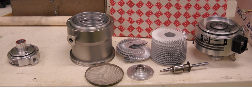

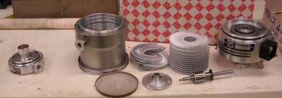

opps
A leybold TMP50 middle bit far left. The rest a leybold TMP150C
