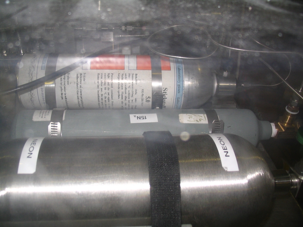

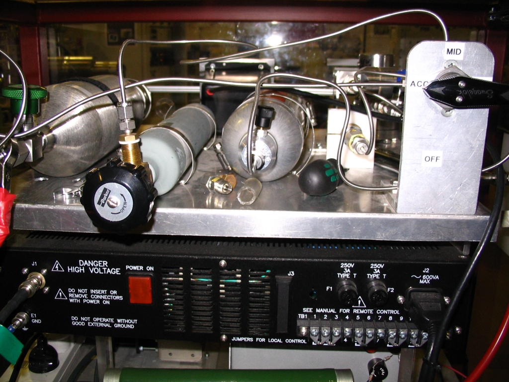

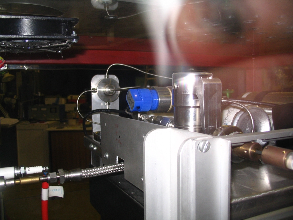

Postby johnf » Mon May 16, 2011 5:08 pm
Since pis are worth a thousand words
this is how we do it all swagelock product
gas bottles to gas selector switch then on to pressure reduction reg then leak valve then through braided bellows to ion source
