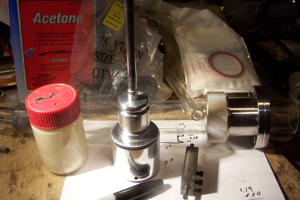

Pieces before adodizing the metal. Haven't cut the quartz inserts yet, the outer tube is Pyrex for the nice automatic voltage gradient you get due to its mild conductivity.
Nicely polished with the big coupler. You can also see the lathe tool I made to cut O ring grooves. Just a chunk of A2 drill rod ground up with a support for my tool holder. I run this slowly and delicately of course, and have to resharpen it after every job, but since I don't have to do this much, that's no big deal. Also shown in the little jar is "Doug's magic vacuum lube" which is about 85% beeswax mixed with a little Diffoil-20 to make it spreadable at room or warm temps. You can't put this together without this. After it's heated a few times, it all disappears out of the system according to the mass spectrometer.

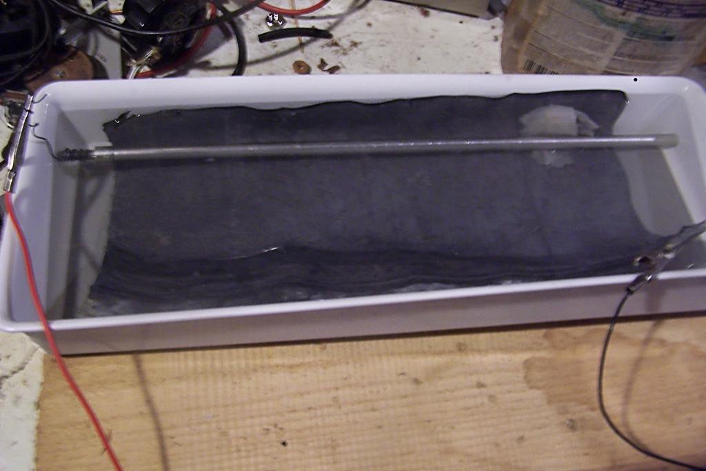

I've found through experience that Al makes about the best conductor. It's good and heat conductive (well...long and skinny it's not perfect like a heat pipe, and we might go there later) but the real deal is - after anodizing it, it just doesn't arc or draw current in the exposed plasma anywhere like copper does. My longest lived example of this (still living) has a zillion hours on it and little to no sputtering to the insulators, it just works. I've even heated the end of that one to very close to the melting point of Al, and it didn't even sieze threads on the grid that was on it, or show any damage. Aluminum oxide, the eventual result of anodizing and sealing, is impervious to reduction by hot hydrogen, and somewhat self-healing it seems. Just an FYI - for whatever reason, this works better than all other things tried, and there have been a few.
Anodizing need not be hard. I use one part battery acid (H2SO4) to 3 parts water (distilled) for the solution. Do a little work on a junk piece, as the solution works better once "aged" with a little aluminum sulfate in it. You can use Al flashing for the cathode, or lead as I show here, and I use roughly 7 amps per sq foot. If you do this with a constant current capable supply, you go for peak anodic resistance - the voltage rises, then drops - you stop right then to get the maximum thickness. This proceedure is somewhat complicated by the fact that as the solution heats up - it has a huge tempco and will make the voltage start to drop before you get there...try 45-60 minutes for ideal results, then seal by dropping the piece in already-boiling (de-oxygenated thereby) water for half an hour to seal the anodizing (close up all the honeycomb pores).
I did this with all the metal pieces after polishing them to mirror smoothness. Anodizing makes the surface look hazy, but...it's worth it. It still seals to O rings fine.
I just used a tilted tray to avoid having to mix up too much electrolyte, and a piece of lead foil as the cathode. If you use Al for the cathode, you have to remove it when not in use - it will dissolve over time.

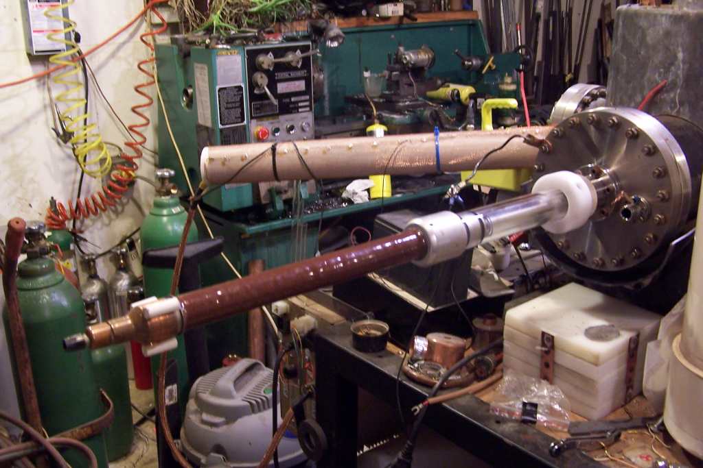

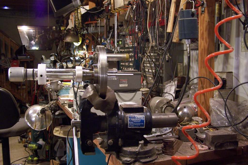

Here is a mockup without the telescoping quartz inner insulating tubing. This shows the big Lesker tubing coupler, the metal pieces and the custom plastic clamp I made to prevent the thing from creeping into the vacuum tank - it's a problem even with 3/4 and 1" ones, so I assume this is going to be even worse. I didn't have PVC of the right size (at least not without a change of lathe chuck to chuck the too-large stuff I have) to do this, which is what I prefer. Instead, I cut out a round from HDPE with a hole saw, turned it to exact OD and bored it to exact ID dimensions, then added 3 setscrews with inner tube rubber on the glass side so the screws wouldn't shatter the glass with point-force. This is because, hey, HDPE is slippery - the opposite of what's wanted. At least it's a great electrical insulator. This piece also serves to block airflow from that end of the 3" ID PVC clear pipe we got to help insulate this whole mess, so the air I inject into there with a regenerative blower will flow out, along the Al end, along the ballast resistor, and out the back efficiently.
Mockup without the quartz in there
I decided to use quartz as inner insulator. For a lot of reasons. Pyrex is ideal for the outer part as you can get it in inch sizes (quartz is all mm) that fit, and its slight conductivity has the same effect as corona rings/resistors in equalizing the voltage drop along it - but without all that big junk and wasted heat. But pyrex has a high D (around 8) and is not ideal as an insulator. So quartz, with a lower D, higher Q, and better standoff volts/inch is the bulk of the insulation.

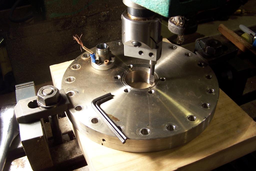

One of those days. So, I assemble the thing, all super cleaned, then find out it won't quite fit through the hole in the flange - it looked like it would, but the hole was .05" too small, Sigh. So...the mill and boring bar just paid for themselves in one operation (guess how much that fancy adapter flange costs?). A picture is worth...
Only had to re-grind the cutter 3 times, this stuff is tough.
Of course, it cut a slightly tapered hole, so I still had to dremel it some. Then the 1.5 rated ID gasket wasn't either, and there was enough slop so that even after I diddled it a bit (sanding wheel in the dremel), I had to assemble in the old Volkswagen fashion - start everything before tightening anything. But I finally made it fit, while just leaving enough knife edge on the flange to seal (I hope, we've not tested in vacuum yet).
It fits now. Barely, and since neither the hole or the pyrex are perfectly round...only rotates a little.

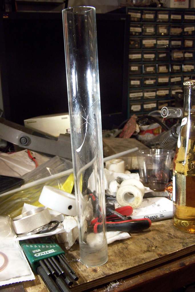

So, I think I'm getting there. Then oops - the finest chinese rubber innertube material proved not to be proof against a bit of pressure, and the setscrew jumped right through it and broke the glass.
Don't get crazy on the torque...
So, I doubled up on the rubber, and ground the ends of the setscrews flat - they had that cone shape on the end that concentrates force too much for this. Nice to have that little punch and die set - makes punching out rubber washers a piece of cake, perfect every time (but not better than the source material).

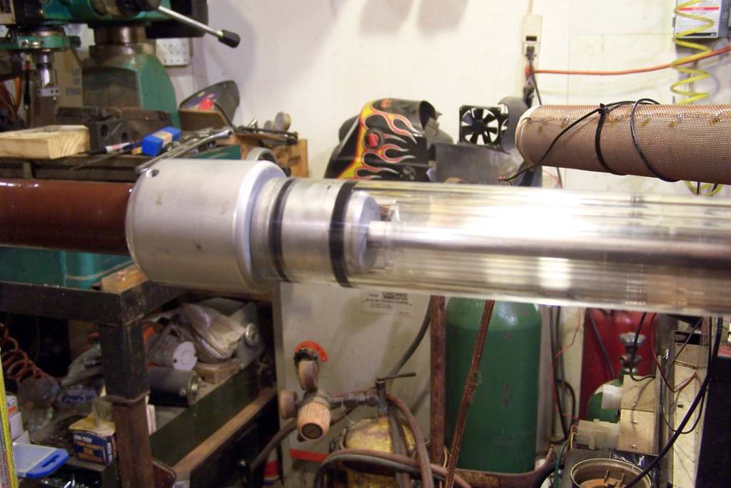

So, I cut a new piece of glass, chamfer one end inside (can't start the O rings without that), flame polish it, and made it about an inch longer - the inner rod was on the long side anyway - so it was cut that, or lengthen this. Note in the pic here - the inner O ring is really crushed in there - big contact patch. The back one is just to keep things located and kind of straight - not for sealing, though it probably would.
O-ring detail
Note the cool attachment scheme for the 50k 225 watt cartridge resistor I use for ballast - fits right into the end of the aluminum, held by setscrews, no sharp edges to start streamers from. Or so I hope.

Nice new inner insulator - held to the flange by setscrews so the rest doesn't have to hold its weight.

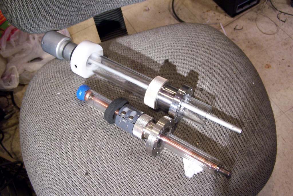

Just to show how much of an improvement I expect here, here are the old and new side by side - I should be able to handle a lot more kV with this new one. Hope I don't melt the inner rod, but if I do, we'll make a composite with just the exposed end anodized AL, and the long part out of heat pipe to keep it cooler. It's a bit long and skinny as is.
Side by side - new lamps for old.

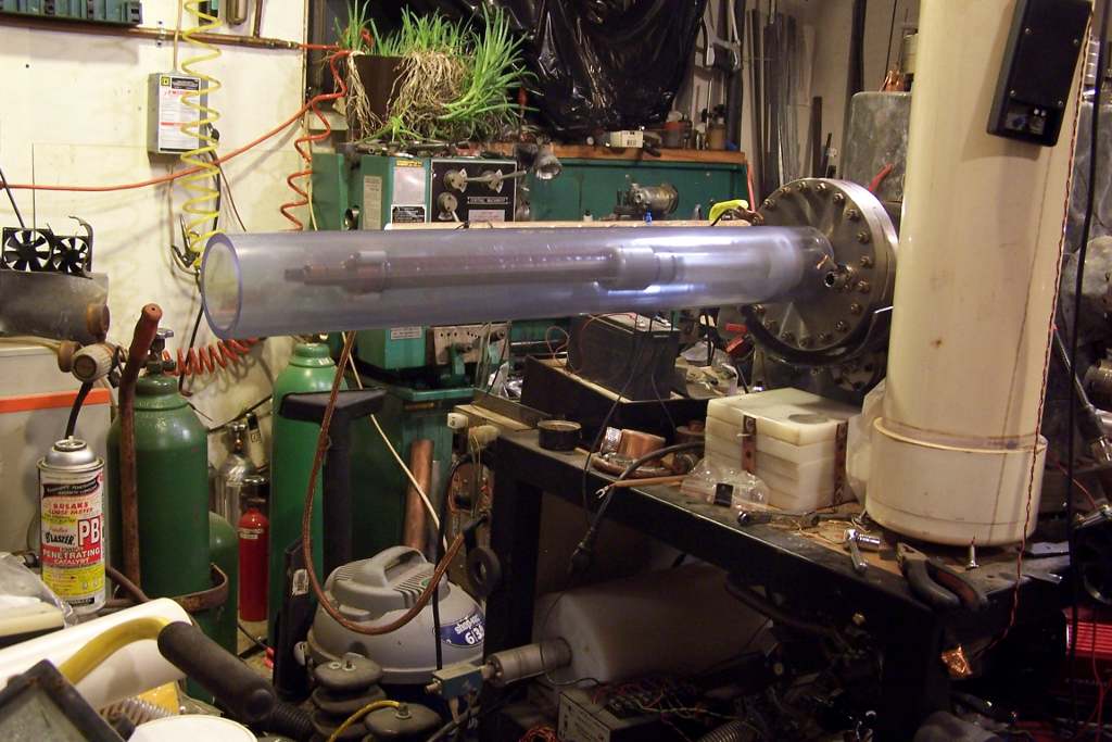

Well, as we often find in this empirical world, things don't always work out as planned, and this had a fairly major "duh" associated with it. When you try to stack a bunch of fairly loose fitting insulators in a vaccum (D=1.0) made of quartz with a higher D, all the voltage just appears between the "insulators" since it takes less energy to charge a D=1 gap than a thin quartz layer - then it arcs through the quartz. Sigh.

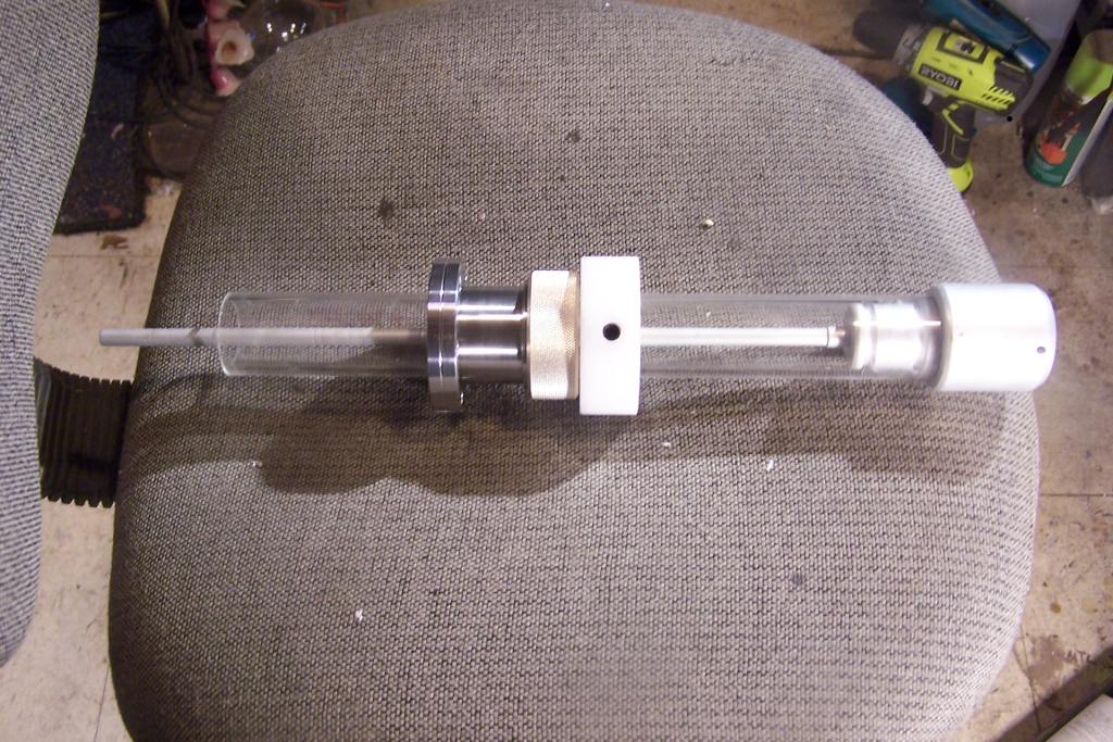

So, what we did was buy, at some financial risk, a piece of boron nitride rod, 1' by 1" diameter, to replace the quartz inside. The outer glass had already taken some damage in just a couple of runs and had to be cut off about half an inch and re polished as well. This looks as though it's the right move, but as usual there's a but.
The but is that the BN doesn't fill the glass either - I wanted to try this material for hot D resistance, but the right size would have cost double and had to be turned to fit inside the glass tightly. And, as it turns out, I got the "wrong" grade, or so we think now - the right grade and the right size costs even more (over $1k) - but it looks like the answer. As I broke the good Ti/W grid taking this apart, for these tests I reused our carbon ended grid. Turns out that the water coming off the hygroscopic BN grade we got (and who knows what else - binder and BN dust perhaps?) is a BIG problem. We're not sure if the double expensive next grade up (calcium borate binder vs boron oxide) will do it - and we know we cannot afford the super grade (no binder at all) rods, nor would we be able to machine those - some of the BN is converted to cubic BN in the process of making the super grade, and that's harder than diamond...no way I can turn and bore that.
Anyway, in the interest of being informative, here's some movies of it running as is, showing some problems. Whatever it is the BN exhales on heating - it makes the grid base spark. No sparks to the glass (for once, and finally, that problem looks like it's solved with the BN sticking out about an inch past the glass), but those sparks short the supply out, and make other troubles - water, BN, binder etc pollute the deuterium, and the shorts are, well, shorts, which kinda puts a lot of stress on things.
Like Edison said - we now know one more thing that doesn't really work. However, this is quite promising - looks like now the FT itself can live "forever" compared to all previous attempts for one thing, and that's MAJOR - it's been a problem the entire project. Also, for whatever reason, we broke 1m neuts/second with only 35kv in - a record for us, though we can usually run 53kv and get over 2m/sec, we've never hit a million at such a low voltage (disregarding that there might be some kickback effects in the ballast we are not able to measure that might produce temporary high voltages).

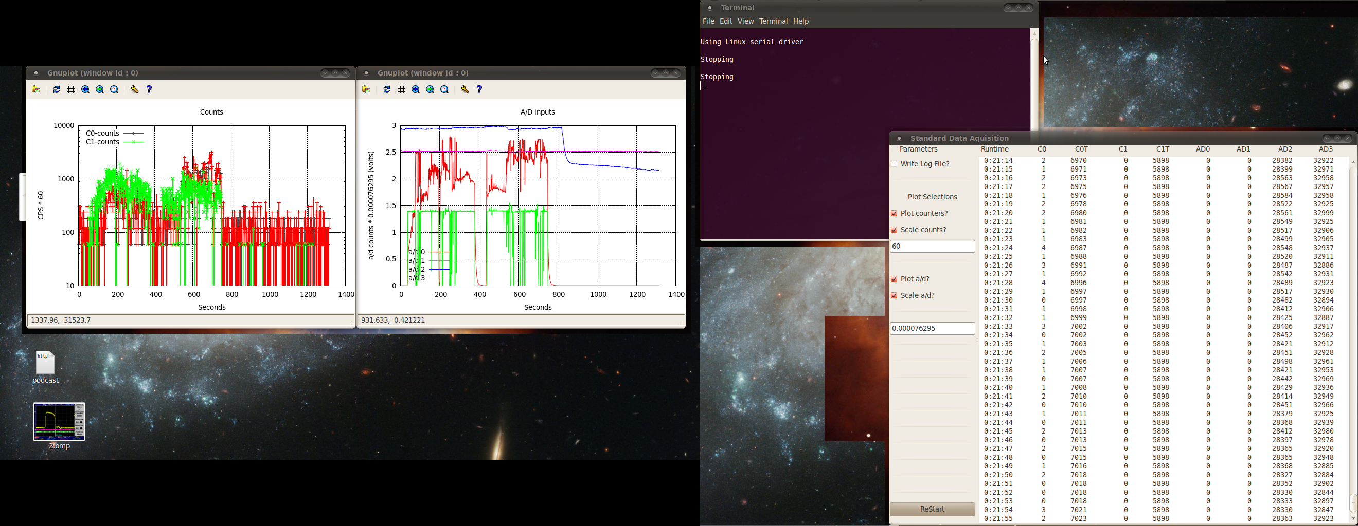

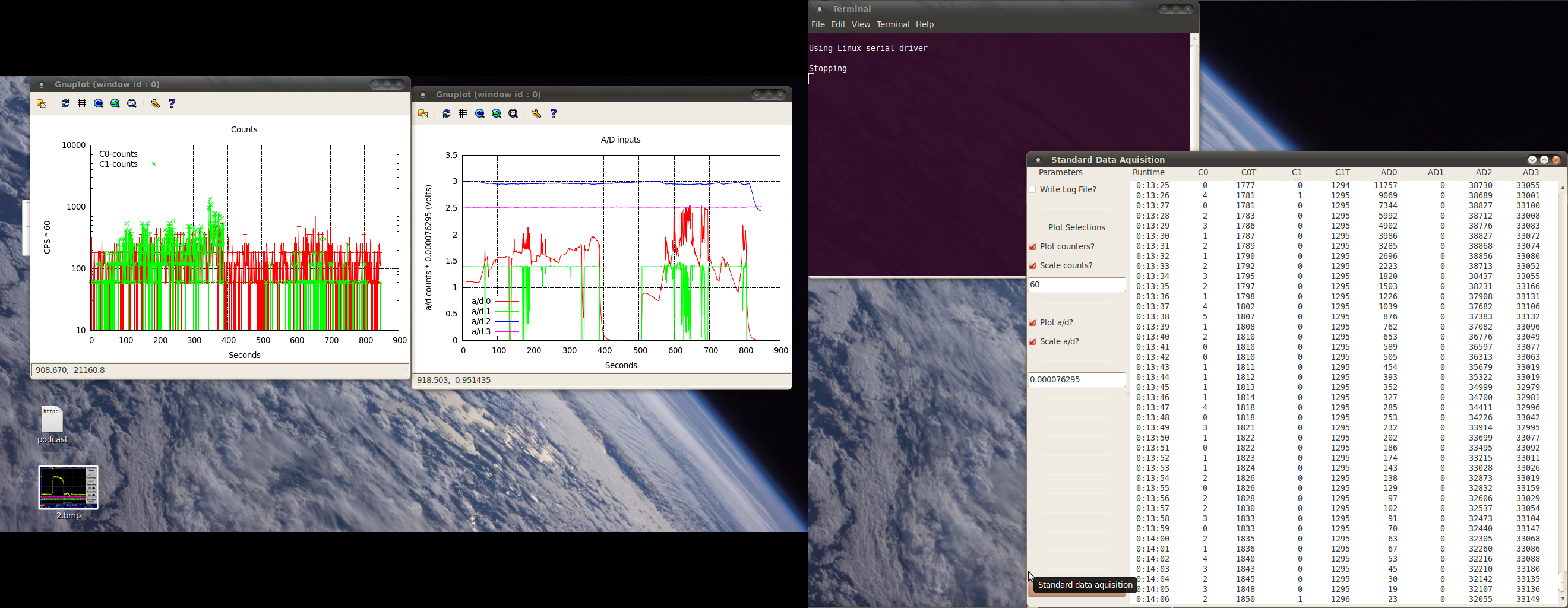

Of course, I was running data aq for these runs. Here's a couple screenshots - I didn't bother taking a log file since, well, things are a bit messed up as of now and these aren't record runs - except that at fairly low voltage inputs we've broken 1 m neuts/sec a couple of times - at under 35kv input(!). Interesting. Note these aren't calibrated, they're the raw a/d and counter outputs, but I know what the voltages etc were as I was watching the meters on the supply. I had it running 20ma on peaks, which is on the high side (even for best Q, normally) but the point here was to heat things up for better bakeout and better performance later on.
First run (corresponds to first movie above)
Second run during which I took the pic of the long arc
