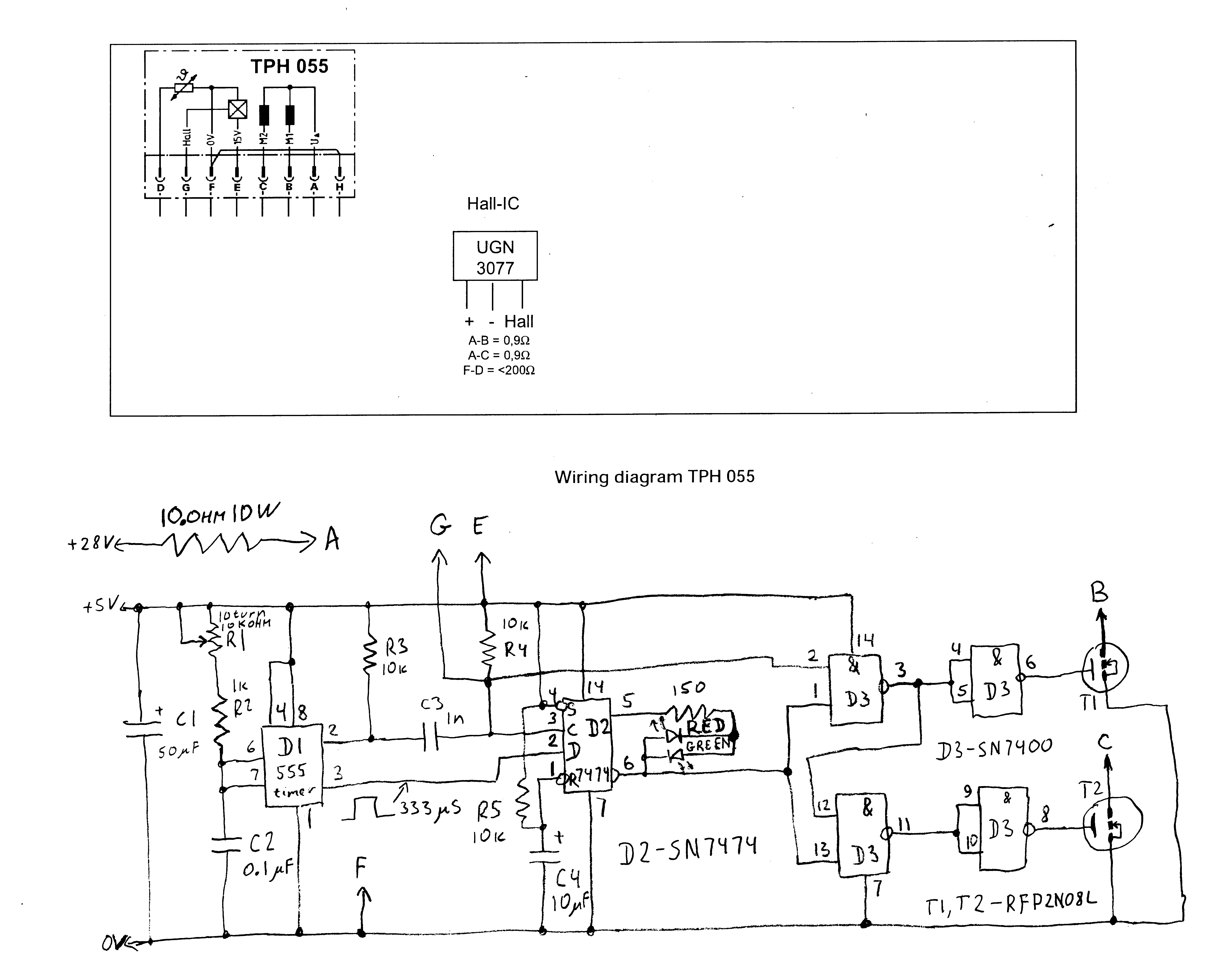

Here is a thread on fusor.net that shows a two phase controller for turbo pumps -- looks like Jerry was right about those.

Alex has kindly allowed us to use a picture of his 2 phase turbo driver here, so it's all in one place. Looks like Jerry was right -- if he wasn't this wouldn't work.
Alex's 2 phase turbo driver for TPU-55 class pumps.

I printed out the schematic and I think I have everything figured out.
I was looking at a couple other designs. Is the rotor in the pump a permanent magnet or more like a regular induction motor?
