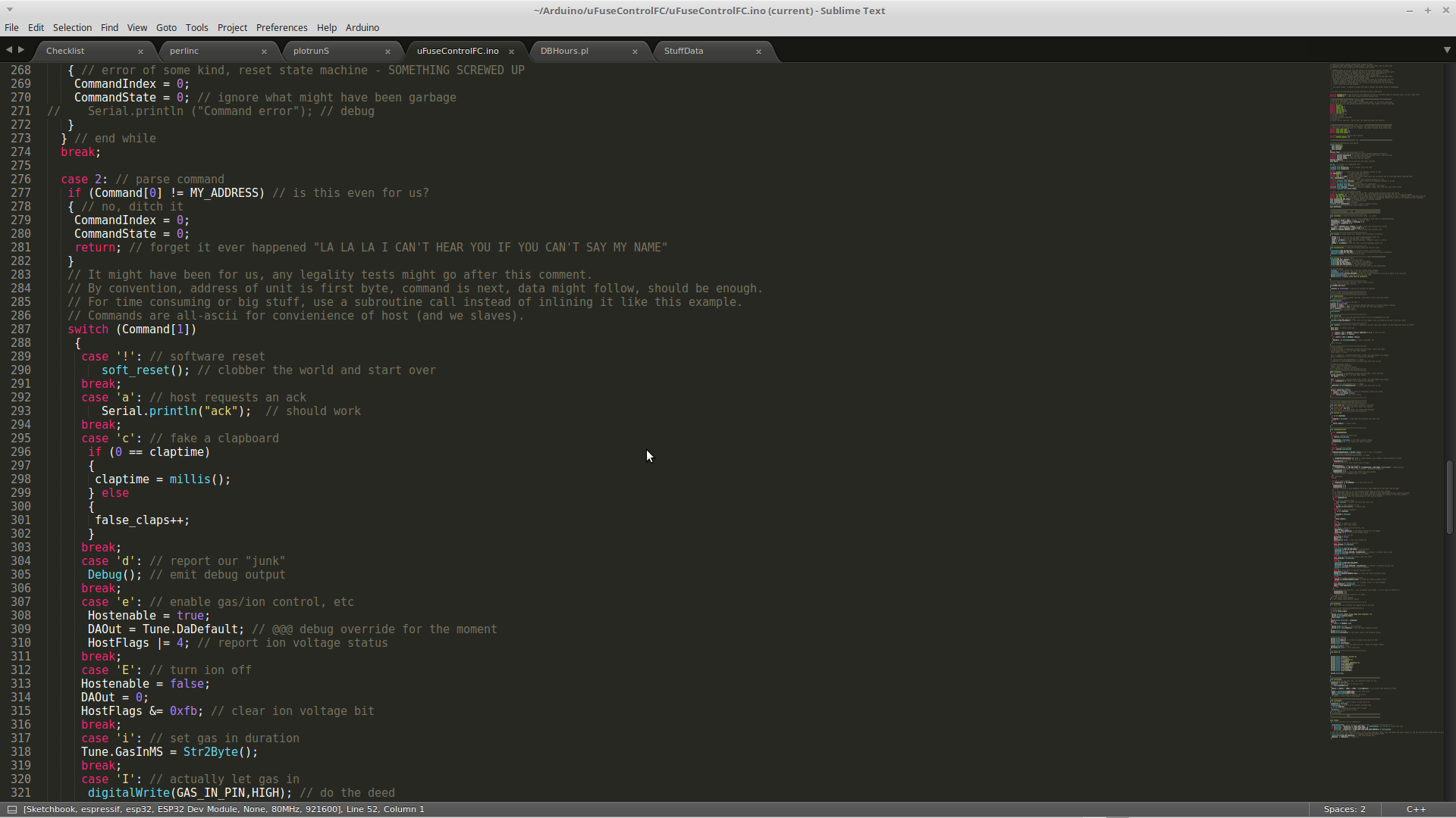

Here's another one I like. I've recently converted to "Sublime Text" as my go to editor for lots of things - it's just really good for software dev in general. Well, guess what - the arduino IDE lets you use a "real" editor, the original IDE only being used for build and upload (there's probably a way to do that in sublime text too, since it supports build scripts and so forth).
So, this avoids the many limitations of the arduino IDE as a software editor...quite nicely. Here's the link that got me started: http://mercedescoyle.com/2013/11/13/ard ... -ides.html
Looks like this (lots of themes to your taste, this thing can syntax highlight just about any language - even perl).
Sublime Text as editor for arduino
So I can now have all the files for a project(s) open in Sublime, and do as I will. A lot of times I'm doing master-slave kinds of things - say a control gui on a pi in perl, that talks to an arduino - and this makes it easier by far to keep track of it all. In fact, the open file here is the fusor ion/gas control arduino sketch to which I'm about to add control for the main power current limit...
