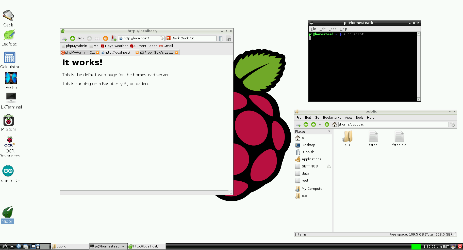

Bonus - here's a screenshot of my pi (using scrot which I had to add there, as it's not builtin)
Pi. after all this.
I've added mySQL, apache, scrot, samba, gedit, padre, the arduino IDE and you-name it already. The pi SD would have been enough for all that - there was over 2 gb left; I'd already removed all the "kid stuff" like the python games, scratch, and anything else not "real". Sorry python fans, my visceral reaction to that language is puke, and I can't paste an entire program into my one line edit boxes like I can with perl, since it's so stupid it uses whitespace and indentation for what real syntax is used for in every real language - and it's slow on top. Screw python. You have to keep the language itself, since that's what the interns who write most of the linux sys scripts use, but you don't have to make it worse by using it yourself. It was more the fact that I knew I'd be using tons of space for file serving and data logging, as well as the known lack of reliability of SD cards, that prompted this rather arduous job - remember, I'm not saying all the things I tried that DID NOT WORK, just what did.
