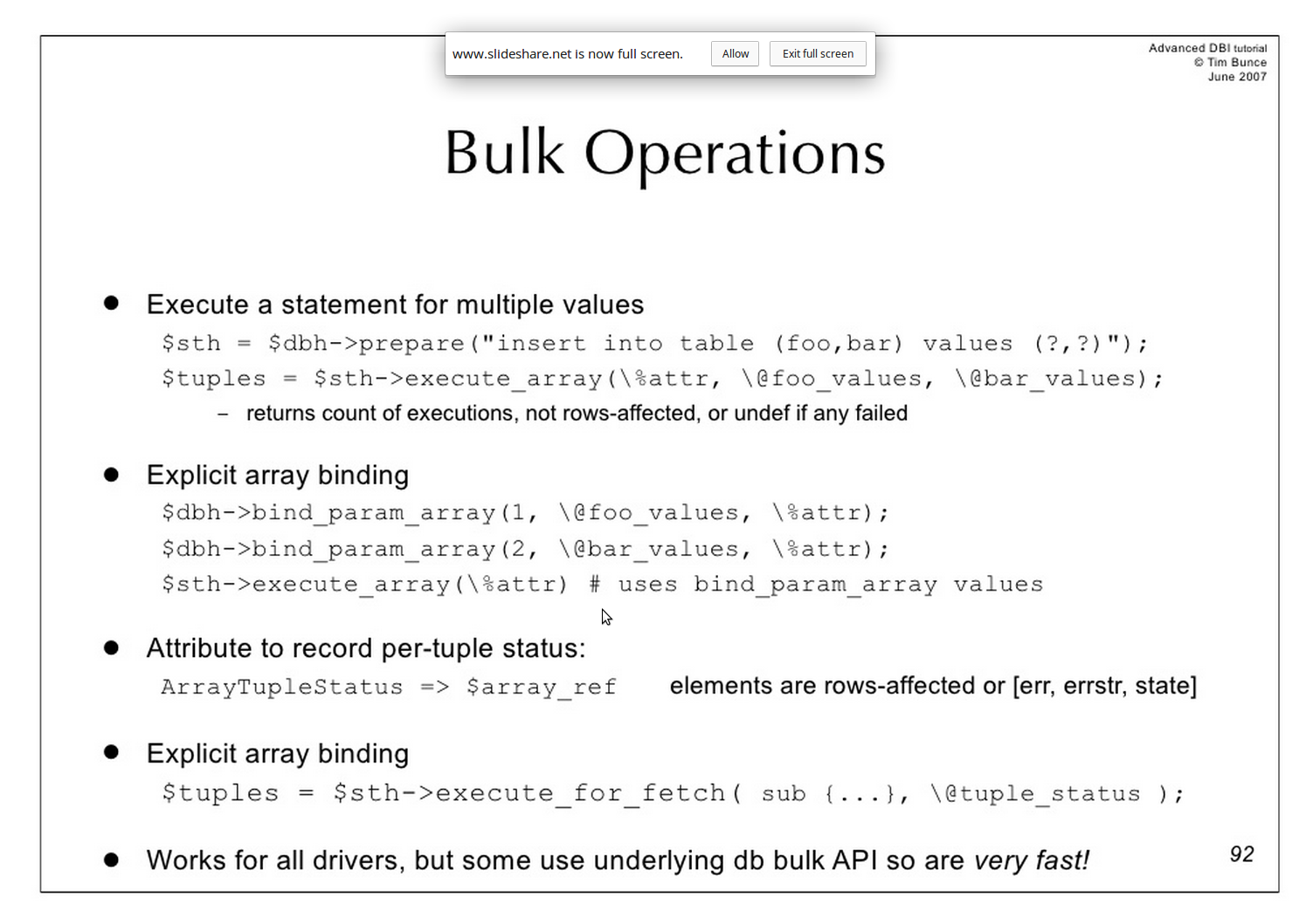

Here's a slide from a presentation I'm going to have to find the link to the rest of.
Bulk SQL for speed
And I got lucky and found the link: http://www.slideshare.net/Tim.Bunce/dbi ... orial-2007
