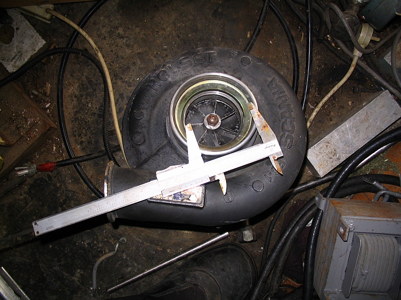

Postby johnf » Mon Mar 14, 2011 3:16 am
Heh
Heh
young son turned up with this in the weekend
input diameter 2.7 inches
and another on the way
both going units --they get replaced at 200,000kms --go figure
no end float and turns very nicely
