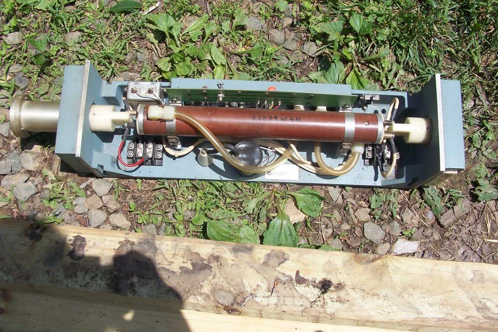

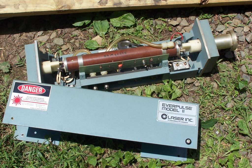

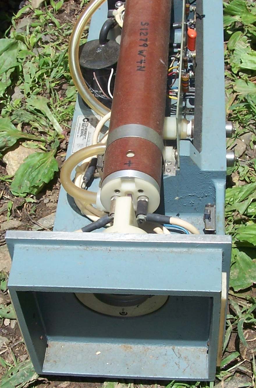

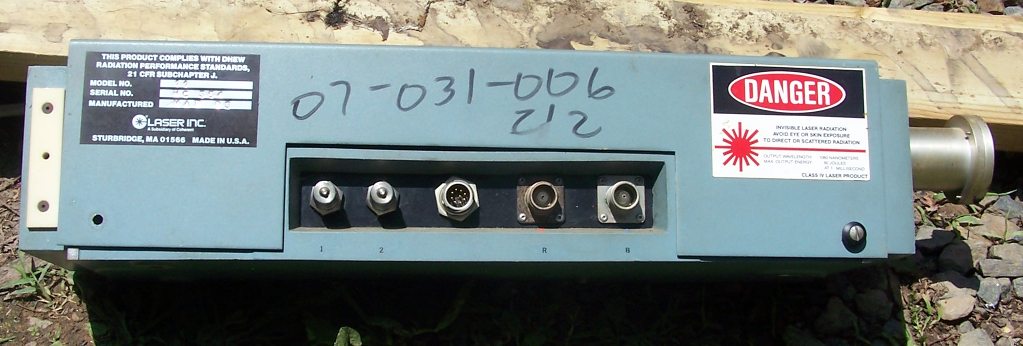

Anyway, here's the pix of the laser head I've got. I paid $1.5k for this, the caps, the big inductor (about 80 lbs of copper wire, air core). 1.5k joules in (at a guess from the cap rating), 60 out, at 1ms, it says. I've never fired it up, but Frank Sans says it works and will punch a hole in a quarter with one pulse. The rod appears to be about 1/8" by 3/4" or thereabouts, around 10" long or so. Light purple, you can shine a red laser pointer down the length of it.

Doug, that is a neat head. Dont think it will be of much use to me. Those lamps will take a lot more voltage than I can put out, I believe.

The capacitors were rated 1.5kv, but I believe that's so the inductor could more-easily stretch the pulse out - when a lamp fires, it's more or less a short circuit - about 10v drop. The head has a spark coil in it to trigger the lamps, which should work as low as a few hundred volts, but I've not tested that - this thing frankly scares me. I'm not even sure which end the beam is supposed to come out of - or whether it's just an amplifier for another, smaller laser.
