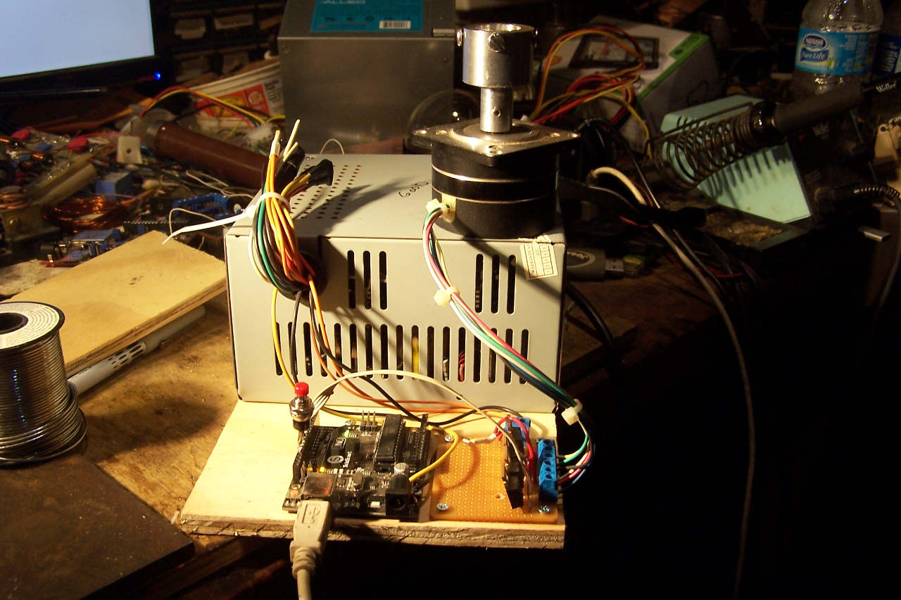

A little progress on this. After scrounging around, I didn't find a good power supply that would fit in one of my die-cast project boxes, not waste a ton of power/hear and so forth, but I did remember I have a ton of old AT and ATX power supplies, mostly good, from old computers or upgrades. Bingo, efficient switcher, and since the motor ran fine at around 1.8v (rated at 4v, the engineers must have been thinking darlington drive transistor and a 5v supply with losses), I figured the 3.3v output would do fine - the drop in the drive fets may as well be zero (look up specs on IRL 1104 - utter overkill but I had them in stock, so they're free).
Some folks may say this sloppy build - not even a box but a good ole board - shows lack of pride in workmanship. Some will say it's overkill. I suggest either one look at Pareto optimization and then get back to me. Or as Robert Heinlein said "too fussy wastes man-hours". I had all this stuff laying around. No, it's not optimal if one were going to build thousands, or if one wanted to program it for different angles at the job - I'll actually have to fire it up hooked to a computer and take, dunno, 30 seconds or so to change that. Whoop. de. do. Mounting, wiring up and writing code for an at least 2 digit thumbwheel switch would probably take longer than I will ever spend just changing the number in the code and re-uploading it.
Not done yet is extension cords for the motor windings and the pushbutton to make it move. I'll get that done tonight, and later, show the whole mess leaning on or laying on the lathe ways with the motor/jig in the chuck and the toolpost drill in action.
That is, when I have something to drill. Since we moved to 3/4" grid OD, I decided to quit wasting my 1" stock and just buy some 3/4 from McMaster, which will happen real soon now, since I've finally got enough other stuff I need from them to make shipping worth it. Early next week - they ship fast.
But here's what it looks like now. Just screwed to a board so it'll lay on the lathe ways, or lean on them.
Proto now tested. This motor is much stronger than I expected, and faster - but I slowed it down because it seems to look cooler that way.
The entire mess draws 12 watts from the wall, about 7 of which go into the motor, the rest is power supply "tare" and the arduino uno.
