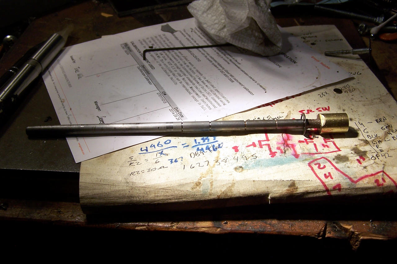

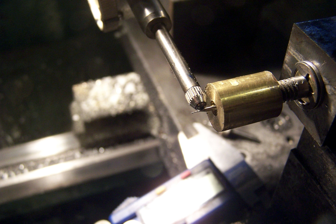

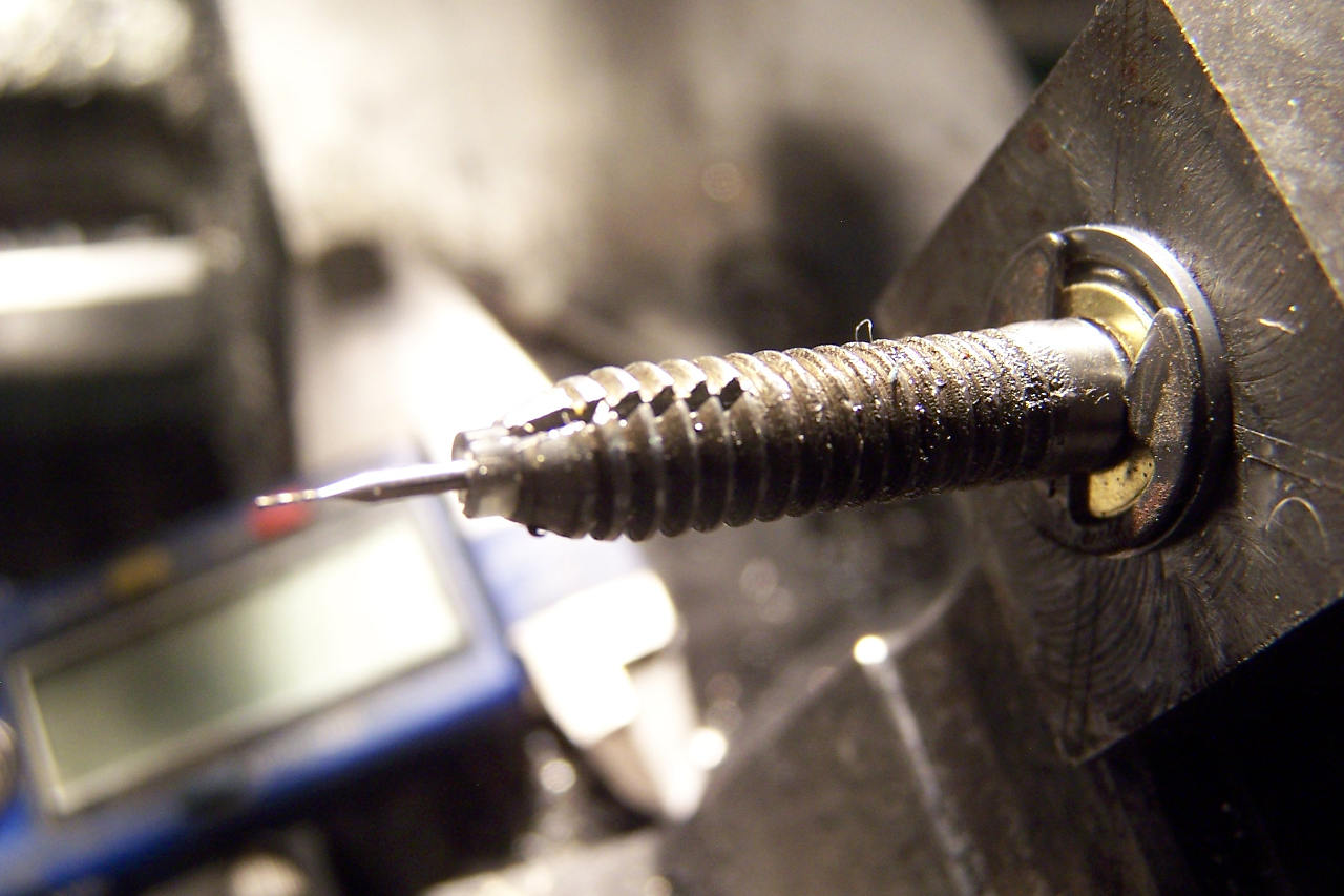

So, here's some pix at various stages of this. I didn't document the "simple" stuff any machinist (at all) should already know.
Here is is being indicated to I can make it truly straight.
This is with the tiny drill/adapter in it. My first coarser tests were with a simple broken carbide 1/8" shank bit.
The gory details. Man, even the dust is big at this scale!
And for completeness, the old shaft it replaced, which is stil alright for many uses, so I'm not tossing it out. There are some flaws. The nut got ground off a little by something and it's off balance. I cut multiple C clip slots as sometimes the 1" sq block this is mounted in gets in the way of the work - not often needed, but nice when you do. As a result, the last big error is that the thing is way too long, and anything out at the end past the drive pulley adds vibration. So, more flexible (literally too - it's 12l14, not harder steel) but not as accurate or reliable for grid making.
The old shaft. I'll keep it in the lathe tools box for backup.
