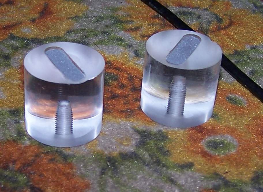

We have managed to acquire some Be here from sources such as you mention, in various form factors. Most useful to us so far has been some fairly thin foil, about 4 mils thick.
Though Be is about as brittle as it gets, with care you can cut this stuff with scissors without breaking it, and it's what we use for neutron generators, with the source from
a staticmaster brush. These don't last as long as you might like, but for sheer "loud" they are hard to beat when new. A staticmaster source has the radioactive part as a thin film over
an piece of Al, and is just stuck on there with double sided tape adhesive, so it's easy to remove and have intimate contact with the little piece of Be. Air space means any alphas are losing energy to the air fast, so
having them touching is a fairly big deal. The way we build ours, a normal geiger counter doesn't see any other form of radiation coming through, only neutron detectors show that it's anything but an
inert chunk of stuff, as the Be foil is a little larger than the source and shields all it's other output. These are not very loud neutron sources, but enough to put some bubbles into a BTI if
left there overnight. We can count them some on our 3He setup as well, even though we have that setup with a high threshold to make it "numb" enough for use with an audio amp at full fusor outputs.
Our first staticmaster-Be source was simply a Be foil placed over the source in an unmodified brush source, and held on with scotch tape so we could easily turn it on and off.

Here's a pic of some sources we made here for detector testing. They can be "turned off" by removing the Be foil. I just milled a channel into some plexiglass to protect the guts from human contact, and threaded the back end so we could mount them in jigs with reliable placing.
