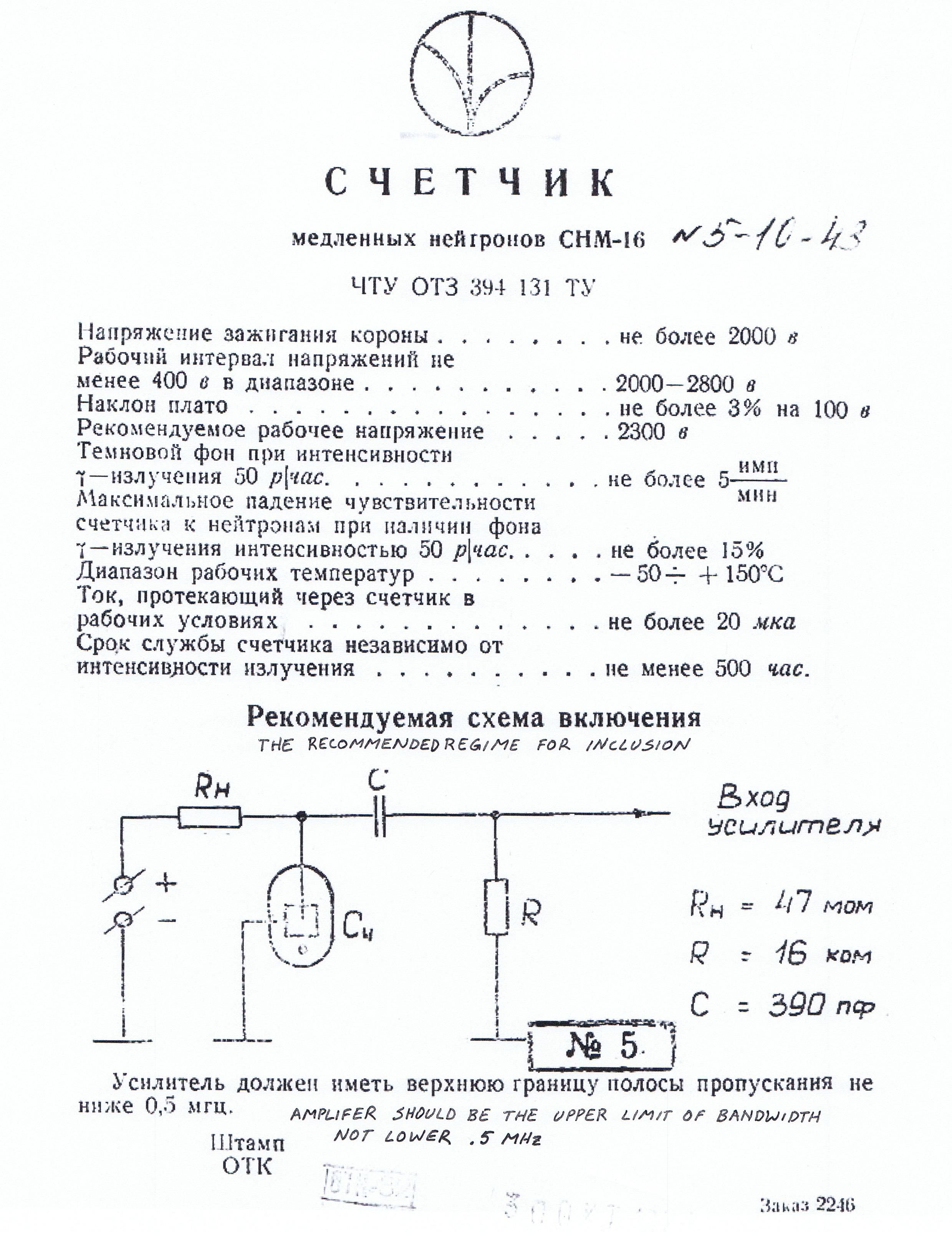

Doug, most of the stuff that I found so far is in old scientific journals that you have to pay for a copy of, but I'm still looking.
That being said, here's my crack at translating Russian again for a similar type of tube...
...a little different than a GM tube and the series resistor is about 10X higher resistance. Also, notice the 500kHz amplifier requirement.
The other data that I found is here, which looks like the same data posted on the auction. For some reason when you flip back and forth between the original and translated page the tube number changes from CHM-14 to SNM-1914... I don't know where the "19" is coming from, but the specs are the same.
It looks like there may be 2 different operating modes for these tubes based on the 2 charts. The first one being just as a typical B10 "Neutron counter" and the second one being the "Proportional and Crown neutron counter" which is the coronal discharge mode.
Edit: Here is the link to where I found the datasheet posted above.
Edit again: Somewhere in my searches I saw a reference to 100M series resistors used also, so they should be big whatever they are, which seems logical. And the gstube.com site in the link above has a nice variety of tubes that are apparently for sale so it's worth a look.

That'll get me started down the right road -- let's not enrich the journal rip-off guys any more than required (instead, cultivate some college students and get them to download them - most of the ones we used to have have since graduated, rats). Now I wish I hadn't given Richard all those super high value Victoreen resistors (which he's now selling at high prices, even though he barely acknowledged the gift... I guess he knows now I wasn't giving him trash). But mere tens of megs, not so big a deal, and not so hard to come up with. I suspected that from the start, because any of these gas tubes get real messed up if there's a lot of current available - they tend to devolve into an arc (negative resistance at some point) -- it's just a matter of where on the curve that happens. The 3He tubes from the same place are also listed like this, but he says they are 3He + argon -- so should work in the normal proportional mode too. It's only the more modern tubes of any kind that can hack low series resistance values.
I almost wonder how you'd even see a particle in the presence of a large (25 uA is what one listing says) corona current. Coronas tend to be more than a bit noisy, and that's a ton of power compared to a single few-MeV event. In corona, you'd think most of the gas was ionized already, so what would change? That's interesting from a merely intellectual point of view, of course.
I note they were also mentioning 100's of millivolts signal -- maybe that's a reason to run the weird mode, so they don't need as nifty an amp. For that matter, I've run most gas "proportional" tubes right up at the edge of geiger mode to get big signals without that complication (5v pulses across 3 megs from a 3He tube run right at the limit). And of course, nowadays, a preamp is a cheap chip away, so maybe we don't need the fancy and dodgy mode to get the job done. After all, they all have gas in them, and are proportional counters if set up that way -- physics is physics, and a label can't change that. The fact that it has low pressure gas and a B10 lining are all we really need, no matter the mode we run them in. These are simple enough we were discussing making them ourselves, but at this price? No reason to bother.

My guess is that the other R and C are also crucial here. The C and low R would provide an avalanche current to make a really nice pulse, once triggered -- and then that extra current would go away as the cap charged again, in time to keep from frying the tube. Cute.

I've been mulling over the operational theory of these and my thought is that with the high resistance value and the requirement for a 500 kHz amplifier is that maybe they operate as an oscillator and you end up with a fairly consistent noise floor of ~500kHz pulses until an alpha particle from the B10 decay goes plowing through and ionizes more gas than the corona discharge would by itself. Their immunity to gamma rays is probably because they aren't going to plow the field like alphas and they just get lost in the noise. That's just a guess, though.

Ok, that one goes first then. I have the big R's in stock and so on already. I've noticed that at that sort of impedance level, I'm going to have noise pickup issues if I just air-wire on the bench, so probably I need to make a little box for that end of the tube to stick into for shielding, and put the preamp right there. If the Russian circuit works (I'm guessing that cap is 390 pf, not nf) then the noise might not be so bad but it pays to get that kind of thing right. Heck, that corona current isn't going to be easy to measure floating at HV, and it does seem to set the basic gain and ringing frequency of the setup (and maybe that's how you know you're coming into range). Hopefully I can coax enough neutrons out of the upstairs setup to test all these (where it's easier to work). Now to go out and get a long shank 3/4" drill or two for a chunk of that hard to handle HDPE moderator I have. Next time, don't get UHMW!

Cool, I'm interested in knowing how these will work out. That's probably a good call on the cap. The translation of "pico" begins with a character that looks like a "n".

They seem to want a very short RC time constant, and according to the paper that's because there is a lot of LF noise from the corona -- might as well high-pass that right out from the start from what I infer there. Even 390 pf sounds on the big side for that, I'll try some 270's I've got that are quiet at HV, and drive an emitter follower off the load R (or a jfet or something, I'll try a few things). Should at least get long battery life on the preamp.
