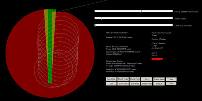

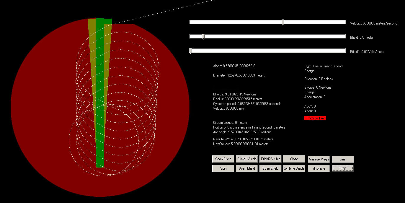

Thanks for the very useful thread - this is something that I really struggle with - the maths is bad enough without all the unit conversions, or worse, units 'assumed'. I have been trying to write an ion simulation, in order to try and model approximate trajectories of a small number of ions in electric and magnetic fields. It all came unstuck when I tried to model the electric field density distribution on a non-symmetrical conductor. :cry: In the image, red is magnetic field, green is electric field and yellow is 'overlap'. This run is of a cyclotron type configuration, and is obviously simplified - I have other attempts using more accurate non-homogenous fields. Real world numbers and examples are much appreciated!
