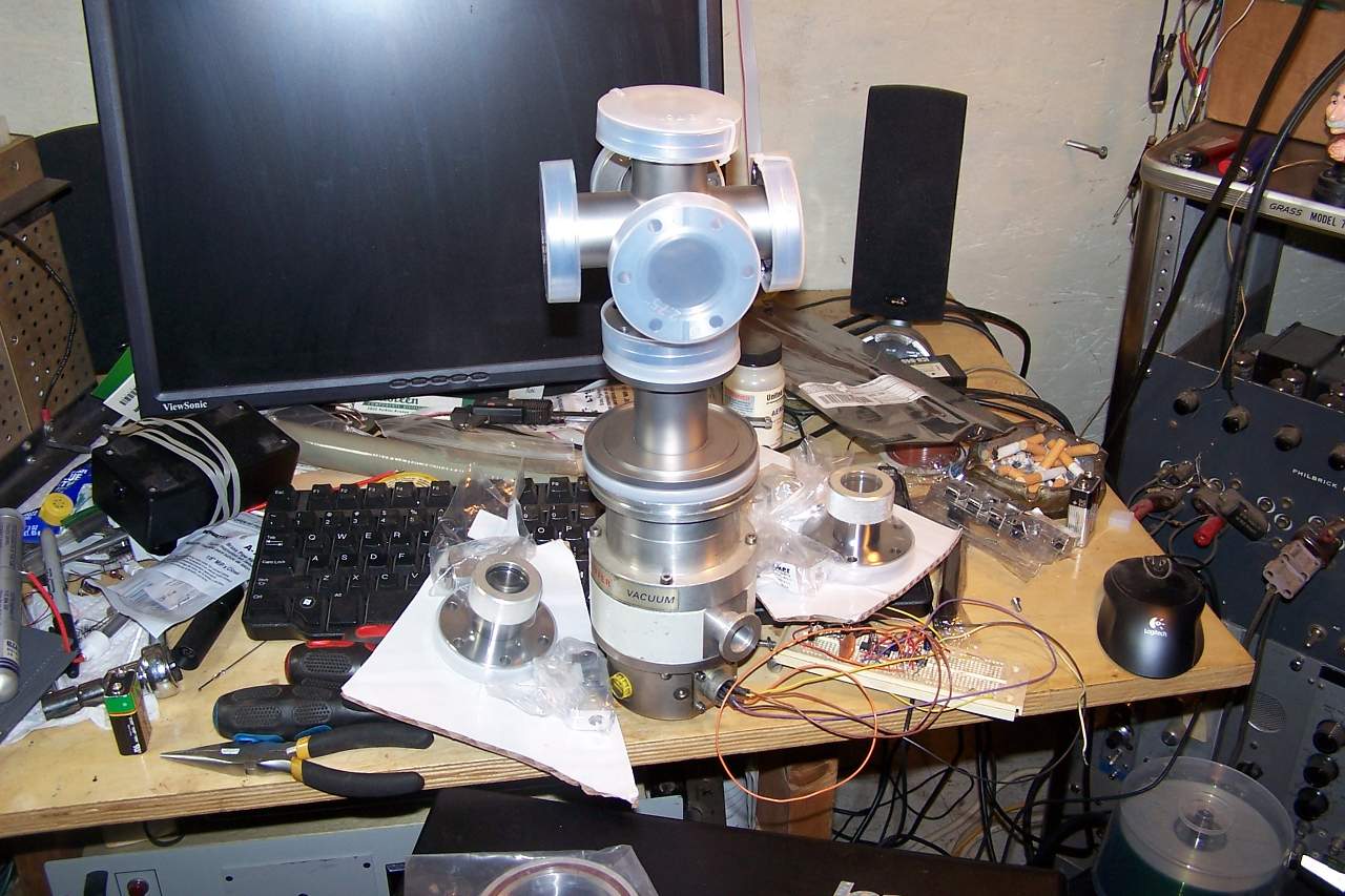

This is kinda what I'm visualizing as the stuff at the beam intersection point. Making this from the parts shown might fairly seriously stress my welding abilities. I have a button-head TIG, but it won't go down inside that size pipe, so I'd need to MIG from the outside or braze I guess. As well as fix up some kind of reducer for the bigger pump flange on the bottom. This really isn't as much port-age as I'd like to have, but it gets kind of cramped or I have to use a bigger cross to get more in. The idea is pump on bottom, beams in from the sides, window on front, wiggle stick on top (for target holders, moving a probe in the beam etc), electrical FT's on back, or something like that. In this case I'd have to run the thing at ground, with all the HV at the ends of the beam pipes, as I can't imagine floating a pump all that far off ground, and the complexities of floating it are ugly.
Photo of spare parts to maybe be used for this approach

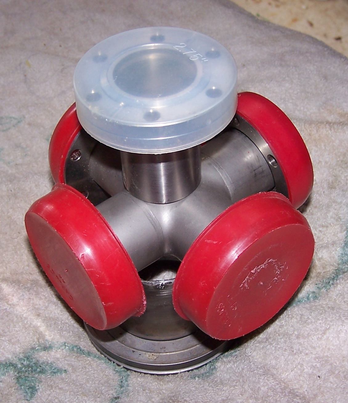

OK, I have most of the parts for this now, so soon I'll be starting another thread about actually doing this, instead of merely discussing it (though we can still talk trash here).
Parts pile
The idea here is beam pipes through tubing couplers out the left and right, window on top, wiggle (push pull turn) stick on the front, and multi-pin LV electrical feedthroughs on the back. The real high voltage will be on the ends of the glass/quartz beam-pipes. For the first go, I plan just one pipe, about a foot long, with the ion source out at the end. This will let us learn to do beams generally, test beam on target things, do diagnostics. There is a very good chance each side will wind up looking like a miniature version of what John Futter is running now, and for most of the same reasons. We'll want a magnet (at least) to do ion selection, and perhaps spin separation, as well as act as a place for electrons back-accelerated to have their own target other than the ion source. And of course a focused beam has to also be aimed, so it will have deflection plates and so on, with any focus voltages coming in through the sides of the beam pipes. There will be a few interesting fabrication details to come later, but you can see that I'm going to need to segment the glass pipes so as to get volts to lens elements and so forth. Hopefully we can run this in the e-6 or e-7 mbar range, at first on my already built up pfeiffer pump station (60l/sec) once I take the little fusor off it, later on those surplus pumps, once I complete the good driver for them.
The only viton will be on the beam pipes, for the couplers (shown) and the ends. The rest will be CF and bakeable.

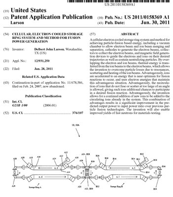

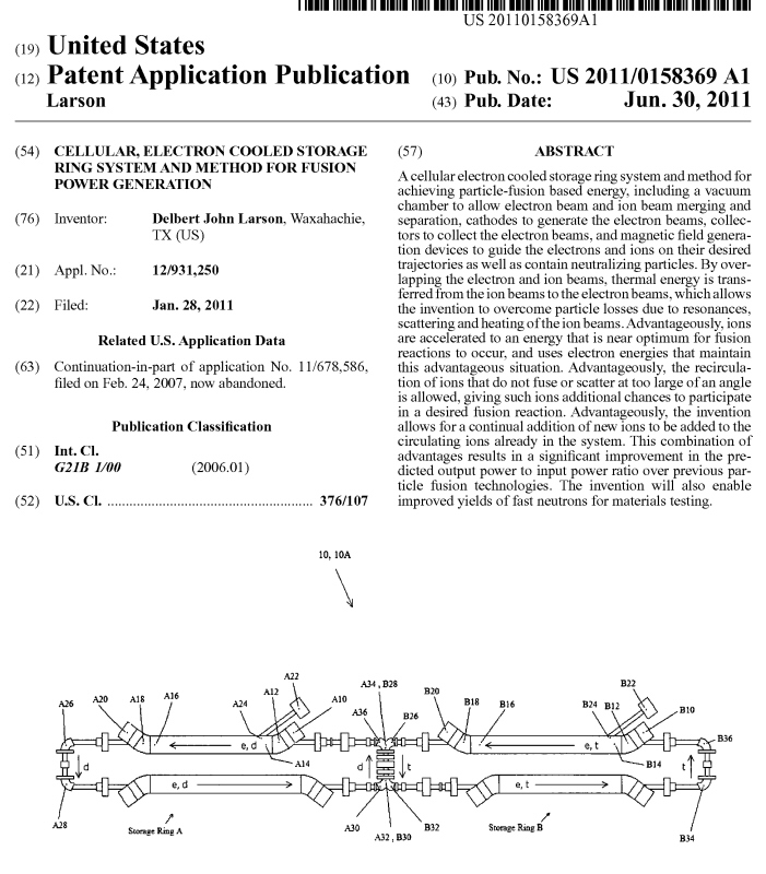

Just for interest, this patent application was published on USPTO yesterday:
Re: New simplifying approach -- beams
Postby Doug Coulter » Fri Jul 01, 2011 9:12 am
Don't you just love it when some jerk patents something they've not made actually work yet, just in case someone else makes it work? This "will" or "could" allow this and that - obviously it hasn't yet, but this guy thinks you'll owe him a piece if you make it work. Too many trolls on the planet. At least so far, no one seems to be on to the idea of the conservation laws. Hah.
BTW, I recall some prior art on this -- the picture triggered it. This system has already been built in some national lab, for other reasons. They were using the electrons to "cool" ions, and to allow a higher flux ion beam to exist without Coloumb-exploding for some non-fusion related experiment. So this is in the class of things where something has been known a long time, and by adding something like "in a computer" -- or in this case "for fusion" it's now patentable again. All you need is a few million dollars and a few years to show the USPTO some prior art to get it rejected....what a scam our IP "industry" has become.
Reason: Remembered prior art

Postby chrismb » Fri Jul 01, 2011 11:55 am
I recognise [and do not implicitly disagree] with your dismal view on patents, Doug, but to be fair the guy might be prototyping it right now. Watching USPTO patenting these days, as I do, I can tell you that with '..method for fusion power generation..' in the title, it is going to get short-shrift with the examiners. This stuff doesn't wash anymore unless, of course, he's got some evidence to present them to show he's generated power with it!!..
The thing is, if someone else has been working on it and has figured out some 'missing secret sauce' that the invention needs to work properly, they need only patent that and they will then a) be able to challenge the first patent as having been 'not enabled' and have it dismissed, and b) then take 'control' of the tech themselves (because to execute it practically, it needs that secret sauce).
Whereas, if the patentor has fully disclosed a working example (whether prototyped or otherwise) then why shouldn't he have a right to be rewarded for his inventiveness? If you are going to bash your head against a brick wall for years making something work, there has to be some form of intellectual-property recognition at the end of it, else what's the motivation for trying?
