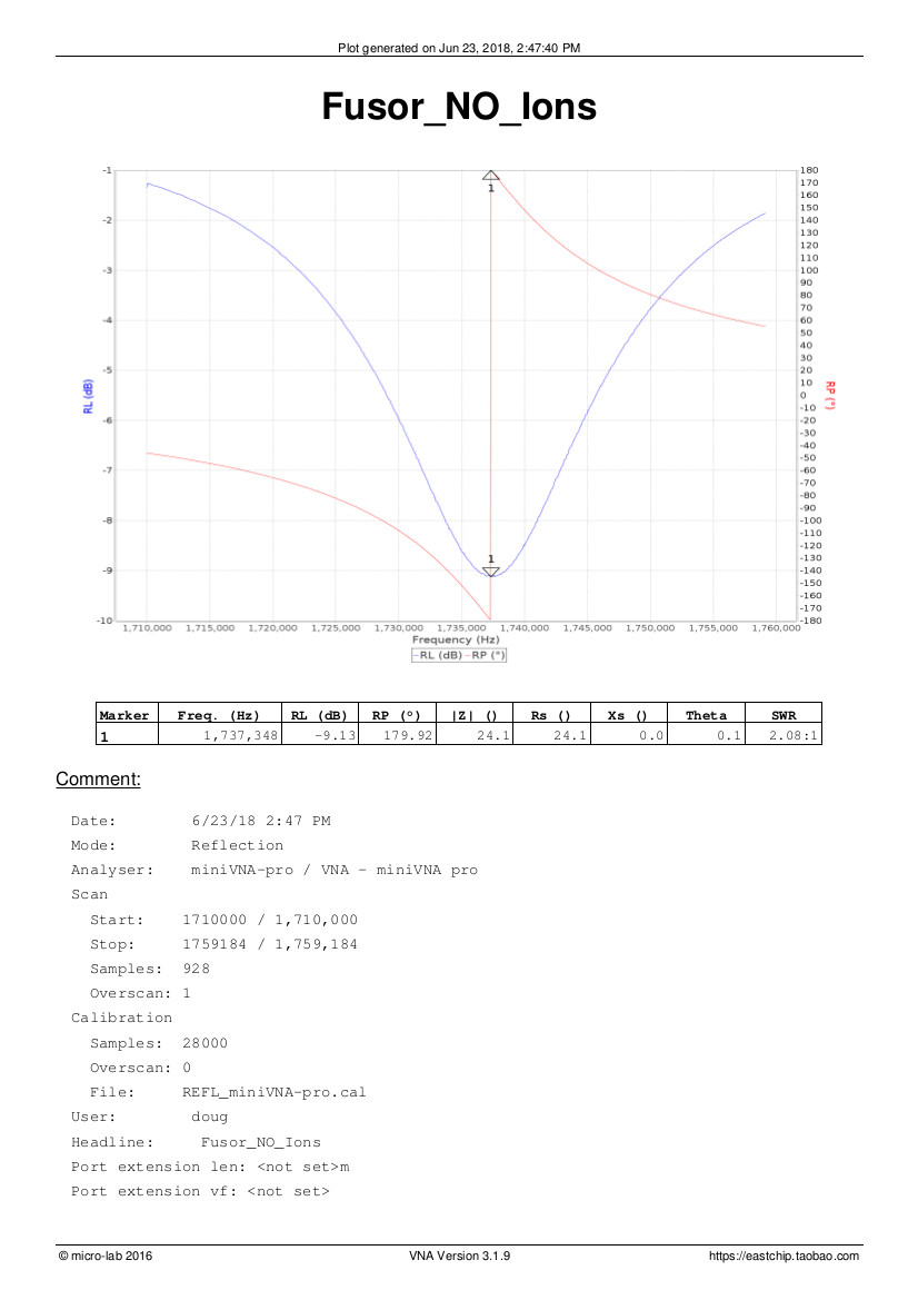

A little more info. I lashed up the MiniVNAPro in place of the GR oscillator, added a 2.5mh choke to ground to protect it from stray junk...and made a run around the resonance with gas, but no ions present (yet). The choke dropped the resonance around 1 khz, so I'm glad I checked with it in place - I have no idea about any tolerance for DC or transients in this thing, so..I did what I could (and it did live, no upper arms were bruised).
Here's the stuff as jpg and as pdf (which is where I got the jpeg - the jpeg export function in the VNA doesn't get the marker data)
No ions. Gas is present around 2e-2 mbar of D indicated.
VNA_180623_144740.pdf
PDF version, no ions
(122.08 KiB) Downloaded 221 times

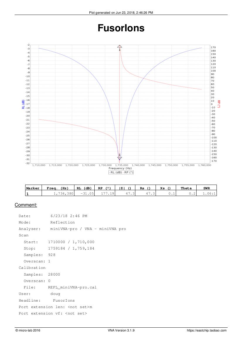

Now with ions - I ran the ion generator grid out in the main tank with the current limited small spellman. Same everything else (And I didn't measure the dc volts there, frankly it's lit or not lit and not much matters other than that - it's a sensitive function of gas pressure1 - we'll get there but it's going to take more data aq gear work).
With ions, same other parameters
VNA_180623_144625.pdf
PDF with ions
(131.33 KiB) Downloaded 227 times

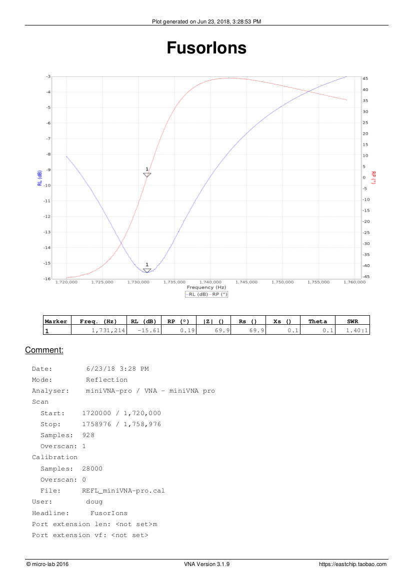

1. The above looked slightly odd to me, so I went and ran it all again...I *didn't* hit the same gas pressure on the nose (it's hard) and had a little more, about 2.2e-2mbar indicated. And it made a huge difference with ions present - but none without them. With just this much more gas...the resonance and Q are lowered a LOT more. FWIW, running fusor in DC mode, the run above at 1.9-2e=2 mbar is where we get best Q - or really, the lower the pressure we can run the better it seems to get, but you run into a hard limit if you can't get it to light off, hench all this work on ion sources and so on. It seems here that we have a fairly major bit of new evidence that just this little change - +10% or so, makes ALL the difference!
HMMM....implies a few more ions are producing more effective capacitance and some resistance here. FWIW, I ran the little scope while it was scanning with the same vertical scales, and the VNA signal just didn't show up at all...milliwatt vs watts from the GR I suspect.
Ions, higher pressure
VNA_180623_152853.pdf
pdf of same
(102.18 KiB) Downloaded 230 times
That VNA just paid for itself, I might not have noticed this without it. And I may get a better one that lets me insert some power amp into the loop and still get the same type of measurements - this seems to be a very much NOT scale-invariant kind of thing, which is kinda how I thought it would be.
