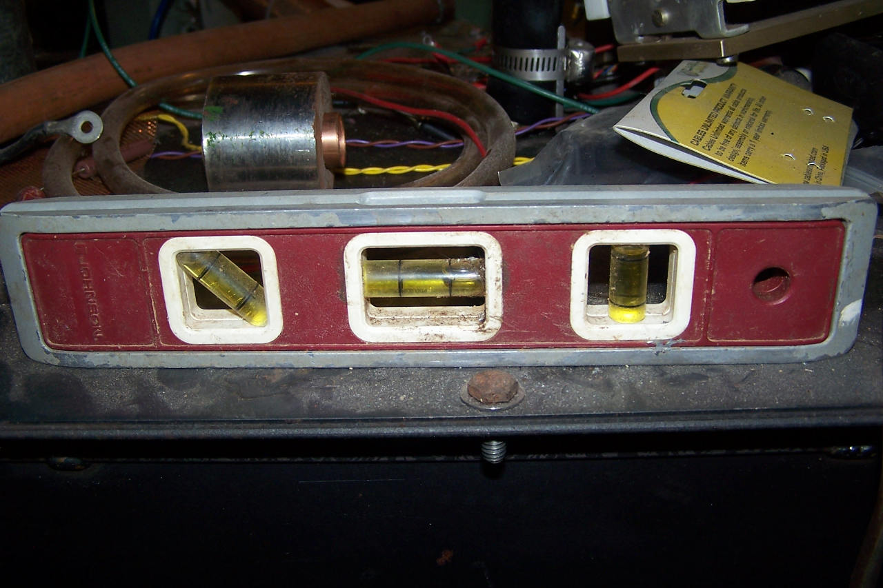

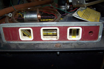

Uh oh. This is getting worse fast. When Bill was last here, about a week and a half ago, we were at half a bubble off level back behind the fusor (and all the new lead).
This is bad. This is sitting on a big X ray supply we've not yet used, too dangerous without finishing the shielding yet...heck, the Spellman SL2KW was already too dangerous, this is twice the volts and current at least.
It appears the new lead, in conjunction with the milling machine, and the X ray supply (it takes a winch to lift the transformer alone) are just too much for my floor.
Now off by a whole bubble. Oops.

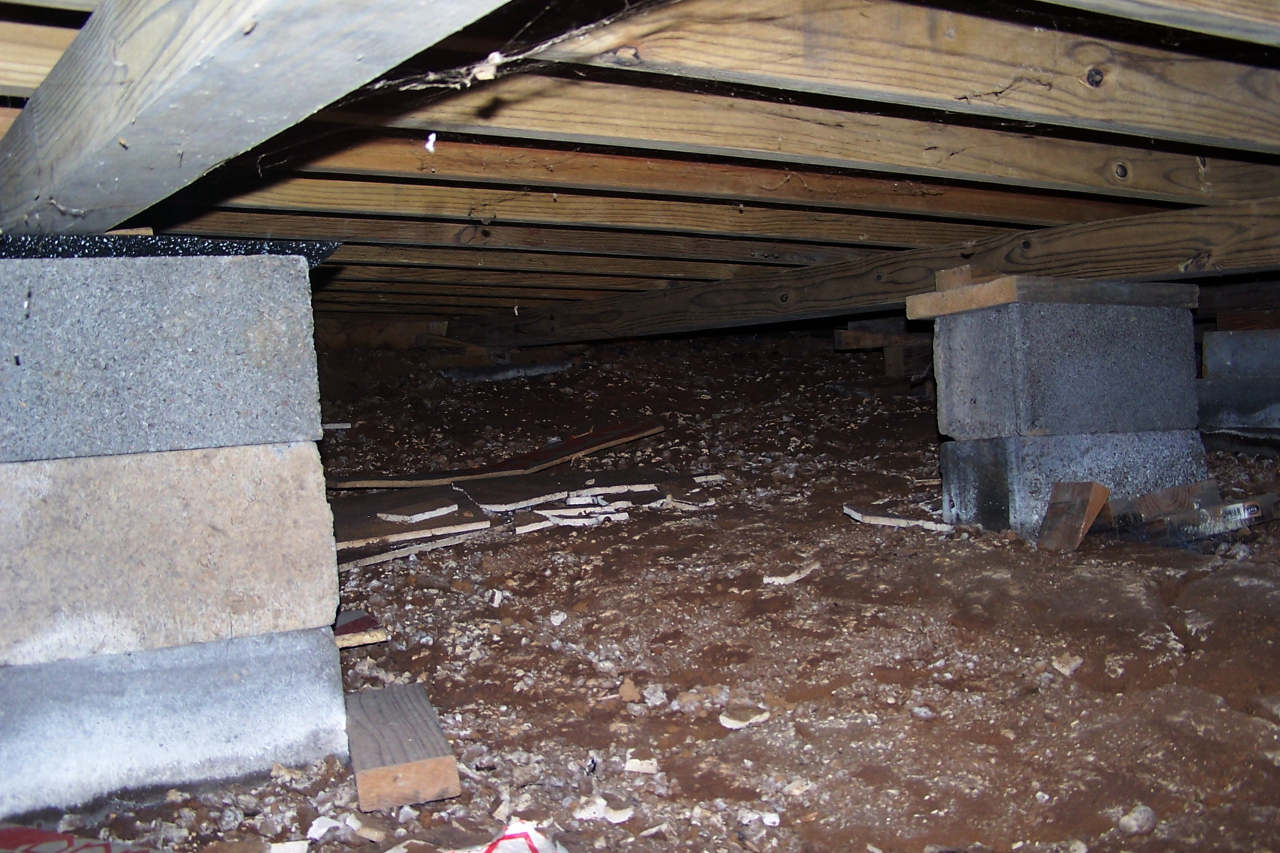

It now looks like this underneath. Since my normal helper is too...em...rotund to even fit in there at all, looks like I'm going to be doing some crawling, digging, and installing a new pier right there. That beam is pretty bent, and it will take about a year to get straight again if previous experience is any guide. You jack it up more than a quarter inch or so, and the entire building comes off the other piers - it's pretty stiff on a short term basis.
Less headroom than it looks like over there where it needs work.
Not really looking forward to sniper-crawling with a couple cap blocks, a shovel (super ugh place to have to dig) and a big bottle jack and large angle iron to spread the force well. But looks like I'd better find the motivation fairly quickly.
