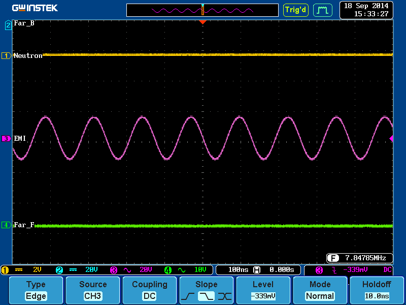

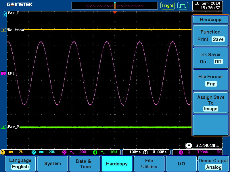

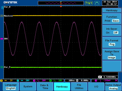

At any rate, here are a couple of scope screen caps on and off resonance, driven from ~50 ohm generator, and looking at the feedtrhough (eg, the top of the capacitor to ground).
On the resonance
And a mhz off or so (you can get all the numbers off the scope screen if you click and expand the picture)
Off resonance. The Q (in the RF sense) ain't great, but should do.

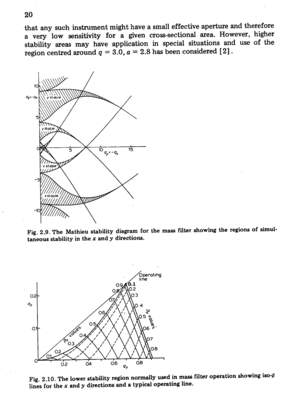

Since it's small, here's the Matieu plot for a simple mass spectrometer. A fusor adds some other variables like the speed of the particles, space charge and so on. Note that the whole useful area of this curve is a small spot where the intersection is.
Anything I can do to reduce my search space is therefore worth it!
Nasty turf for peak finding!
