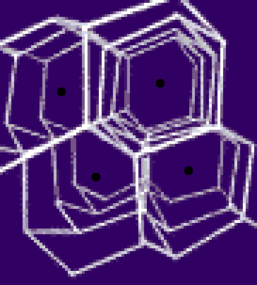

Again, to make it simpler -- we want a basic chemical structure that looks like a bunch of pipes seen end on. In the middle of each is where we put our fuel atom. Any scattering off the high-Z crystal lattice should direct the incoming beam ions into the middle of this channel....so we in-effect, increase the probability of a head on hit on the desired atom, using the others simply as guides to direct a sloppy "shotgun" beam into the middle of each channel. This is very similar in concept to that really neat thing John posted about neutron lensing, but at a much more microscopic scale, in fact, it would have to be far smaller than the tiniest existing carbon nanotube to work. From the wiki, we know it works in silicon at the right orientation, so what we need would be for example, some sort of silicon hydride (for DD) or some lithium compound to make this idea real.
Here's the picture from the wiki article on ion implantation of a suitable structure (in this case silicon). I expanded it and put dots where I'd like to see my actual fusion target atoms to be.
Smart Target design
I only show one black dot per pipe, the poor viewer (that's us) has to imagine these at one per layer of crystal unit cells going back into the paper on the Z axis.
I have some local help designing this crystal compound, from some guys in the chemistry dept at VA Tech, we're looking into it. Here's the big problem so far -- nearly all fusion targets of interest are mono-valent chemically, being low Z (and A). This makes it less flexible to design a compound with this structure where the target atoms are in the right places and held tightly.
I guess you have to get up to boron or so before you can have more than one bond, and that one's hard to fuse. I've basically been lurking the crystallography sources to find a crystal that looks like this with H in that spot. I'm really hoping some experienced crystallographer will show up at some point and go, oh yea, I know of one just like that, it's easy, but so far no luck on that, and believe me, their literature is tough going looking for what I want so far.
The real question here though is -- can it work, if I can find such a substance, or make it? The idea of course is that the heavier atoms that make up the rings would scatter the incoming beam to the channel centers and effectively increase the beam density there and there alone (or you could think of it as target density, it's the same idea) -- before losing too much energy to electrons and scattering -- which is why I posit this has to happen in the first few atomic layers if it's going to work at all. Instead of nano-tech, I'm talking pico-tech here.

In terms of just a 'plain' crystal structure, electron clouds around molecular compounds is, as far as I recall, not uniform and there is a branch of theoretical chemistry (darned if I can remember the name of it right now, but I think there is freeware in that field) that calculates where the electron cloud around the whole compound is strong/weak. I suppose the other thought is to find H-rich compounds where one can build a crystal of the stuff with all the 'thin' electron clouds around the H (or Li, or whatever your target isotope is going to be) pointing in one direction. Maybe that'd ease the electron losses...
...just brainstorming, here, for your target options...

Its probably easy to do in silicon 100 type wafer.
Set up wafer as cathode with ion beam normal to surface.
Yes some of the beam will do damage by displacing Si atoms but the channels should act like the interior of the usual wire grid albeit at the atomic level.
Of course a beam on beam one each side of the wafer would squeeze the D into the channels until full.
Because of the Van der Whals forces the d should stay in there until forced to move, cathode heating comes to mind so a cooled cathode maybe needed
what then who knows, a good experiment to try

John, I'm still thinking of making the target with plain old chemistry, cheap and reliable, but I also like the idea you present here, of using a backside beam to fill it up and Van der Waals forces to hold it together for a bit. Should work -- chemical bonds are wimps compared to the energies here, just need the stuff in the right place and time for the idea to work out. Beam on beam would surely work in a different way if this works, with even more destruction of the target - which would not matter as it was expected to last just one shot anyway, then you move something to work with fresh stuff each time. Perhaps you even make the guiding lattice out of something that has interesting reactions with the products of the prime fusion reaction to get a little more output. Certainly, those atoms are kind of positioned ideally for the square law to work for you.
I do wonder a bit if the lattice damage we all know about defeats a reusable target worked from both sides, but if a gentle beam used on that back side, maybe not a big issue just to get ready for a shot? You'd heat it and increase the jiggle doing that, but... Beam on beam on this general line of thought would be totally killer - and gets the conservation of momentum gain in effective input energy like other colliders. One thinks of short low energy target-filling beams from both sides, followed by the real shot, in that case. I'm now wondering how thin a film the target would have to be for that to work -- darned thin, I'd think, before you lose energy and the desirable part of scattering? What Johns pix seemed to show is that you lose all that quickly with depth in target. We're working inside the first pixel or two on that scale, I think.
At any rate -- even if you can't keep using the same target spot, that's a mech engineering problem to move another chunk into the right place to get it done for the next pulse, or have the beam skip around between shots -- the target should be pretty cheap compared to the energy it makes. I note we have a couple good mechanical guys here, too...

anyway channelling goes in a long way Doug many thousands of atoms deep with little energy needed standard 300um wafer would be ideal for a try
