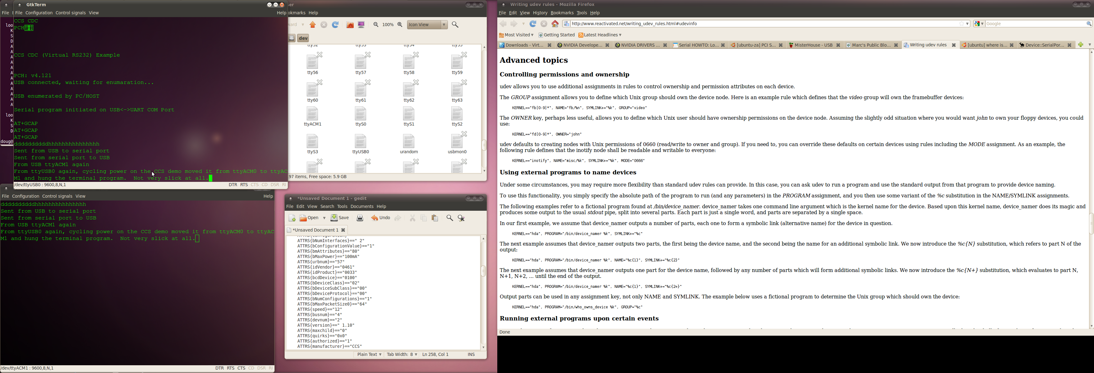

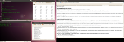

Screen demo
I'm doing it this way because I learned long ago that if you can't trust your test gear, all bets are off and until that's right, no point in proceeding -- you may as well take up a kinder hobby, like self-flagellation. And I need this anyway, for this and other things that depend on USB for data logging -- we need the PC program side to be rock-solid-stable or there's not much reason to proceed -- and I refuse to write code that keeps looking around for a moving target data source.
And yes, it's that bad. You can have a terminal attached to ttyUSB0, then hotplug some other USBtty -- and ttyUSB0 is now some other random number, even though absolutely nothing changed on it by itself... that's a bug in Linux most surely. Windows at least doesn't have that one -- but new hotplugs, come out as the next com port. If in windows you unplug com3, and plug it back in, it will become some other random com number, however -- more or less the same set of issues. Both seem to keep the original assignment/mapping around, but dead, for some odd reason, so when something gets plugged back in, it can't go there and has to go to someplace not yet used.

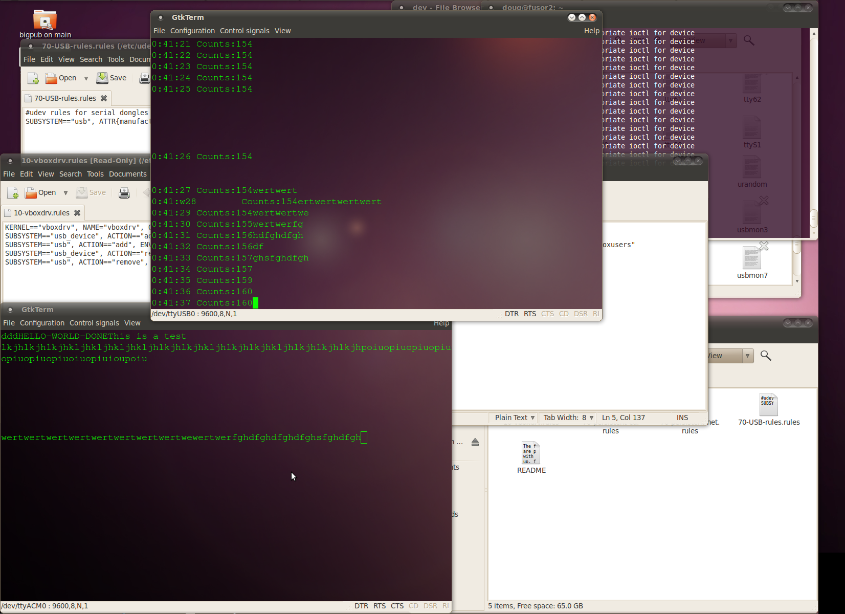

Anything coming in either the uart or usb gets passed to the other one. If a ! is typed into the uart, it triggers a special HELLO WOLRD message out of the USB port. Maybe they knew which was which was going to get confusing when these dumb pc opsys reassign ports everytime the thing is reset or programmed.
At any rate, duh, I could ship this as done, but of course I have some other tasks. I need some PC software to shove this into a database, I'd like to have the PIC compute some more stuff, maybe get some a/d channels and so on -- CPM and CPS based on the current and previous 10 counts, nice stuff like that. And I've not yet solved the random port assignment issue yet on any pc opsys and that's just dumb. Linux has a way to add rules to udev files to map known vendor/id to known names, but while it does create a file in /dev, gtkterm reports "bad ioctl" on it, so a little more to figure out.
At any rate, I can type to myself on another terminal either way to hearts content, while one of them is printing lines showing time and counts. The rest is sugar coating.
fooling around
Here's what one of my linux screens looks like after typing into the uart and pressing the "count" button. The lower terminal is coming out of USB. I could have this streaming out either or both at this point. Just a matter of changing a destination in a call.

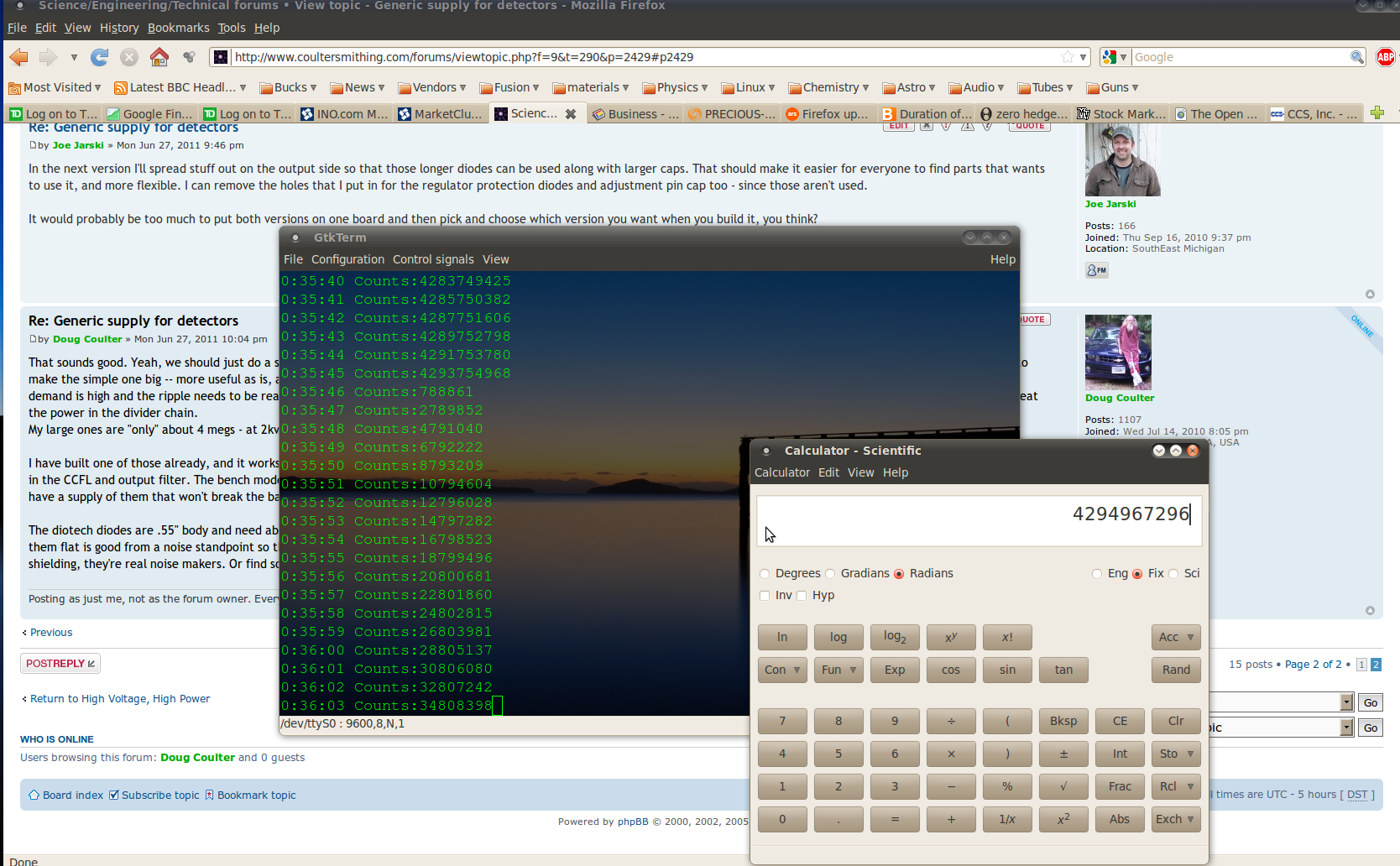

I've been running this thing now for a few hours counting at 200khz and haven't managed to catch it in the act of making a rollover error....so at worst, they're not too common. But one reason to keep outputting total counts (along with the more immediate data) is that you can go back through it and easily detect and fix one of those. I could do it in the pic too, and might, but....I'm a big believer in raw data being available. That's just philosophy, but one widely held, because you just never know when a new insight will make it more valuable than "interpreted or smoothed" data.
The possible error you can have in this is that the 16 bit counter rolls over and you get the near zero result out of the counter, but without the high part having been incremented. Turning off interrupts while reading makes it worse, not better. Turning the counter off is worse too -- you lose counts. About the only way to handle that one is to look for a number that went down, when there's only one direction it can go when there aren't errors - up.
I'm hoping that hours up to 65535 and counts to 4 billion will be enough for any one run, but speak now or it's cast in stone soon. This job won't run this PIC out of any resource or even close. It's tempting to think of features to add (a/d for example), but getting too fancy might kinda mess it up for the original intended purpose of just being a standard counter for the lab. I need to keep the line length to under 64 for one thing, or do much fancier output code to handle more than one buffer per line.

Just a little eye candy. Found and fixed minor bugs and got a nice screenshot. Forgot to use the right thing in printf for unsigned, and that the pic timer0 divides by two unless you tell it otherwise. It'd been counting at 2 mhz more or less in this picture -- it'll go faster I think, but that should do it for almost anything we'll want the basic thing for.

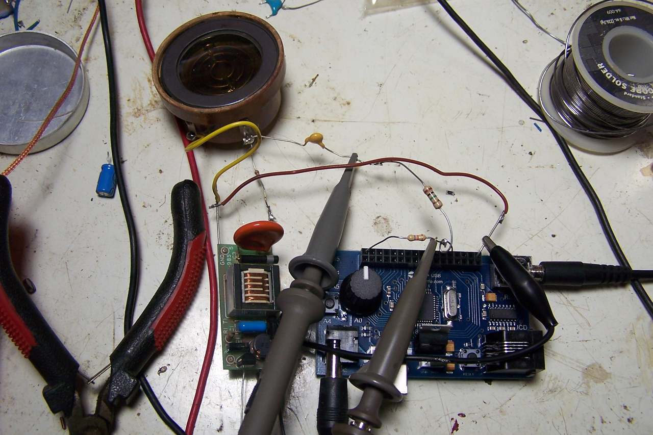

A little more eye candy. Here's the whole thing, working. Of course there's that little detail of changing this from a proto setup to a real thing we can ship out. But this is really all it takes.
I discovered that if I run the CCFL off the 5v, I can just use a half wave rectifier and no doubling. To get the volts just right, I used a 47 ohm resistor in series with it (which has a side benefit of protecting things from over-current). The signal processing couldn't be more trivial -- 47 pf coupling cap (not critical), a 1 meg feed from the HV (about 415v), and a one meg in series to the pic counter input, with a 47k pullup to 5v. Done. I will add 1n4148 diodes across the pic input to gnd and +5v "just in case" but really -- through a 1 meg resistor we're not going to be pushing lighting bolts into it anyway. So, some board layout, and a box, a little more code, and we're done with this one. With a different HV PS and a preamp, this would run fine on the B10 tubes etc too.
In all it's ugly kludgey glory
This is counting 22.7 cpm on my upstairs bench on mid-day background. It's pretty quiet up here today rad wise (and on the second floor so we don't see the radon stuff from the ground). This would imply somewhat less sensitivity than my other pancake counter, roughly proportional to the size. It will do fine for activations etc, and I'll get a real good cross calibration soon off a standard sample.
