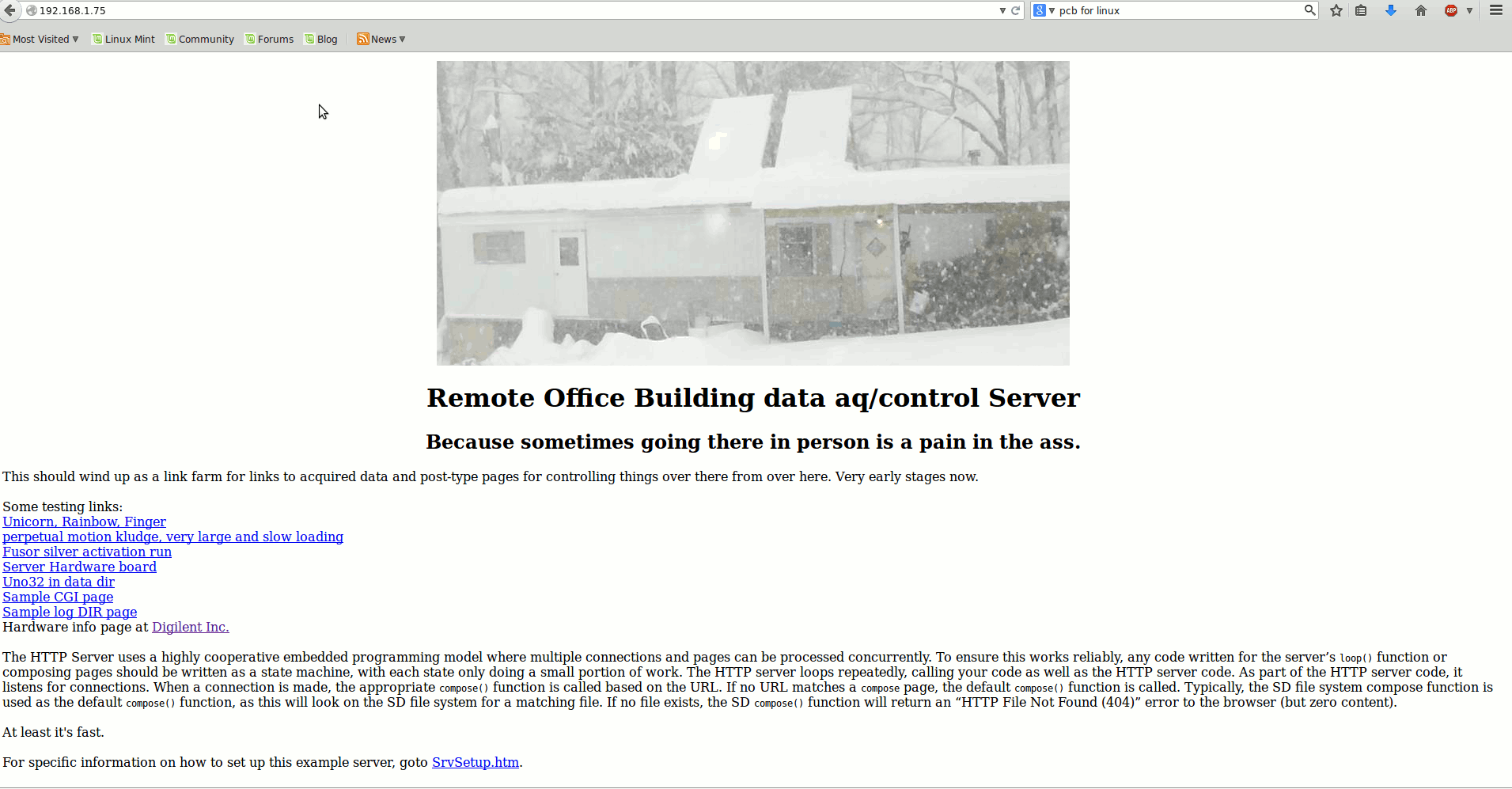

At any rate, here's what the current page looks like. The "perpetual" link will be dead in the sketch provided here, as it was 16 mb+ to test concurrency of the web server and file system (takes forever to download), and there's this new limit on "unlimited" for the present at this host, so I had to take it out of the "content" subfolder.
Homepage of the test server
And here's the MPIDE sketch for the board. It's a work in progress, obviously, but you can add CGI's (written in C++) till you run out of memory, and they can do just about anything you'd want. For now, the main one just lets you look at and download the contents of a /data folder on the WF-32 board, which presumably some other process is writing log files to - the main function of this thing. But it will be easy to add a dynamic webpage that shows all the sensor outputs, or something that commands a valve open or shut later.
