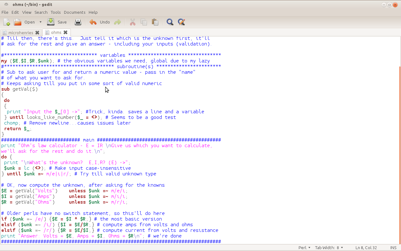

Syntax highlighted
See how much nicer it looks in a real editor? In this case, gedit which is simply a smarter version of notepad.
