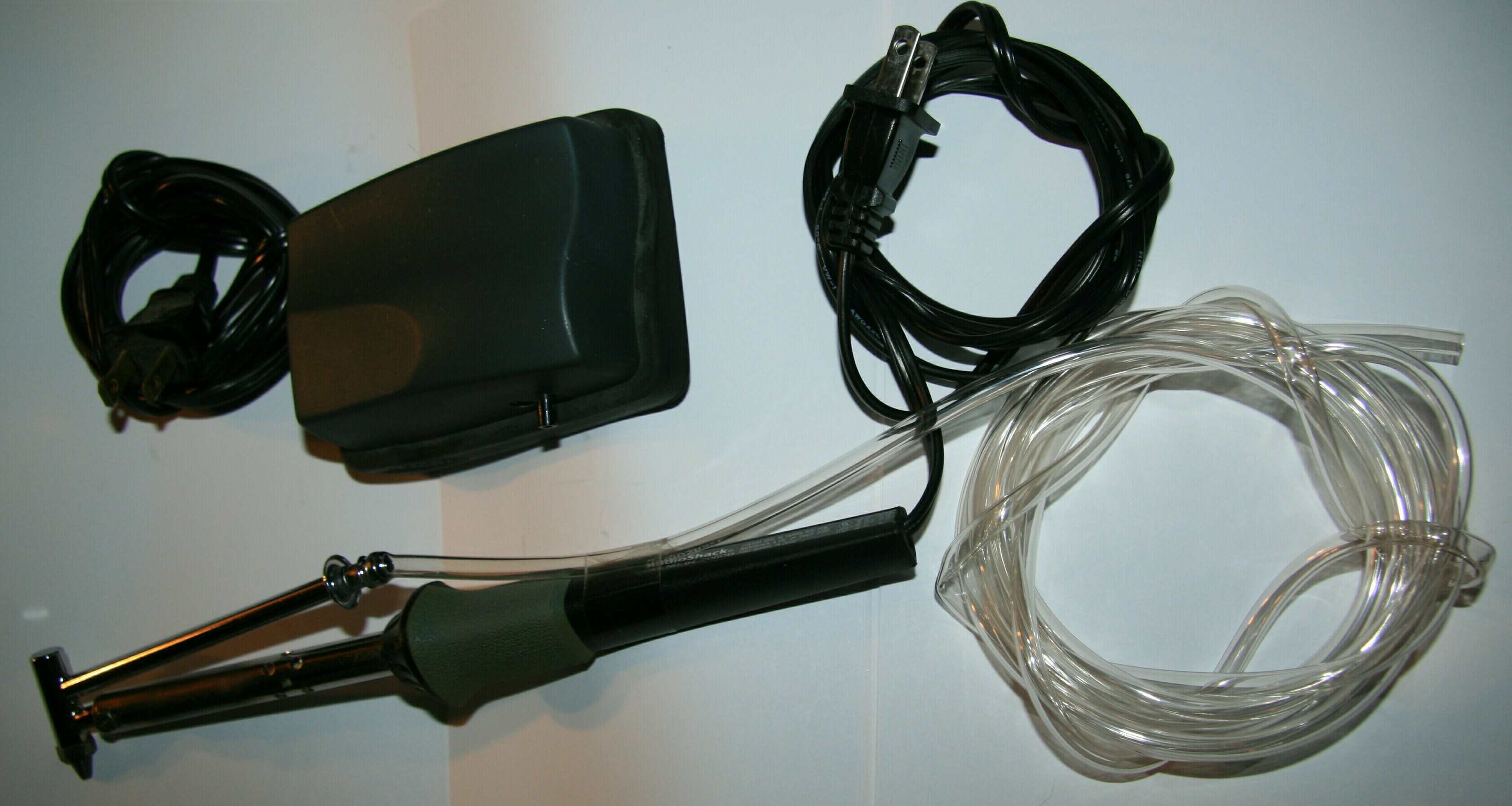

Postby William A Washburn » Thu Dec 16, 2010 11:53 pm
If anybody saw the DDS boards I built several years back you will notice the lead pitch on the ICs
is very small. I can't imagine what they are like today but I'm probably not up to it. So, I realized
that I needed a hot-air gun and came up with what's in the photo below. The unusual block in the
picture is a fish-tank pump. There are two things missing from the photo and they are a pet-supply
store fishtank valve to adjust the temperature and air flow (inverse functions with one control) as
it is placed in the plastic air line. The other is a syringe containing micro solder paste. The
techniques are similar to those that you may have read above so just follow these and you'll be OK.
The soldering iron and tip were bought at Radio Shack. The fish stuff can come from Wallmart
but I can't remember where I bought the solder paste. May have been DigiKey:
Hot Air Soldering Kit
