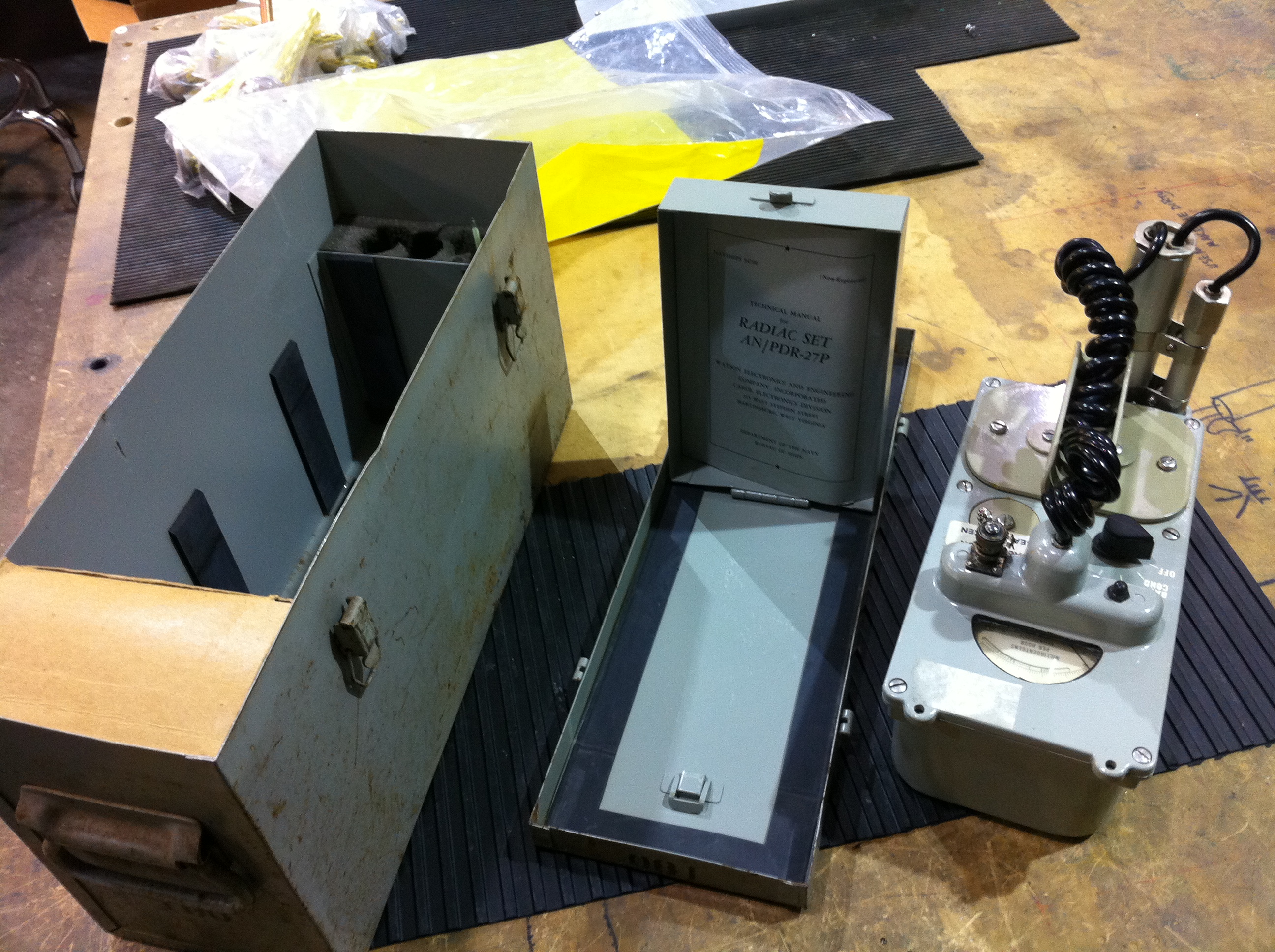

My new toy showed up last friday. An old PDR-27P ratemeter. In its box with manual, strap, and headphones. Seems to work. Picked up the alphas from some U glass prepped tungsten electrodes I have. And also picked up betas from some tritium betalights I have, which really surprised me. Of course it would only pick them up with the alpha window open and the tubes as close as possible.

Do you know the detector type in there? Geiger, or photo tube? Probe looks like it could have something fancy.

The geiger uses a JAN 5979 and a JAN 5980 in parallel for high sensitivity modes (.5mR/hr, 5mr/h Full scale) and just the 5980 for low sensitivity (50mR/hr, 500mR/hr). Two tube in front of it read about .05mR/hr and a handful of the tubes reads higher. The tube is a mica end tube and says it .0005" thick in the manual.
Paid $45 for the counter and another $55 for shipping.

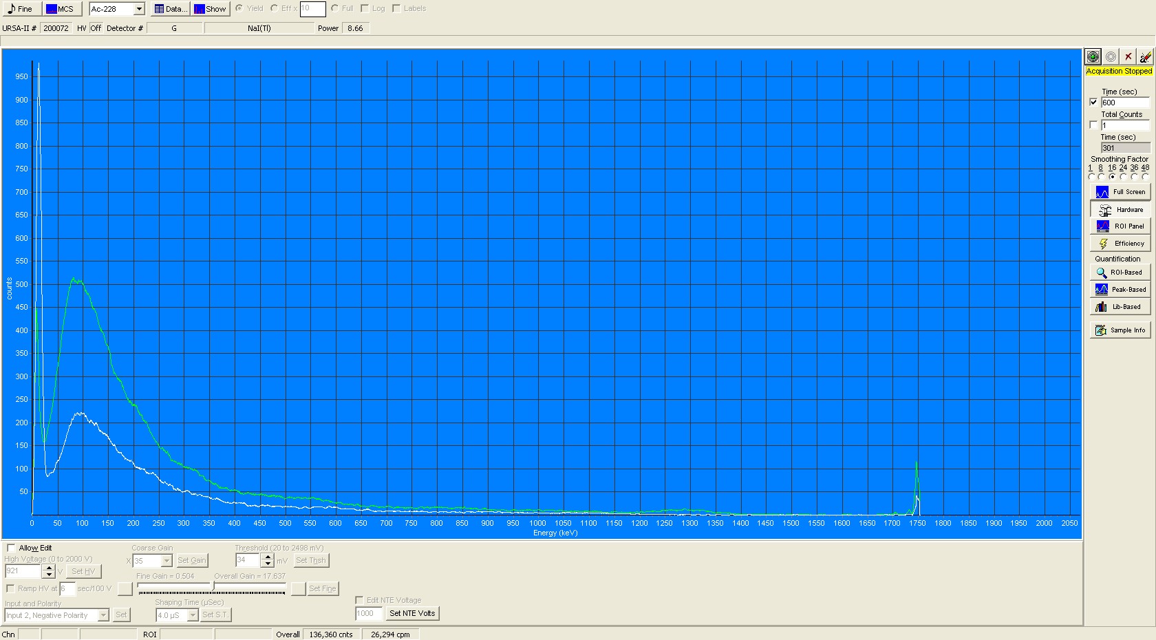

Postby Doug Coulter » Mon May 23, 2011 6:11 pm
Jerry, you're going to like this one.
I hereby retract all my skepticism -- and I refute it thus:
Tritium sign, 300 seconds, against a 600 second background. No sht.
Note the leftmost peak is right-shifted as it pushes more other junk above threshold. That means we can't take away much from the supposed energy, just that one heck of a lot of lower energy stuff was there with the X of my exit sign against the detector than not.

Postby Jerry » Mon May 23, 2011 7:08 pm
Well, I will pretend to know what that means...
Guessing the big peak at the low end is the T?
Re: Got a new toy (Geiger)
Postby Doug Coulter » Mon May 23, 2011 7:24 pm
Yes, it's the T, no question whatsoever in my mind. While a single pulse from a degraded-energy beta from a T changed into a gamma with attendant further energy loss is below the threshold shown here -- the fact that pileups pushed the usual thresholded-out noise up above threshold on double hits ( and quite a large number of them, evidently) says to me, unequivocally, that yes, outside the glass, T makes a measurable amount of (gamma for sure) radiation, easily (well,,,,I have some great gear here too) detectable.
So much for "you can't do that". Hah. You just did. I check that.
It'd be a lot better and more obvious on an HPGE with cryo, which I don't have and am having trouble craving the rent on but...no question at least as far as I'm concerned, I just checked it myself with stuff I have a lotta reasons to trust. It's way outa background here too -- never thought to check before.
Were I a little more ambitious (maybe this week, more likely next, I have this other telescopic job to do first) I'd put this up on a super good low energy resolver head (have one) and really prove it with an internal spectrum of the various energy "landings" on the decay of T into -- all this stuff. But that insanely higher peak says it all - it's there.
