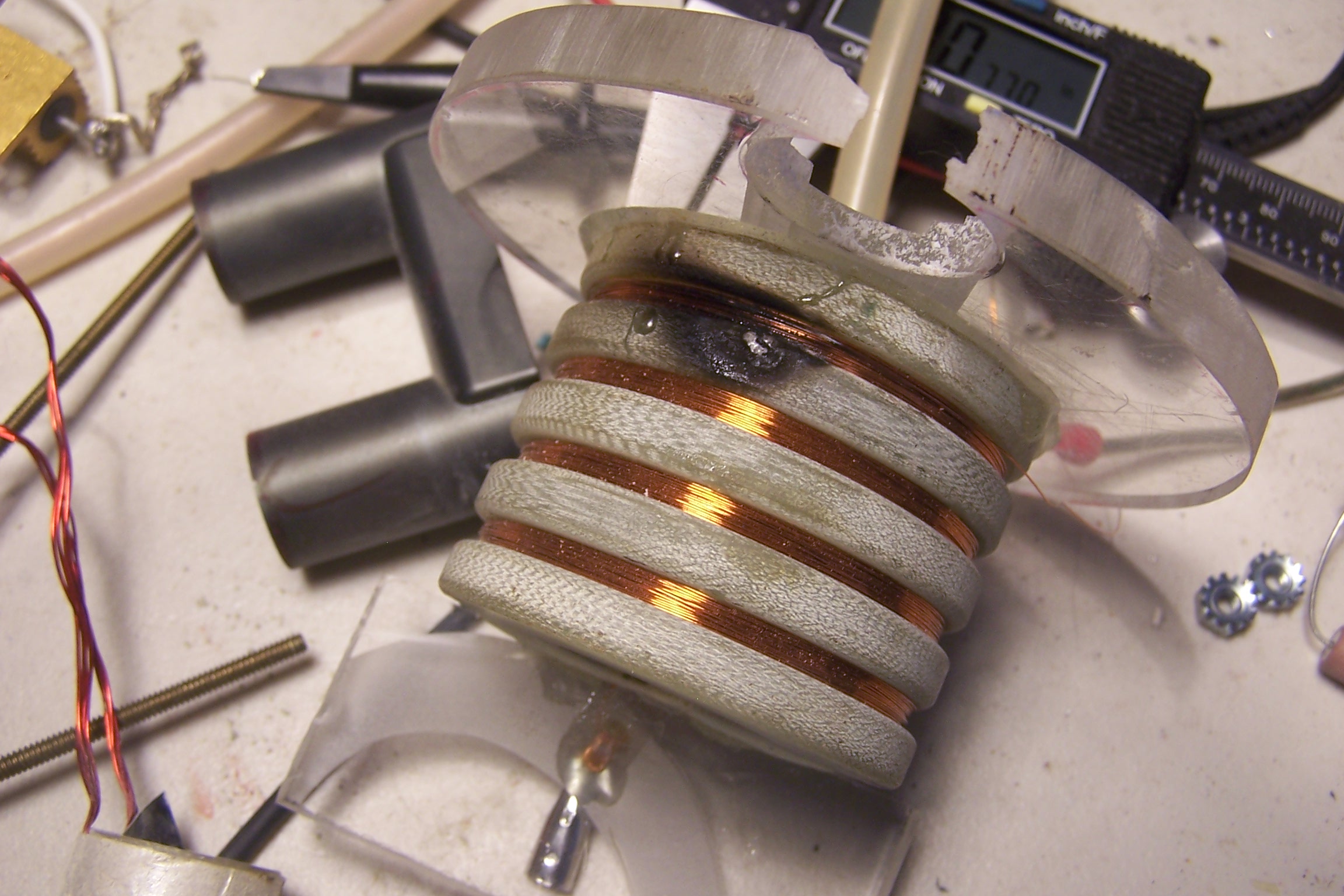

No guts, no glory, right? Move fast and break things. Well, in some initial tests here I've made a few neutrons with pure AC drives on things, and experimented just slightly with more than one thing being driven. But...I let the gas out of the tank while the ion AC supply was going full snot, and as the voltage rose due to no load....
Oh well, time to repair this - arced to the ferrite core
I didn't make this in the first place, but I guess I get to re-make it, hopefully better than before. I was driving it with my H bridge limited to about 20 watts at the time, with a series L to resonate the mess at around 30khz (and help it ignore the fast rise square wave edge it would otherwise load heavily due to its self-resonance at around 27khz)...
With a larger one at a different frequency on the main grid, I got neutrons pretty far out of the background, though not enough to do real cause-effect or tuning with any statistical confidence. At the moment, to get these high voltages (but not that high - I'm getting some neutrons at only 10kv or so now - our previous record on the low side was ~ 18kv with DC and it goes up super fast above that - 3rd power maybe?) - I'm having to use these gonzo zillion turn secondary windings and self resonance is what it is, and pretty far below what I think the good numbers are going to be from other measurements.

I managed to fix it by going after it like a dentist with a dremel and burr, and rewind 80 turns of that last pie. Sigh. I then insulated the bobbin further and also the core stuff.
And wouldn't you know it - in testing today, I was running it hot - it'll take a lot more now - and managed via sloppy jury rigging to get a nasty 20kv arc from the DC bias supply I was putting this in series with to sweep parameters (and got some interesting results doing that too...more later) - into the primary side, which in turn fried the DC low voltage supply, a $139 unit from marlin jones they don't stock anymore...it really let the smoke out of at least an OP-07 opamp, a resistor I don't have a clue as to the original value of, and probably one or more of the series pass transistors. I might have to part that one out, and lesson learned - or so I hope this will prevent more of that - to ground the doggone LV power to actual ground so those kinds of things won't fry the supply by vastly exceeding the available isolation - which I don't need at all anyway, that's what this transformer was for...$^@#$%@#$ :( .
At any rate, the AC part is good now, and I'm back to buying another power supply or two in case I fry any more. Those new TP 30005P are fairly nice if you do the ESP8266 mod to them...and use my GUI code to remote them. I did put up a script just now in the software section to allow people to use my perl GUI code...it turns out a big issue was how hard it is to get Gtk3.pm into a linux box on alternate thursdays and most moon phases, so I made a better install script for that than is normally provided in the system.
