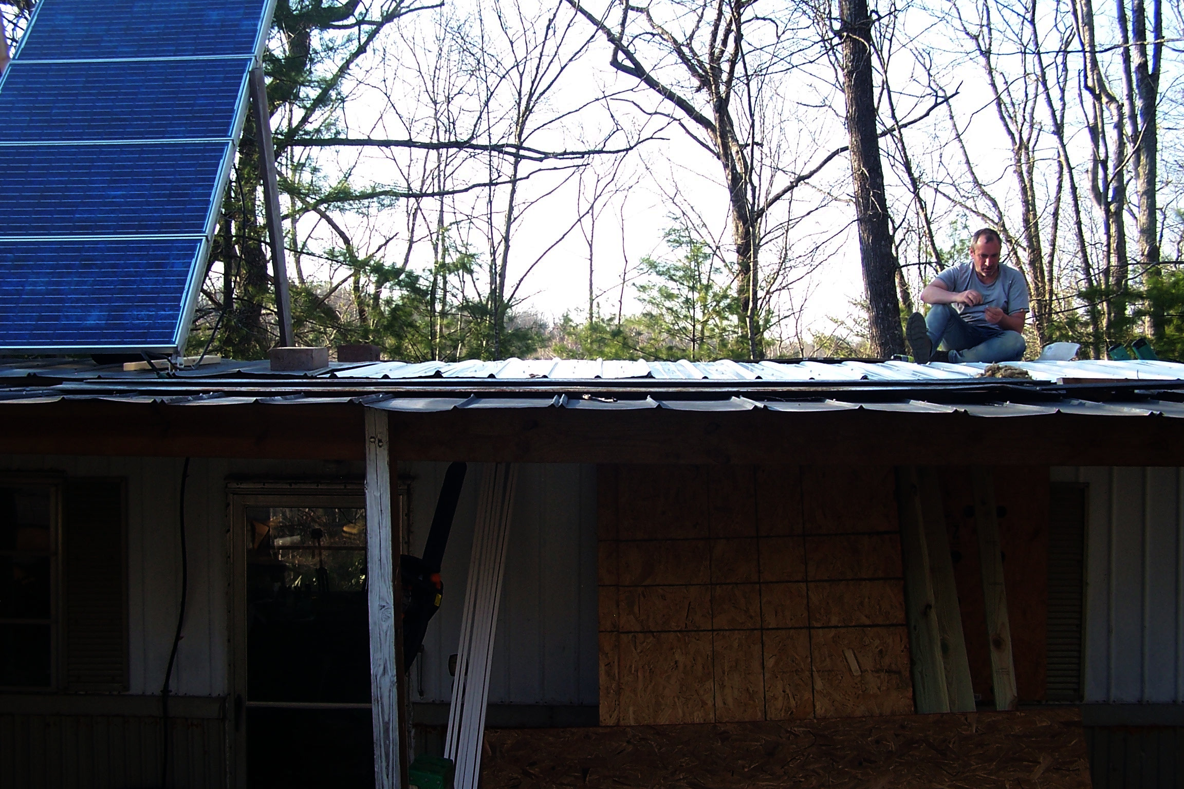

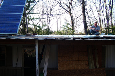

CurtisF helping on the new roof....
This needed substantial new rafter/supports, rework inside on the ceiling, insulation "at all" (no wonder it was hard to heat) and then...new roof sheathing and so on...next is tear down that panel rack
and get going on the rest. After some rest (it's going to rain, but we beat it this time).

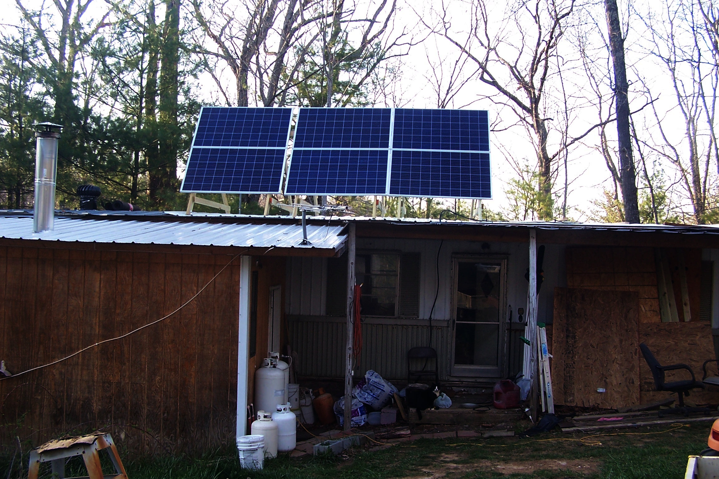

But wait, there's more! Instead of two racks of 8 panels total - some of which were 35 years old and finally getting weak, it now looks like this:
Progress, new panels
Bill, Curtis and I worked all day on this and got more of the roofing replaced with new metal, and these racks up and bolted down. A few hundred watts becomes what should be ~1200 now.
More shade on roof in summer plus power for air conditioning sounds like a win. These are off the roof a bit so as to allow snow to shed in winter, which is when they're actually the most valuable, as they catch low angle sun far better than ones south (on the workshop) closer to tall trees.
Left to do is roofing and insulation for the last 18', which includes my bedroom...pulling up the wood to do the insulation is a bear, but when it's done, we're really done.
