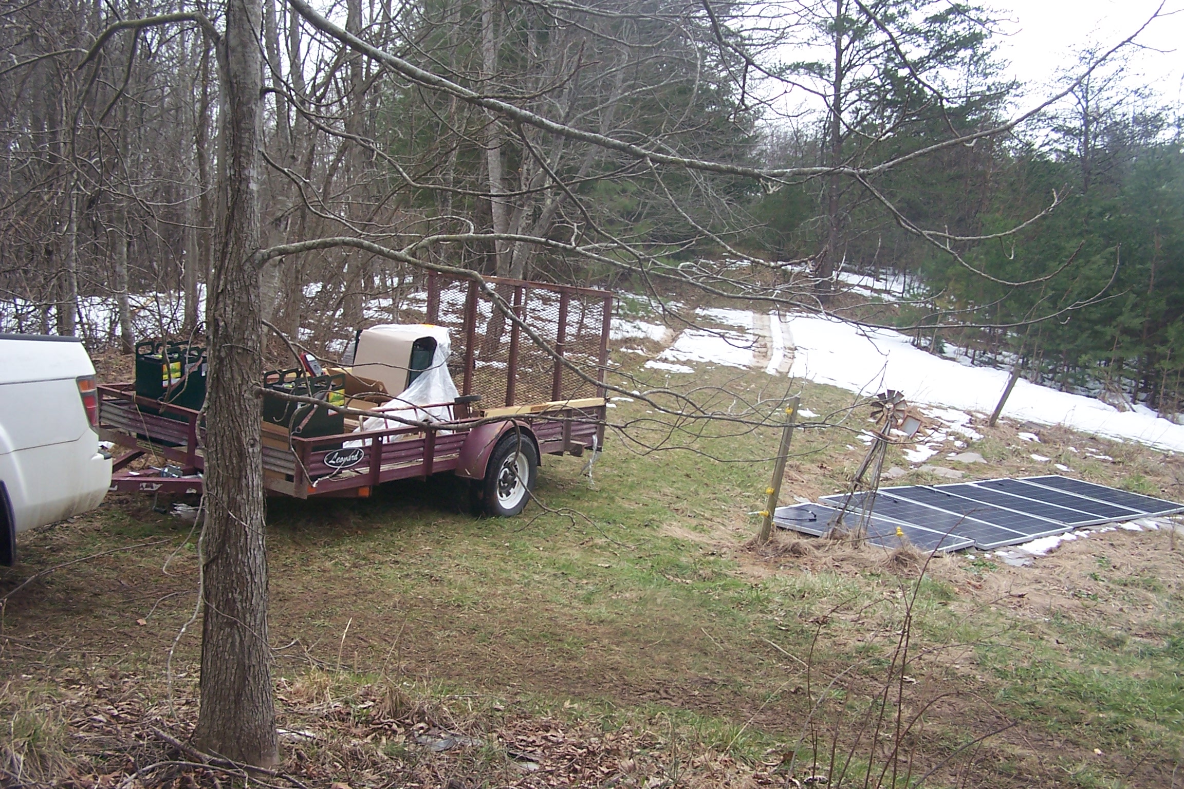

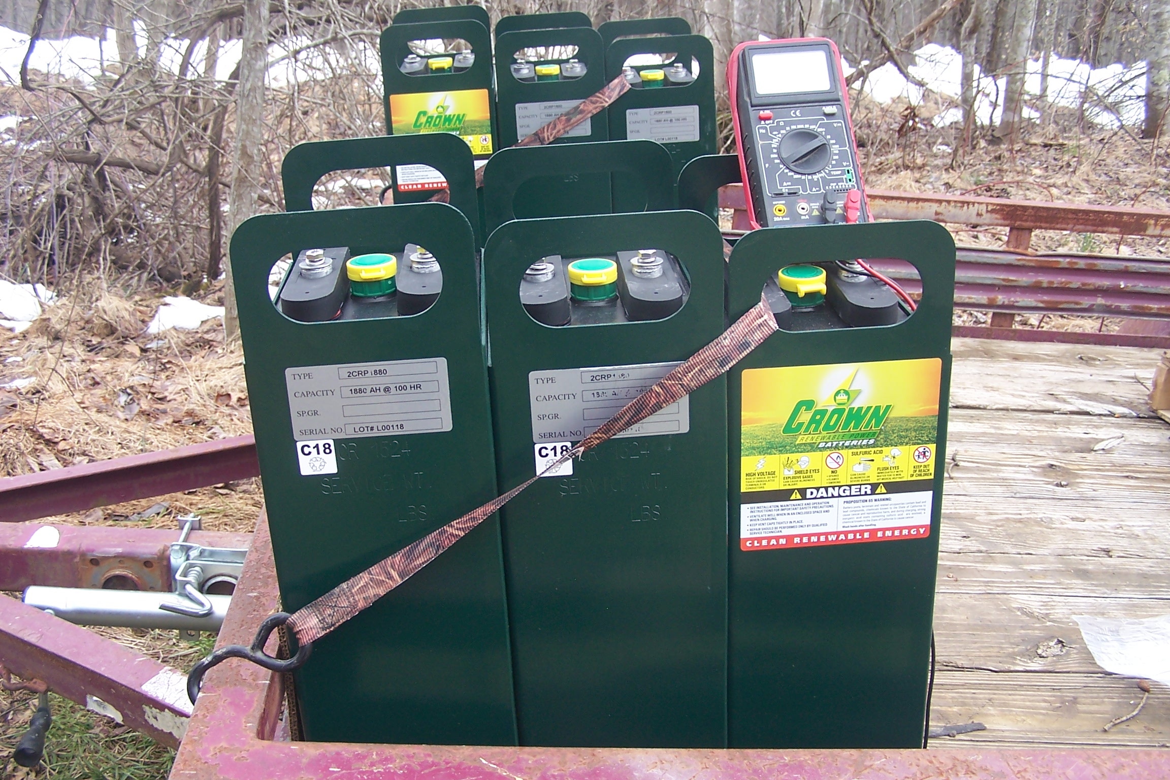

In a classic case of "what now?" , these huge new batteries came today. Now all I need is some young grunts who want paying work. Someone slipped a digit along the line, and while I paid for 1300 Ah cells, well, these are 1880 Ah. But there's no free still - these also weigh more, around 200lbs/cell. I have to at least get them off the borrowed trailer soon. It'll be nice to finally have "enough, and no compromises" when I also get that additional 1.5kw or so of panels up too, on the roof I have yet to repair.
But maybe the good batteries (which came fully charged!) are a sign of the karma getting back to more normal, which would be a relief.
Half of them...balance, my son, this is a heck of a load.
And the whole mess...
more to do...I needed more to do, didn't I?

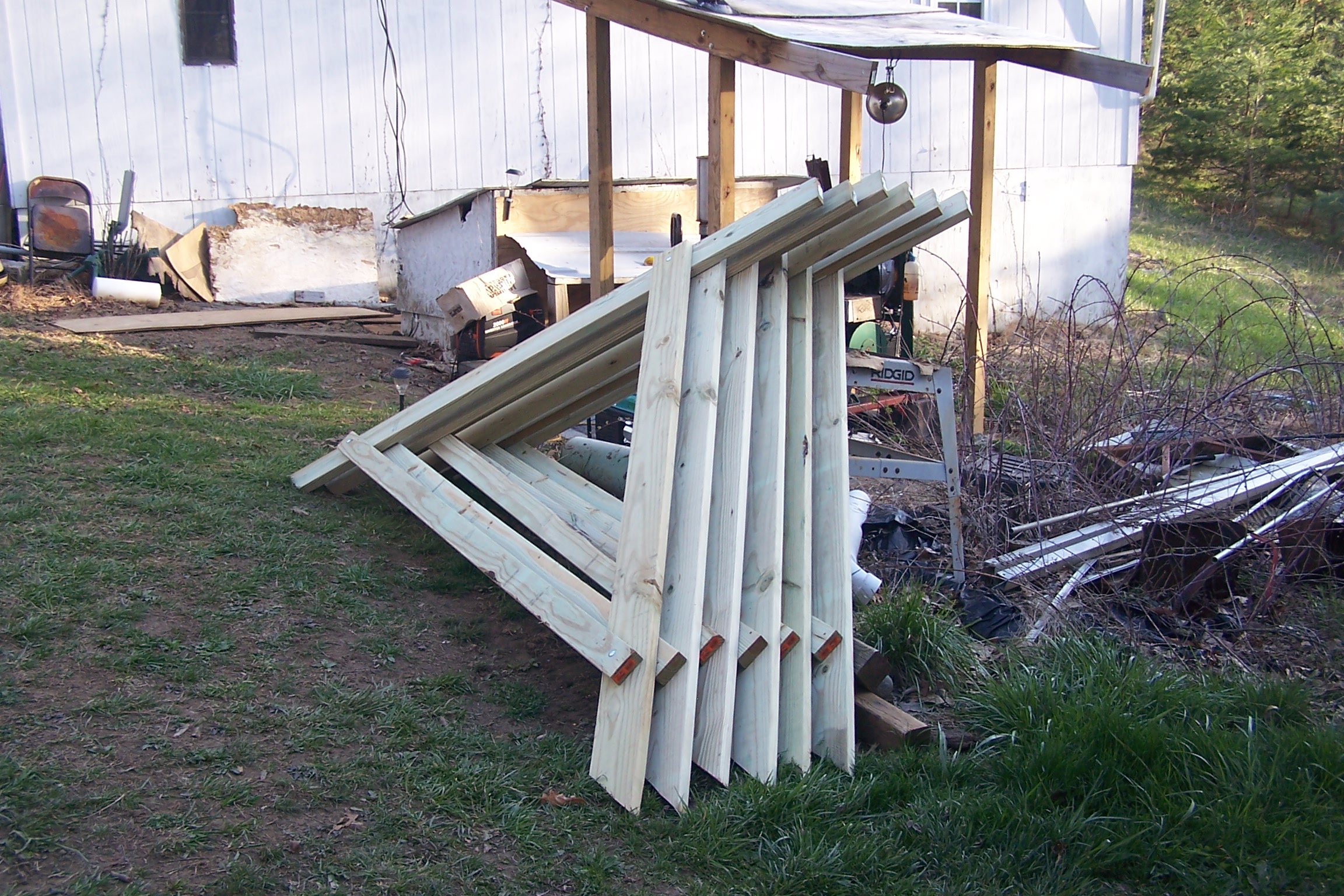

New racks for solar:
Still need the studs for panel mount added.

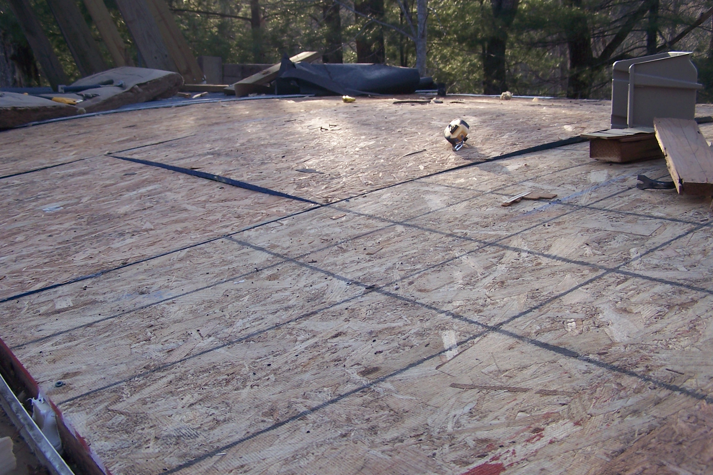

First almost 8 feet of roof re-raftered. That's the hard part...tar paper and metal will be easy.
Giving that second piece overnight to conform to the new curve. Pitch is nice to keep the water out.
We are adding r-13 insulation to the minute existing stuff as well. There was some breakage and other damage from where a treetop landed there. The rest is mostly going to be rip up old tin and boards (they used a jillion nails), insulate, put boards tarpaper and new metal back, with a side of take down the old panels and rack and put up the new ones.
Gonna be really busy awhile...

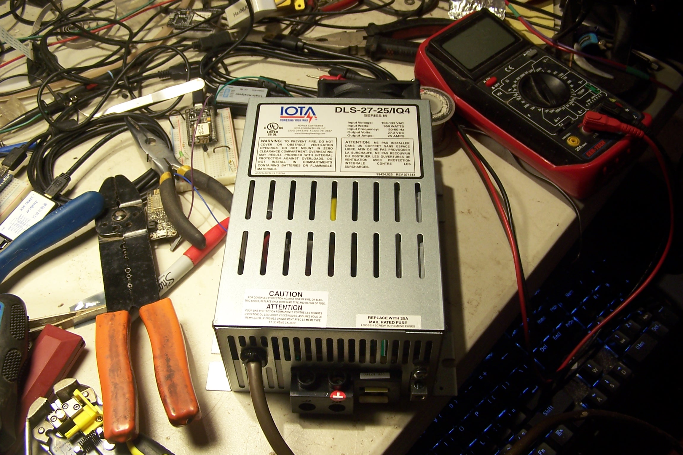

Also seem to have somehow fried the old forklift battery charger I'd used as a nth level backup, so I ordered this which came fedex today. Sometime during a break in roofing I'll put it in.
Of course, it's not yours till you void the warranty, so I put in a long enough power cord... Looks pretty nice inside there.
IOTA 25 amp 3 stage smart charger
It's a switcher so not too heavy, and has lugs for #2 wire. This one's "only" 25 amps, which I chose even though a 40a one was only a little more...because even this can draw some big peak currents, and I have a 2kw Wen gennie and a 1.5kw inverter in the Volt to use this with (and other things, but the idea is not to overload the source). My campus draws ~~ 12 amps when nothing special is going on (at 24v). So, run the place and charge in backup mode.
https://www.altestore.com/store/charge- ... ed-p11016/
When you do this off-grid thing you learn to have backups on your backups....
