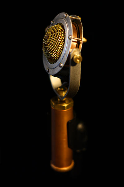

A bit better than the normal normal crap on TV. So I'm watching the musical performers and then am thinking, "what are those microphones they are using?" Never seen the like. Looks like they were made in the garage but they must be good to be used here. I almost posted something here then to see if anyone knew of them.
But I did a lot of web searching and over a while eventually figured out that this is what they are:
http://www.eartrumpetlabs.com
Here's a pic of the main version "Edwina" from their pages
So on their pages they have lots of videos of various artists using them and some liking them a lot.
For me any opinion on the mics is theoretical.[*] My hearing sucks. But a decade or two back I got some not terrible mics and had some notion about the technology.
So I assume these are large diaphragm cartridge condenser mics. Clearly they (eartrumpetlabs) make their own mounting hardware or adapt plumbing pieces to make the supporting structure. I didn't find any statement of making their own cartridges or if they are buying them from some other vendor.
So I don't know if they really are good or are just attracting those who like the funky look.

Hadn't heard of these guys specifically. Round and open both sides probably does mean electrostat, but could be a couple of other alternatives. The pic of their shop didn't give much away....

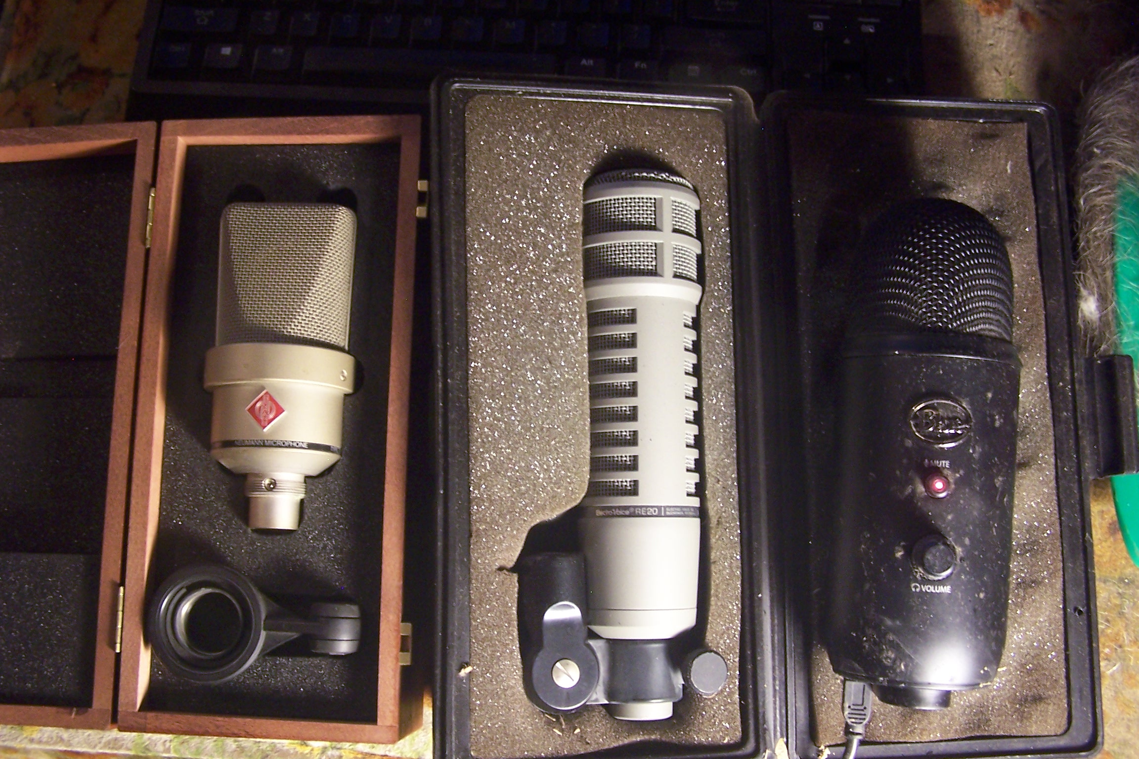

Heh...I have 2 RE-20's and two PL-20s here, and yup...but like always, "it depends". If I had a breathy female I'd use some condenser perhaps (unless she's also an air-shredding power singer with extreme dynamics) . The PLs are so numb...you can't overload one or the following electronics unless you try very hard, and the noise floor of the preamp is usually the issue (I used them for bass and other drums too...or a Marshall stack).
But yes, in radio station use, the PL sound is where all those liquid mellifluous voices come from. Nothing compares. Most preamps need an impedance stepup xfrmr to get the noise down.
You can guess what's in daily use, though...
The Neumanns come in the nicest box...the Yeti is the best per buck at least for good pattern(s) for video chats and recording acoustic guitar. It's a switchable pattern dual condenser, USB interface built in.

I just thought I would mention a bit more detail on the EarTrumpetLabs stuff that I brought up at the beginning.
They defiantly are condenser mics. If you dig, each version has a spec pdf like this one:
https://static1.squarespace.com/static/ ... Edwina.pdf
Which says: condenser, large (26 mm) diaphragm
In all the looking I did I never saw any hint regarding the actual cartridges/capsules as to whether they make them or buy from some other vendor. My guess would be the latter, but maybe they do it all. More control on the product and long term consistency if they do.
They mention some differences between models. They have some electronics. No Idea how much of differences are physical vs electronics.
