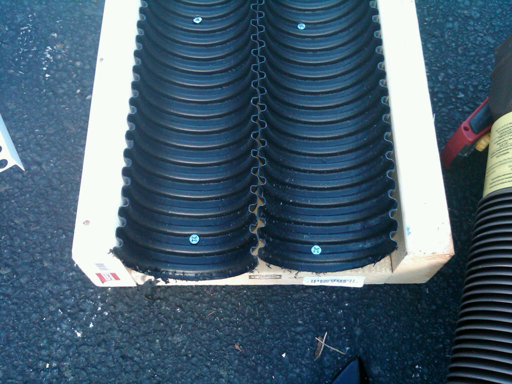

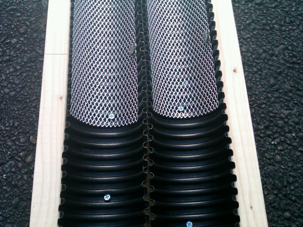

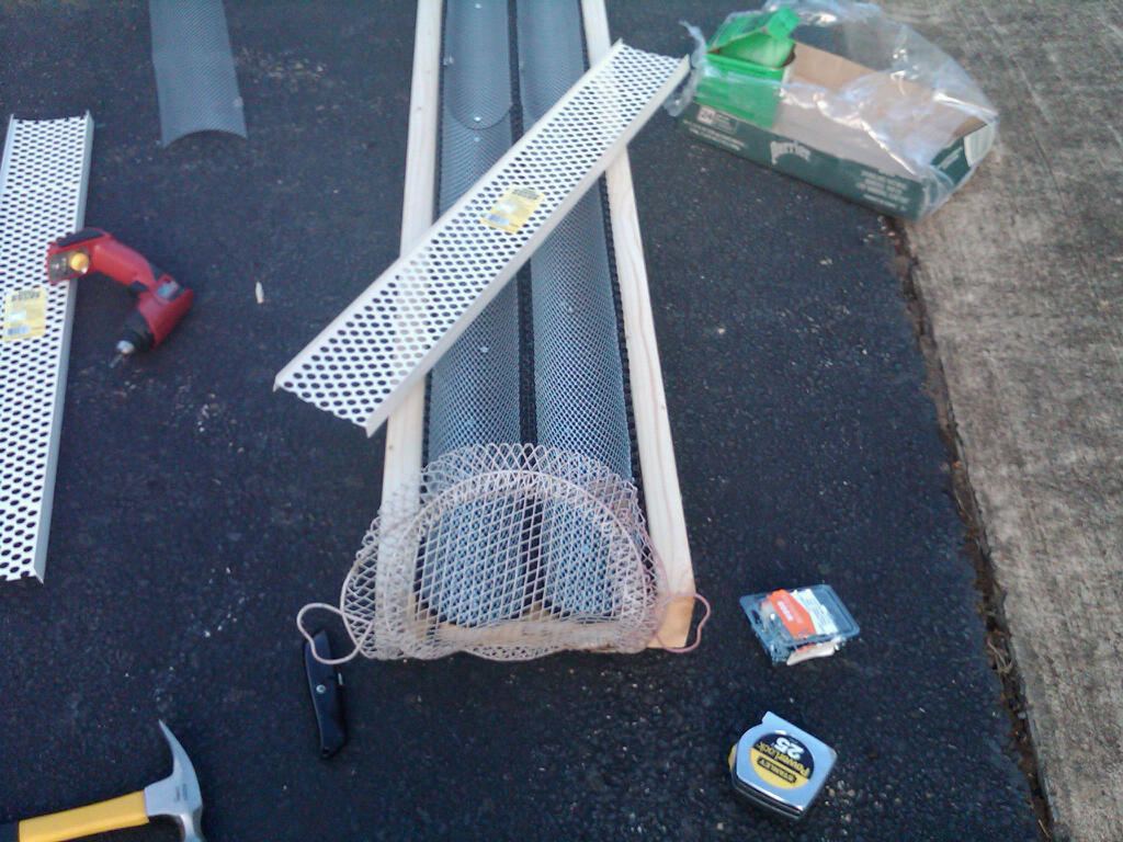

Hi, Just can't let the gold thing go. With the ever increasing prices and the need for hard assets, I think about it a lot. I also think about perpetual motion , but I know that's a loser. Toward that end, here is the "Lowes Sluice" or the "Home Depot Sluice" or whatever. I constructed this in about an hour with minimal tools and parts from the building supply (10' corrugated drain pipe, two 2X4s, one 2X10 and some expanded metal gutter guard) Only about half of it is covered in the expanded metal because I don't know if it will fill up the grooves and not let anything else in or not. I plan to deploy it on a non navigable, non fishable, stream that runs through the center of my property in Woolwine, Virginia (catchy name,huh?). I plan on leaving it through several rains and come back and pan its contents later. In this way I'll be able to determine from the contents if it's worthwhile to come back later with a high banker or dredge. That assumes the good ole boys up there don't shoot it up or steal it as they have done to stuff in the past. My question to you is this: Should I put an inlet grate on the front and cover it with gutter guard (shown diagonally) to keep big stuff out or just let it be open and let everything try to make its way through it (note: I plan to fill in the little "pie piece" gaps in between the pipes and the wood). Regardless, I figure there will be no less than a few branches, beer cans, or big rocks clogging it up anyway (assuming it's still there when I return) -bill
Lowes Sluice
Lengthwise split corrugated pipe in place
Expanded metal leaf guard in place

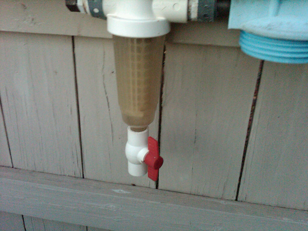

Cyclone Separator
