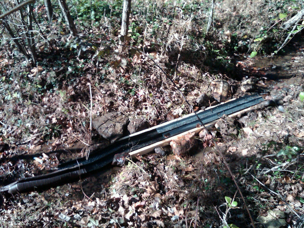

Long sluice in place
The long sluice also has a split open gutter drain attachment connected to one side. I did this because I was looking for different plug 'n play items that might collect heavy minerals differently. It has deep, more angled riffles (maybe rifes? not sure)than the drain pipe.

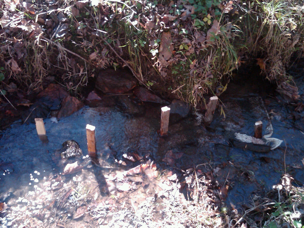

Golden Fleece
. Here is the Chris Bradley suggested "Golden Fleece" shag carpet. We'll see what it yields.

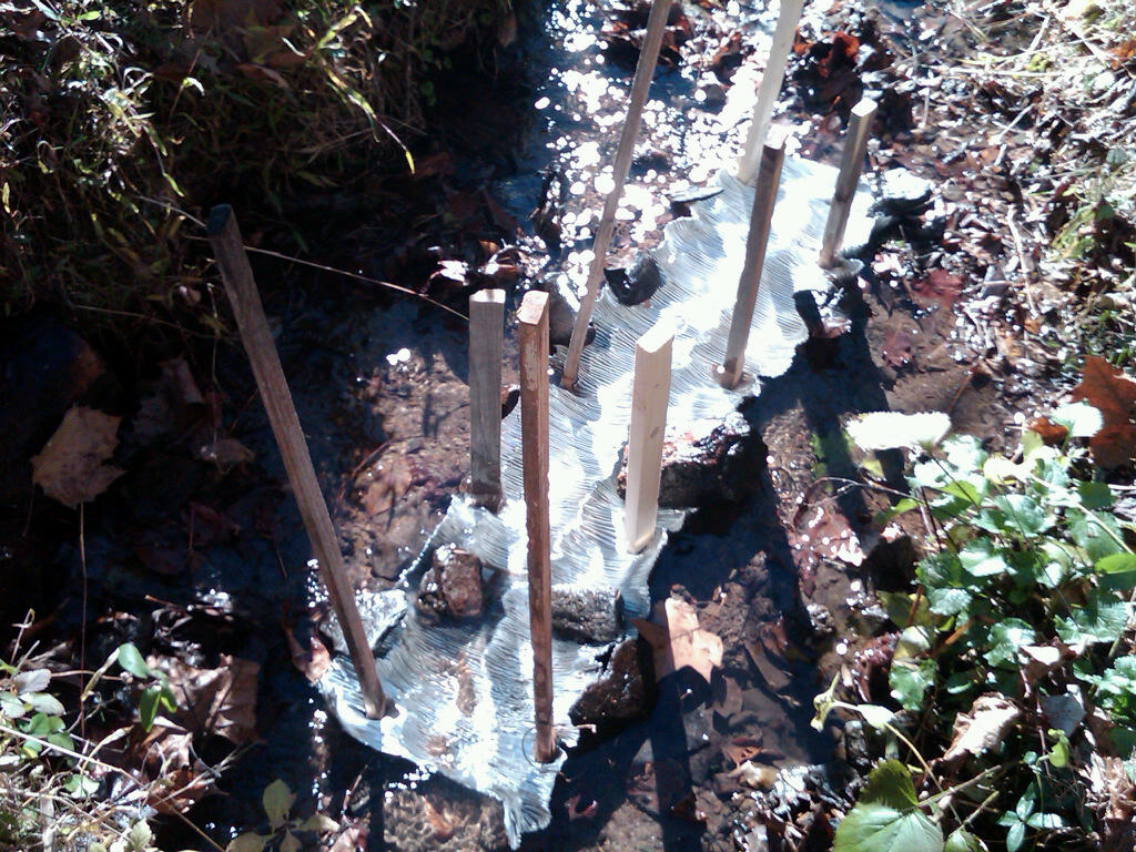

Dryer Vent
And of course, here is an old favorite: Flattened out aluminum dryer vent. Still I was looking for something with different sized and spaced riffles. This may be my undoing though; as it is highly noticeable and has some value ($0.55/lb) Now I would appreciate it if someone can suggest how I get the contents out of the long sluice; without pulling it up each time. Wet vac maybe? -bill

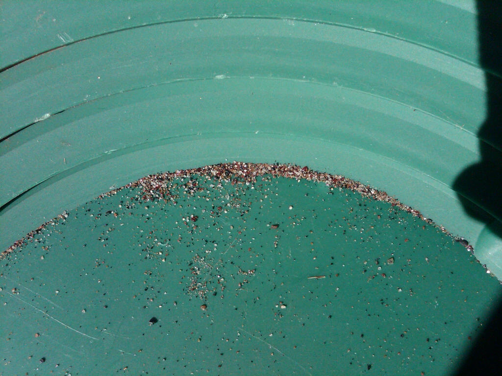

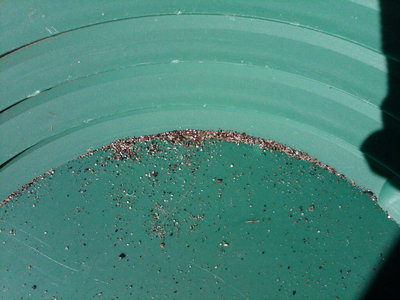

Hi, Just thought I show the contents of a small amount of concentrates I panned from Western North Carolina and ask a few questions. I promise to use a black bowl next time; as it has better contrast.
Pesky flakes of Gold
Notice a few "pickers" of gold. There is apparently a lot of "flour" gold too.

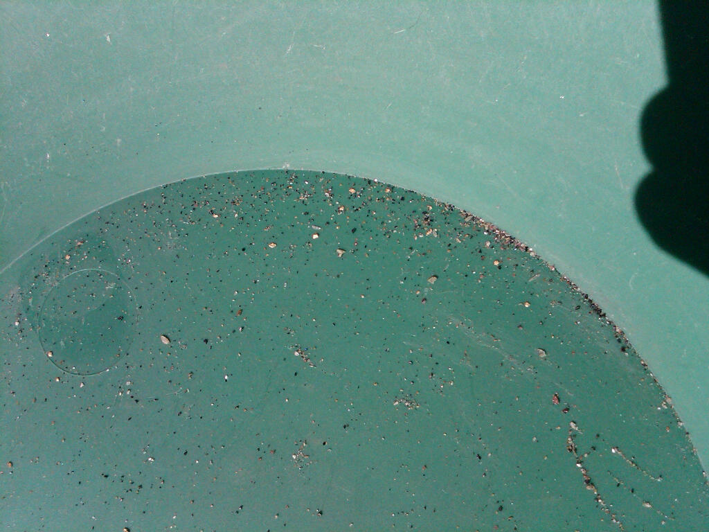

Stuff other than gold
Now this is the stuff that wants to be in the pan with gold. An experienced "panner" can wash this out easily. Now when I was up at Doug's the other day, I wondered if this was radioactive. We placed a small amount of it on the Geo pancake detector and got a count about 450cpm above background. So I theorize that this contains a lot of Monazite or maybe even Uranium. We don't have a good gamma spectrometer, so we don't know right now. Now these pictures were taken after I pulled out the magnetite with a magnet. (I could not detect anything much over background in the magnetite). With the high price, or more likely, the unavailability of rare earth minerals, I wonder if the monazite can be mined economically today from the creek sands. This table is not correct in that it lists some pure metals and I don't know at this moment which oxides or sulfates etc. the metals actually exist in nature. Also I need to get in touch with USGS or the North Carolina equivalent to find out what is actually in there. Of course with the fusor and a good gamma spec, we would know for sure. Here is a link to the rare earth etc. in Monazite.
