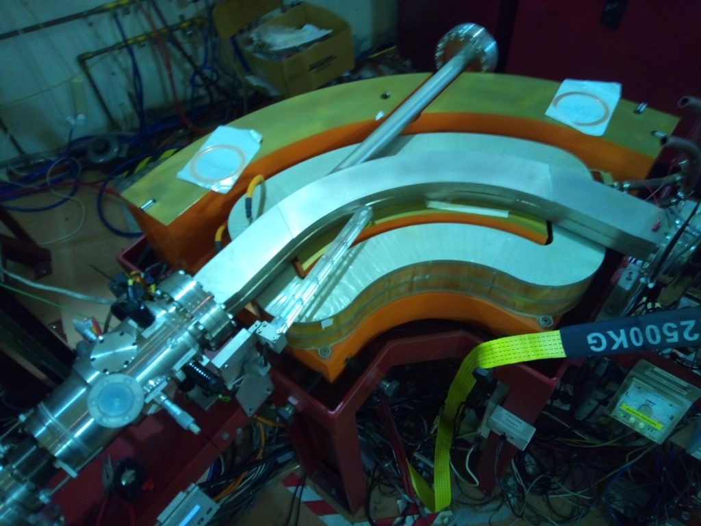

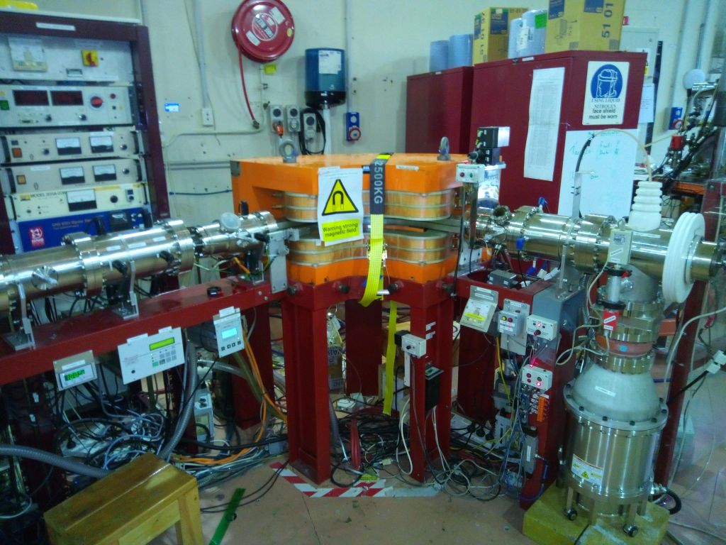

I took one of our implanters to bits to give it a Birthday
first few days dealing with the ion source and Einzel lens and then the bending magnet flight tube
magnet half = 1.25 tons power supply 6kW for max field across 50mm gap of 2.25Tesla 22500 gauss

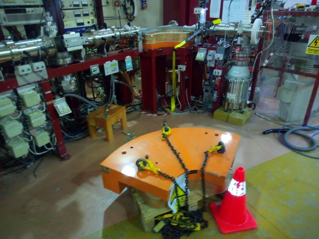

magnet halves separated
I then removed the flight tube for a deep clean
then all back together
