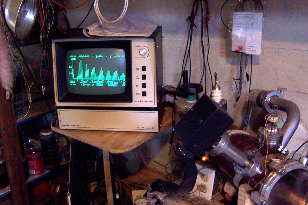

Bill's been at it again. The other day this pretty nifty thing showed up, and it actually works. Not only that, the manual was written by a person with English as their native language, and is for a change -- complete. Full schematics, and the thing is made out of stuff I can still get easily, but old enough to fix should it break. But, it's not broken! Needs some calibration, but that's a snap with a good manual, so I'll be doing that this afternoon. Here it is looking at my smaller system, which has been up to STP for a couple of weeks, so there's plenty of trash in it. Some of those "echos" will probably go away with calibration and of course, the system getting cleaner. It's baking now.
Mass spec in it's new home, Dycor/Ametek M100
I'll try for a better picture later, when what's on the screen is more impressive (and agrees with my gages). The previous owner had set the sensitivity way high.

Here's what it looks like now.

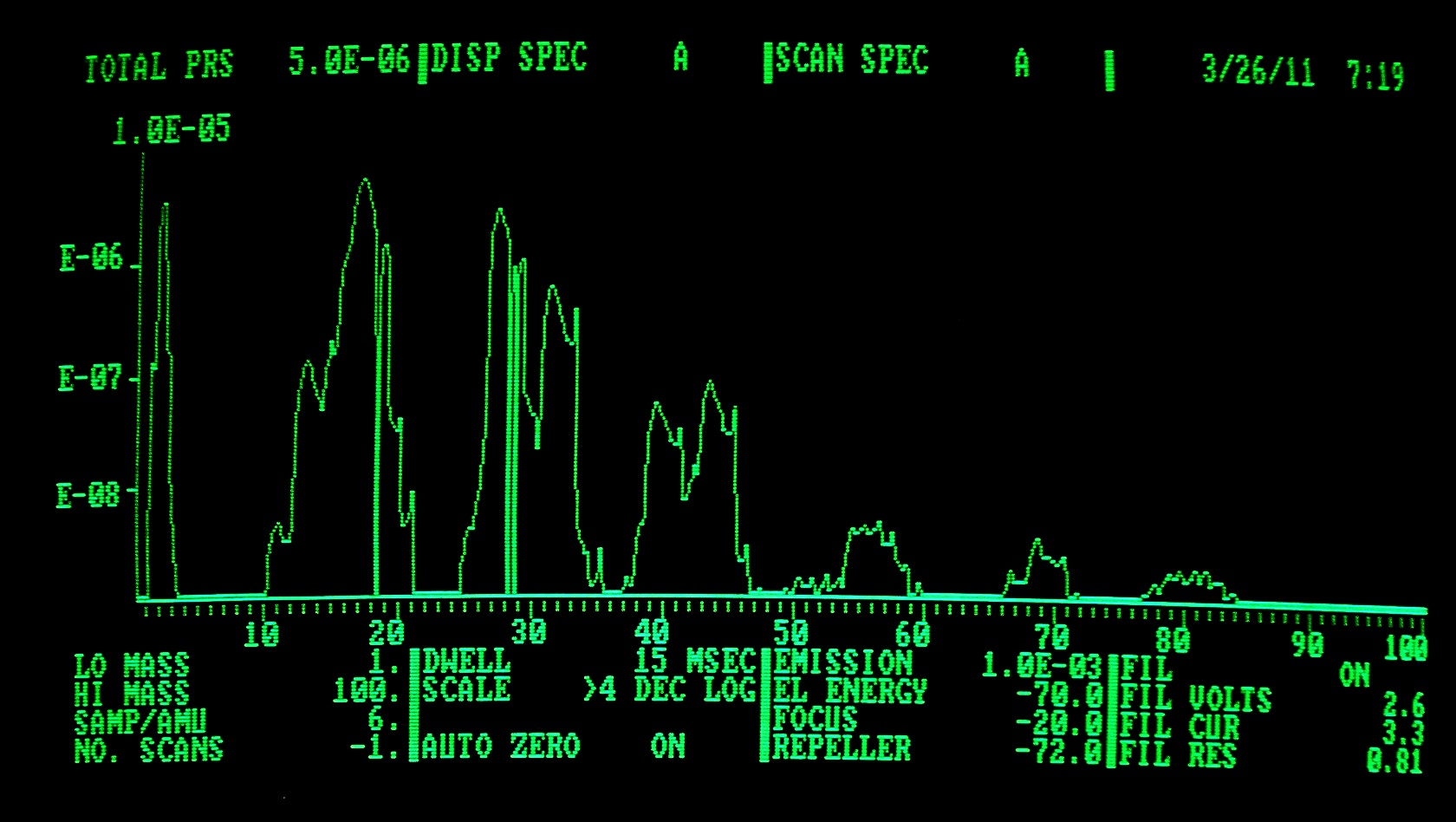

After some running and baking, in analog and 4 decade span mode
I can make it dwell longer and see deeper into the noise if I reduce the scan range. It will go to 15 divs per amu if you want. I think the downward spikes to the baseline are basically some magic nulls you get in this type gear, and that some of the mass one is "zero blast" you also get with quadrupoles. This is just good old gear telling the truth (no faking out the hardware limitations), or so it looks to me.
I haven't calibrated the gains on this yet. My other gage is reading half this thing's total pressure (couple e-6) and they had jacked up the gain to make the peaks read in torr instead of amps, or something like that. But, this stuff tends to be a bit relative, but I'll work on making it hard numbers for fun and giggles anyway. At least I got water on-scale after some hard baking. This is an all viton (many linear inches) sealed system with a tiny (60lps) turbo/drag on it - about the same as the turbo-only I'm also working up a good controller for. Not so bad, considering.

Hi, This is so cool! I'm really impressed it came through shipping and fired up so easily. I emailed the seller and asked him some questions before I bought it. He was real honest about it. This looks like something we can really play with and and not be afraid to. I'm trying to decipher what I see. I know water's there, nitrogen, maybe CO and CO2, what are 57, 68, and 80 likely to be? I believe there is some open source software that can tell you what you see here, but I guess that's like driving an automatic and we really need to drive it as a manual. -bill

I believe the heavy stuff is hydrocarbons, probably from the "sekrit sauce" grease I gently wiped the O rings with when I put this together.
Unlike say, a gamma spectrometer, in a mass spec there is more than one way to get a particular line, and one substance can make many lines. All sorts of things can exist at this level of vacuum that can't in normal conditions - they'd be too unstable. An H can (and does) grab onto anything, and so can most hydrocarbon radicals, which themselves get split off what's really there, then join up in dimers, trimers, with and without various hangers-on. It's no small trick to correctly interpret one of these, and it helps I've had this system all along, and had another mass spec on it as well, earlier on. Kind of like, you do this, and these new lines appear, or other ones go away, you get a "feel" for what's really going on.
In this particular case, when heated to about 75 C (more in places) the heavy stuff comes up, absolutely as well as relative to the other stuff, which helps with the interpretation. This hydrocarbon stuff is also the likely source of the unusually large hydrogen lines, as hitting that yellow hot filament tends to break the stuff up -- to recombine as it happens to encounter other fragments. I doubt I used 10 milligrams of my grease (forepump oil and beeswax, about 1::3 volumetrically) altogether, and it's been showing for about 2 years now. Fingerprints show through several baking cycles too -- but in this case there weren't many.
If I run a hot discharge in there, some of that might finally get out of the system. I will try it and see. The electrode I have in there now is all wrong for fusion, but opening the door and fooling around right now gives up all the gains of today, so it might be worthwhile to play with it some as is. Maybe I can get the horizontal scale setup with Ar and Ne, then play with new things in the tank.
