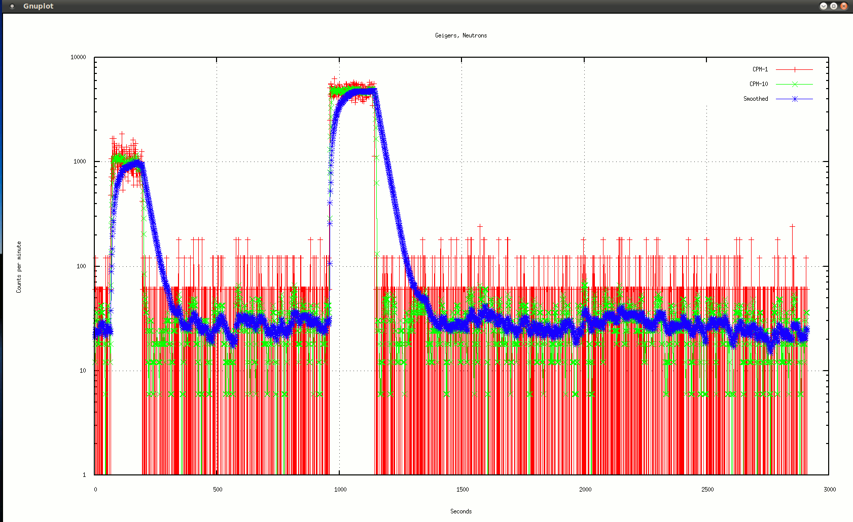

Screenshot of standard counter output with two cal sources and background. Log y
Software testing the output of the standard counter design. Red's the one second result, green is the simple moving average over 10 of those, and blue is a lowpass leaky bessel, off the 1 sec input, coef A = 0.03. Gnuplot is doing a lot of the work here. Most of the perl is finding the doggone thing out there on USB and pulling lines out of it, then changing them into arrays of numbers to plot, which is the sort of thing perl is good for.

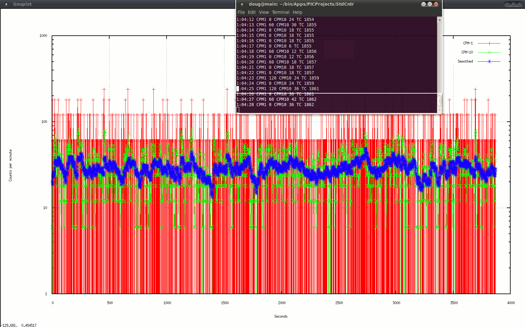

Here's another one. This could go on any of several threads, as it's about metrology, statistics, hardware, software, signal processing, but it's also pretty, so here it is.
An hour of background shown a few ways
This is showing the output of the standard counter for about an hour's worth, shown in a few ways. Notice the CPM-1 (red) can only show zero, or multiples of 60 -- that's because of the one second sampling time for that, on which all the rest is based. A time quanta if you will -- and during that time, you can only have integer numbers of counts. The green is a ten sample simple moving average of those -- as you can see, even it bounces around quite a lot. The blue is a simple bessel filter (same as an RC filter) on the 1 second capture data, one that takes a few hundred seconds to fully "catch up" when a loud cal source is put on the counter, as in the previous post.
Note that even that heavy smoothing has ripples and never converges to a smooth average, though with some eyballing you can get an average of about 27 cpm out of it (gnuplot helps as it reports the cursor position in graph units down in the corner). Also note that even with a bit of processing, when you just don't have much data (see the total counts on the terminal view), you just don't have much data to work with, and radiation, whether from a rock or the universe, is the most random thing there is.
A trained eye can get a lot of this by squinting a little -- see where the red lines are denser, and the other displays go up? But most of us like to have the power of a bit of processing, if we can have it, and here it's pretty easy to do.
In the previous post, you can see that when a medium hot source is there, the "simpler" outputs get a lot "quieter" and more smooth all by themselves -- the power of statistics once you have enough data does this with no meddling required. As these are log plots, you are really seeing the signal to noise ratio whatever the signal is at the time, and these are quiet enough with no source that you see how noisy a low rate random event string really is. This is why it can take a long count and careful use of math to see things near background and be sure about it -- the background itself is moving around a lot. There are of course tricks for when the background is mostly coming from "up", such as using another counter in anti-coincidence, but even that reduces the basic data rate -- and the result is still noisy, maybe even worse! Luckily for the intended use of this thing, silver isn't hard to activate to over 500 cpm (which really stands out in a non-log plot) for at least the first few ten second intervals. And indium, while it doesn't get as hot for the same exposure, lets you count a lot longer to be sure of the increase over background better. Should anyone start making really significant neutron counts, we can move to gold...
And yes, down the road, we'll enable some curve fitting....silver, with all the possibilities and metastable states is going to be interesting indeed when exposed to that, there's a lot of cooks for that stew. Indium should be more boring...
Now that I've got this in a box and can carry it around without worrying I'll break it, I'll try a fusor run with some Ag and In and see how we do with it, and compare to our previous standard, which was about twice the sensitivity for X rays, but maybe not that different for betas. Nothing beats a guess like a measurement, though.
For those who don't know how to do that bessel filter in math, here it is.
Coefficient A is .03 in this case. B is 1.0 - coeff A. You need one memory location, I call the accumulator. The math is like this:
new value of accumulator = new input * A + old accumulator * B;
And that's all there is to it. This leaks 3%, as though you had 3 percent of the series R in series with the cap, instead of taking the output off the cap top purely. Breaks of the game, the pure bessel is a little more complex to compute. This one nicely has a gain of precisely one, and can be augmented by various logic tricks to make it track in quicker when it's way off in some situations.
For those who might worry that we skip counts on second boundaries, no, we don't. The counter is hardware and just counts, we read it at one second intervals and never reset it. There's a hardware re-sync flip flop buffer, so if we miss a count that "belonged" in one second, it just shows up in the next sample. Being 32 bits, it should be enough....

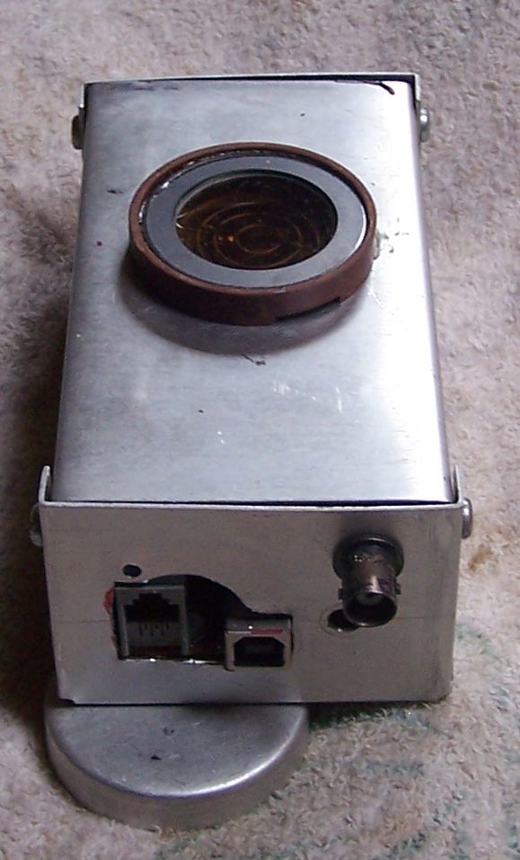

Current WW prototype. Big and ugly, but built to facilitate trying other things with the platform.
For those who don't know -- Joe and I are both working on this one (and several other projects), and plan to have a little company to produce these and other things useful to amateur scientists like ourselves. We don't expect to make a lot of money at this, it's more for lulz, and because we realize we're pretty good at some things others don't have the time to acquire the skills for and do for themselves, but merely want to get on with whatever their own research is -- without paying the normal insane industry prices for gearing up. For those who remember Don Lancaster's SWTP -- boards and bags 'o parts, or built units, that's kinda what we have in mind here - facilitating other's work by making some things a lot simpler and more affordable. We just have a different focus than Don had, in our case a smaller market -- and somewhat more sophisticated gadgets, useful to physics people rather than audiophiles. Look for more in the future. The next thing on my plate is to do a good vacuum station controller for those cheapo Pfeiffer turbos (I have 4 of those, thanks to BillF) and whatever forepump you've got, with some unique capabilities, as in fine gas flow/pressure regulation for processes like fusors, accelerators, ion sources, and sputtering to be controlled, and logged if desired. We have a few more things on our short list (for example, neutron detector tubes and the equivalent to this but for neutrons), but....with just two of us, it's a good idea not to divide our attention too widely just yet. We'll get there.
