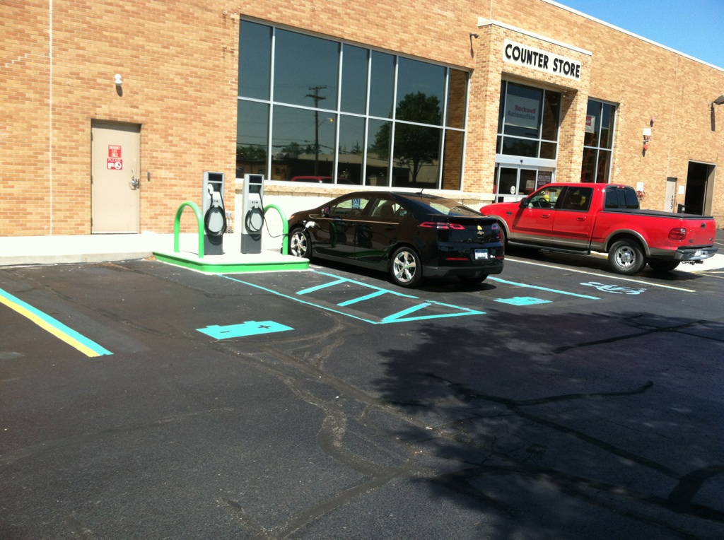

Postby Joe Jarski » Wed Jun 27, 2012 2:28 pm
I was at a local electrical supply house yesterday testing some vision (camera) measurement systems for work. Anyway, we left from a different door than we came in and I noticed a Volt on the charging station in the parking lot. It's the first one I've seen in person.
Volt charging station
Re: GM's new Volt
Postby Doug Coulter » Thu Jun 28, 2012 4:00 pm
Neat, a lotta people like black, I'm just not one of them - too hard to keep looking nice for me. They are selling pretty well these days so we should be seeing more of them. Not quite as sexy as a Tesla model S, but then...you can't take a road trip in one of those, really (and they do cost over twice as much). But wow - at least Tesla knows how to make an advert.
