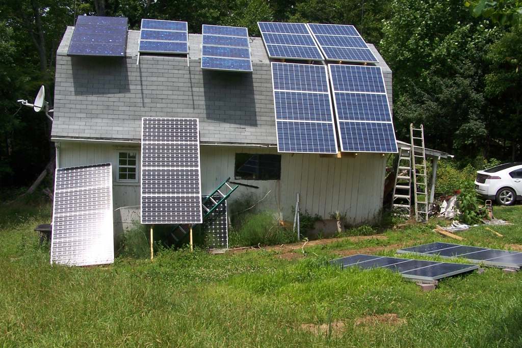

Still a work in progress. Now that it's cooling off enough to be on a roof again, we'll rent that crane again and finish up. The current state looks like this:
A mess, but one that works well just like it is.

This replaced such a system. I found adjusting for time of year too much trouble, personally. The issue here (that doesn't show in the pic) is there is a line of trees to the south - my "hedgerow" between me and the road, that I don't want to cut down, so I really need the panels up in the air - it's made a huge difference compared to the mere 8-10 feet I could get on the ground racks. Now that it's cooling off, the rest will go up there on the roof.
There's a secondary advantage to this - there is one huge convection current going on under the panels, which cools both them, and my roof. Despite 6" thick insulation, I can run around with an IR Thermometer and really see which parts of the roof are under the dual-angle rack - it's a 10 degree difference on the indoor side. As a bonus, in the winter I can stuff this channel with foam rubber and have an insulating air pocket if I want. The summer wind through that channel created by the 2x8 is such that it will blow out a cigarette lighter even when the prevailing wind is from the north! It's pretty impressive.

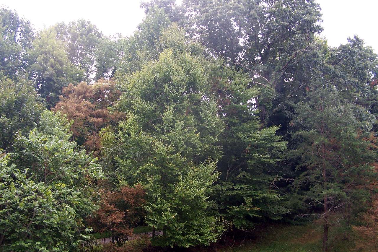

Remember, I don't live in the desert, rather the opposite. Here's a view south from standing in front of the building.
View south from the ground in front of the building

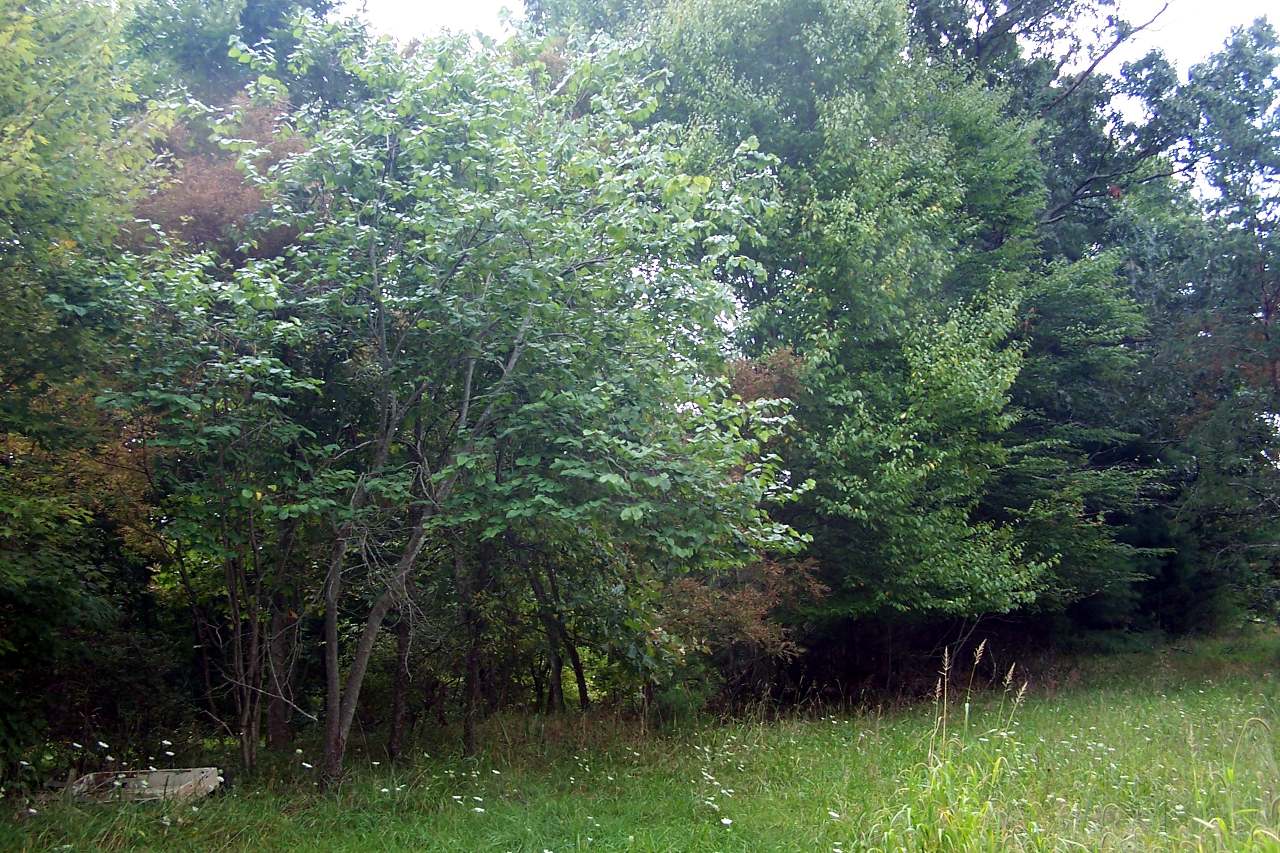

And here's one from the peak of the roof on the left. I actually used the top panel to rest the camera on to stabilize it.
From above the roof peak
Since I live well north of you, in winter the sun doesn't rise above those treetops...most of the winter. And some of those trees take forever to lose their leaves, despite I've cut down the pines.
But there are more tall trees on the other side of the road I don't own - so I'm stuck with what I've got. This is actually the best solar site on my land except way in the backyard where it's not very tenable in the summer - big south facing hill, but...either not enough breeze or too much wind, and not that easy to get to.

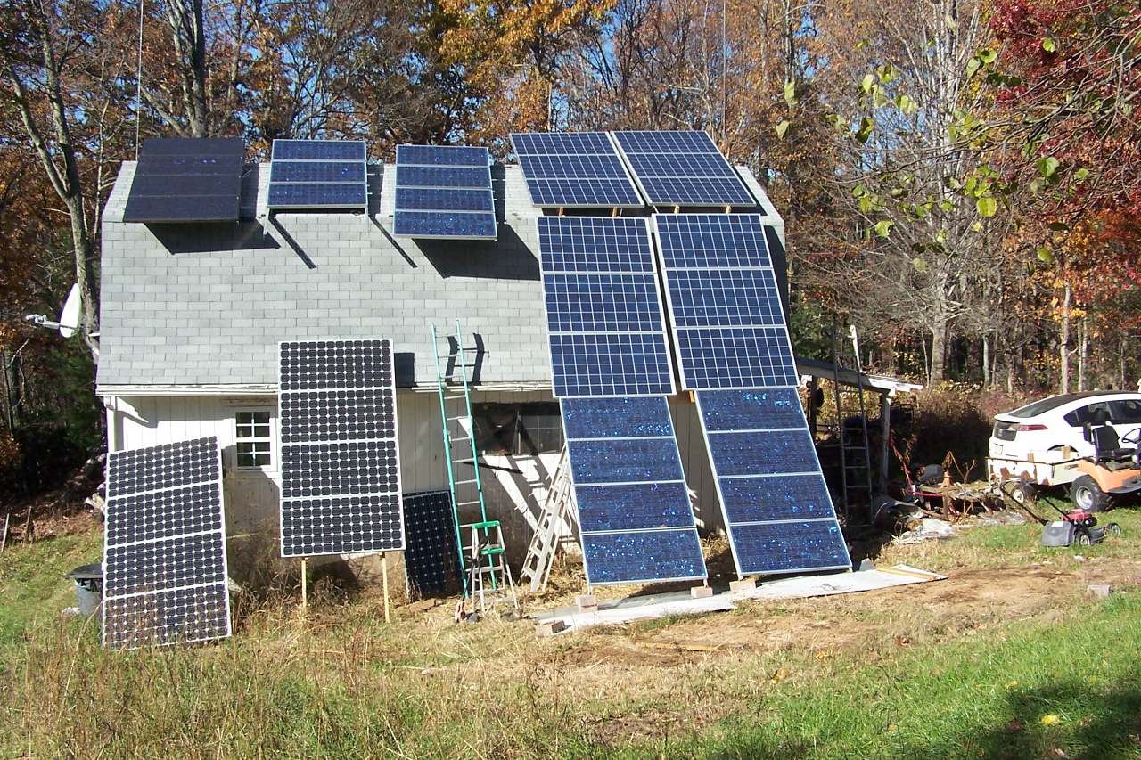

Slight improvement. The interesection of worthwhile weather and available help has been a null set of late, but no way was I going through winter with two racks of panels laying flat (north facing a bit) in the garden, so a stop-gap had to be done. At least this way we get something out of them, and those sparkly multi-crystal panels are the best performers in cloudy weather when the light is coming from all directions.
Stood up the older panels
Next time there's a chance, those black ones leaning on the wall get the middle position up on the roof, like the ones to the right (except, this time they'll be put on straight). Those two that aren't even wired in, I've bought some more angle etc and will hang them off the similar ones on the left - not sure yet if I put them above or below the existing ones. Those BP panels rock too....want to get all I can to keep my Volt all-electric numbers high in the winter, unlike last year when I was forced to buy a fair amount of gasoline for it (lifetime - 95 mpg, since January this year, 182 - and increasing).
Looks like behind those I just stood up, I get a damp shady area in spring so I can grow cool season crops up here there. I used to have to attempt to maintain a garden down by the creek to do that, but the hungry critters managed to evade even 6' tall tight chicken wire fence and buried fence to 2 feet deep, it kind of wasn't worth it. It'll be nice to have peas and spinach and carrots again.

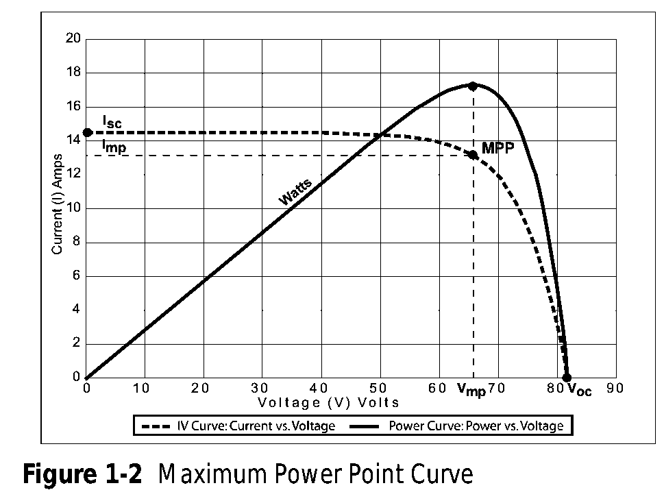

Here is a typical curve of solar panel output vs voltage under standard conditions:
Solar panel curves
Another benefit no one seems to mention is that in very low light, a 30v nominal panel may still be willing to make some fairly decent power at say 19v. So hooking a bunch in series with an automated max power point regulating controller gets you about another half hour at each end of every day of at least some useful output.
In my system, both battery and panel temperatures are monitored to keep everything as happy as it can be. Batteries especially will be ruined by overcharge when they are hot and "want" a lower terminal voltage.
