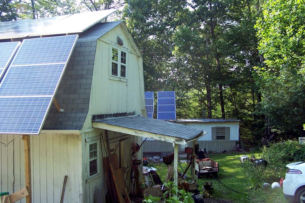

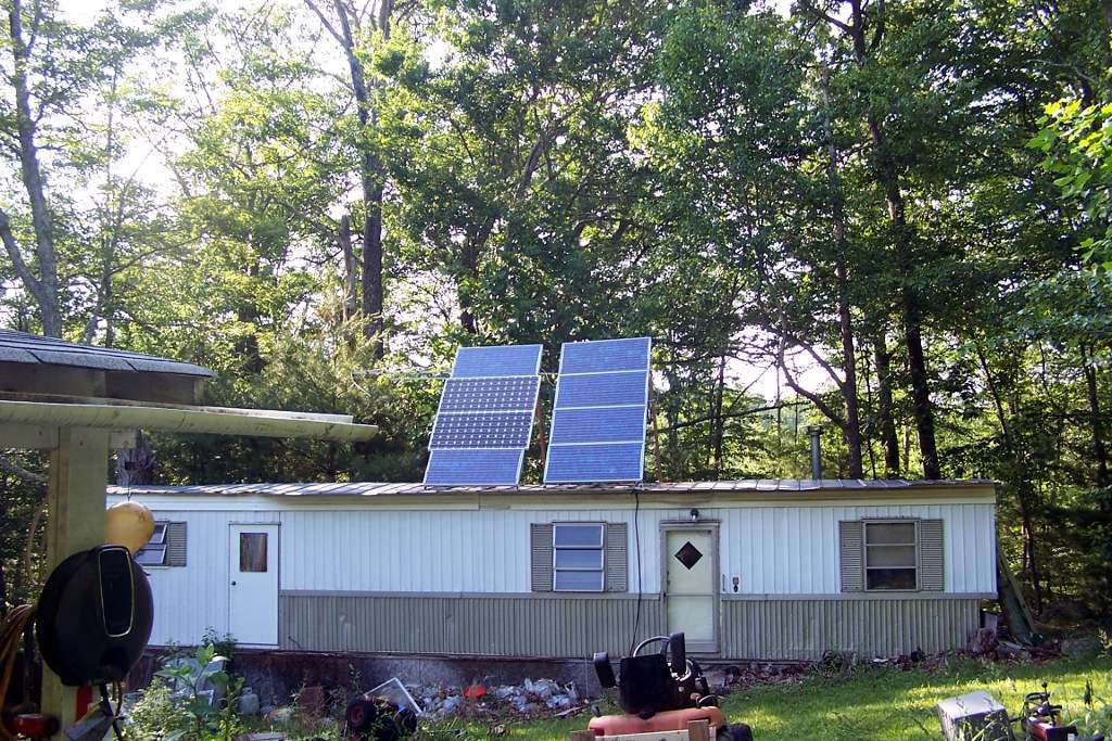

Finally finished! After doing the main building, and leaving a bit of room there for a possible hot water solar heater - we had two racks of mixed/older panels left.
The arrangement that had them hanging off the main building panels to the ground didn't work so well - snow, too low, and so on. So we put them on what we call the "office trailer" which is to the north of the main building I live in. Despite being lower in altitude, that spot gets sun in winter when nothing else really does, simply due to the fact that it's that much farther from the treeline to the south - some of which I don't own, so I can't just cut them down (and don't want to cut down the ones between me and the road - privacy and dust control there).
So. Now it looks like this:
The last couple racks. Mixed panels. The blue ones are over 30 yo - but they do better in diffuse light than the newer ones do - accidental result of "specsmanship" on the manuf's part (BP).
To put things in perspective, I took another pic from farther to the south.
Viewpoint that takes in some of both systems.
These added panels aren't expected to do much in summer, when I don't need more anyway, most days. But in winter - they get sun the earilest and for the longest, and outperform in diffuse light, which is what we usually have then. Further, that trailer...needs shade on the roof, more than it had, or it becomes fairly unbearable in summer with just fans. Yeah, it has an air conditioner, but we restrict use of that to a few days a year when it's REALLY unbearable - and that's not many days, maybe 6-7 out of a year, when it's over 100f and about 90% humidity. Even I give in at that point.
H/T Mark Thomas, who helped with the heavy lifting and holding. This was actually a little tricky, as we'd placed these up there when we had the crane. They are longer than the part of the roof that will hold weight is wide, so it was a bit of a dance (actually a very accurate jump) to get someone on either side of the racks to lift them up to the angle they are now at. This is not a place you want to miss and land into some very expensive glass! Nor can you just lift one of these aluminum racks from one corner - things will twist enough to destroy panels. But we managed, and at that, by lunch time - and Mark and I celebrated with Margaritas and steaks...He more than earned that, also digging the wire trench (along with some pay, I'm not a bad guy to work for, which is why I get so much help I guess).
Even in the dark (pic taken at 6:30pm, and sun behind the panels) they put out 35-40w. They should do a few hundred in real sun, and most importantly, on those gray days of winter when we need it most.
