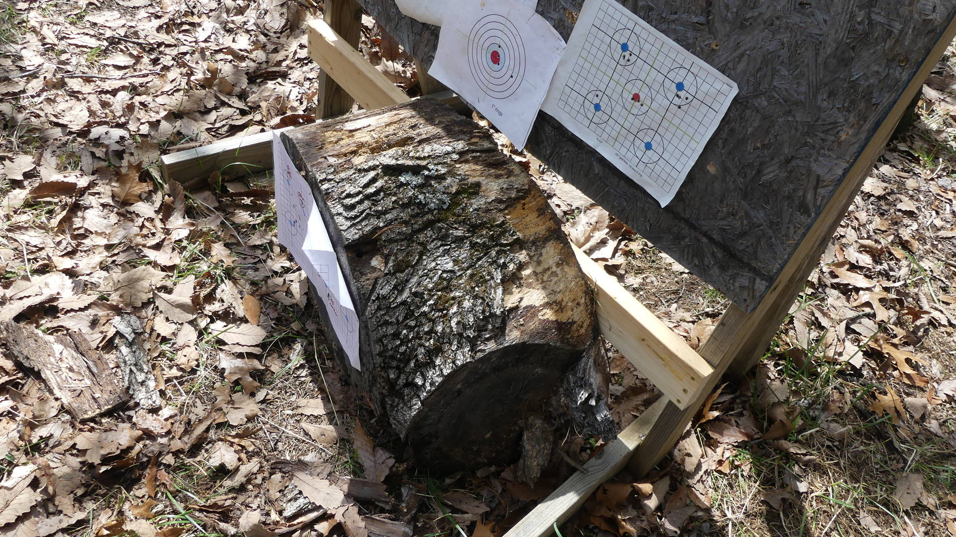

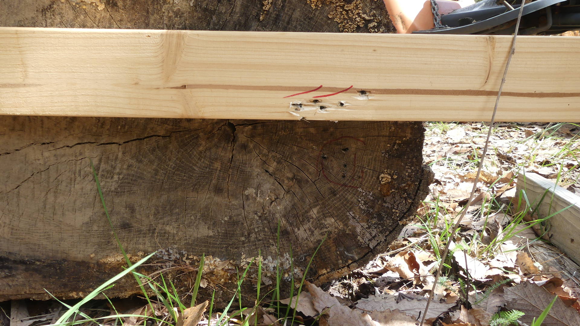

I also discovered how unreal the penetration of these cast bullet is compared to jacketed ones. In this picture of the back of a thick oak burl that my hyrdralic splitter couldn't scratch... all the lead ones went right through (and some through a 2x4 after that) - and none of the jacketed ones did! Jacketed were Win corelokt 120 gr in 6.5 (around 2.7k f/s) and sierra 53 gr (around 3.3k f/s) in 223.
The cast load is right on 1600 f/s and is only 20 gr of Varget - the jacketed 6.5 load is 40 gr of Varget (and still not a max load by any means).
Oops, they go right through!
I had, um, put that stump there to catch the jacketed full power loads because I didn't want them to skip off the ground and maybe go over my border...turns out the lead ones were the issue if any.
This is a fairly stout piece of oak - yeah, it's not super thick, but like I said - my splitter wouldn't touch it, and it's from a huge crotch in a healthy tree.
side view - stops the hot loads easy!

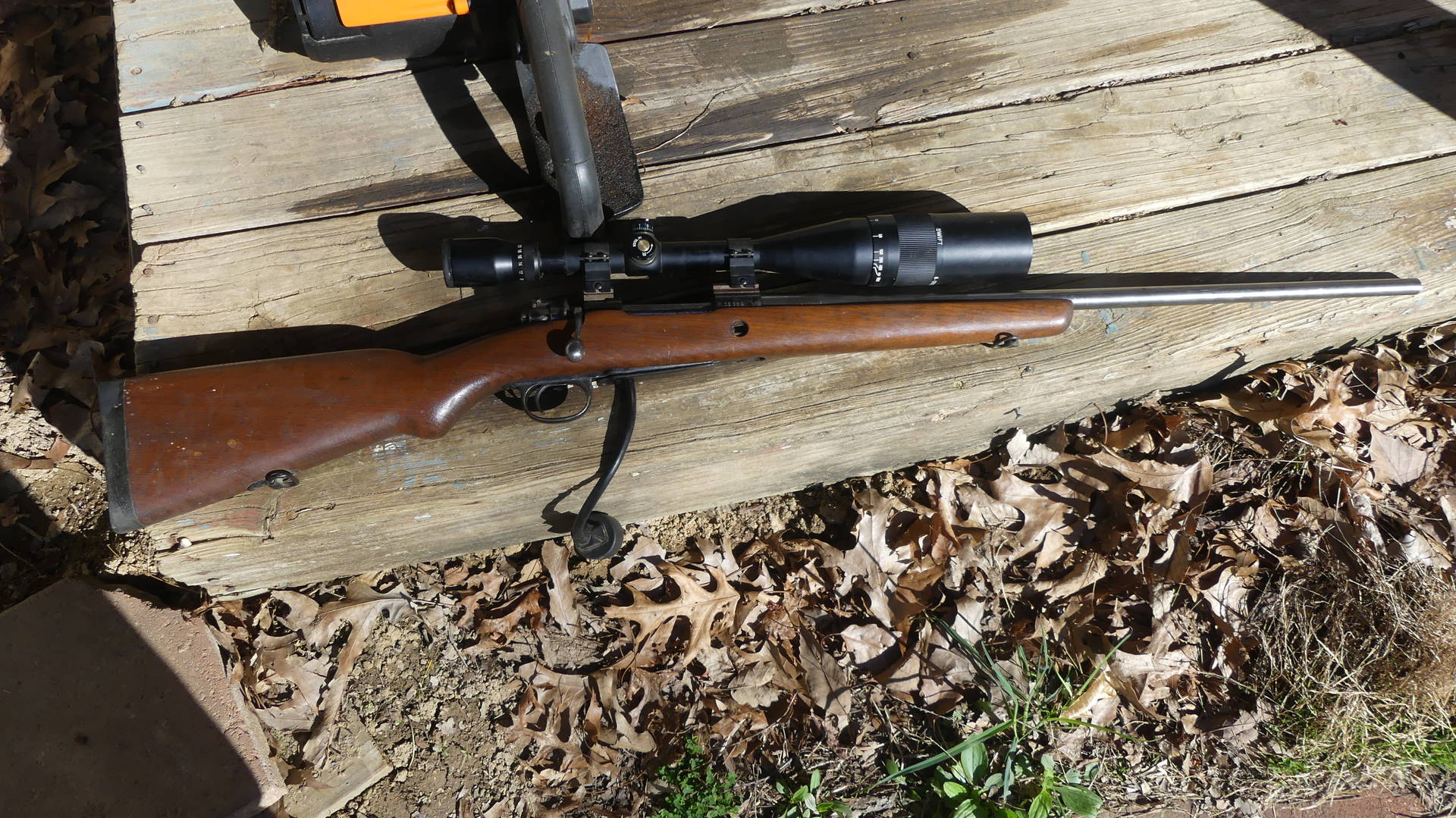

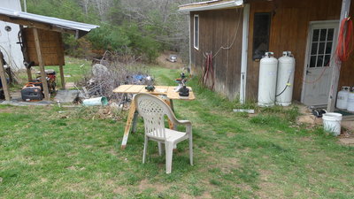

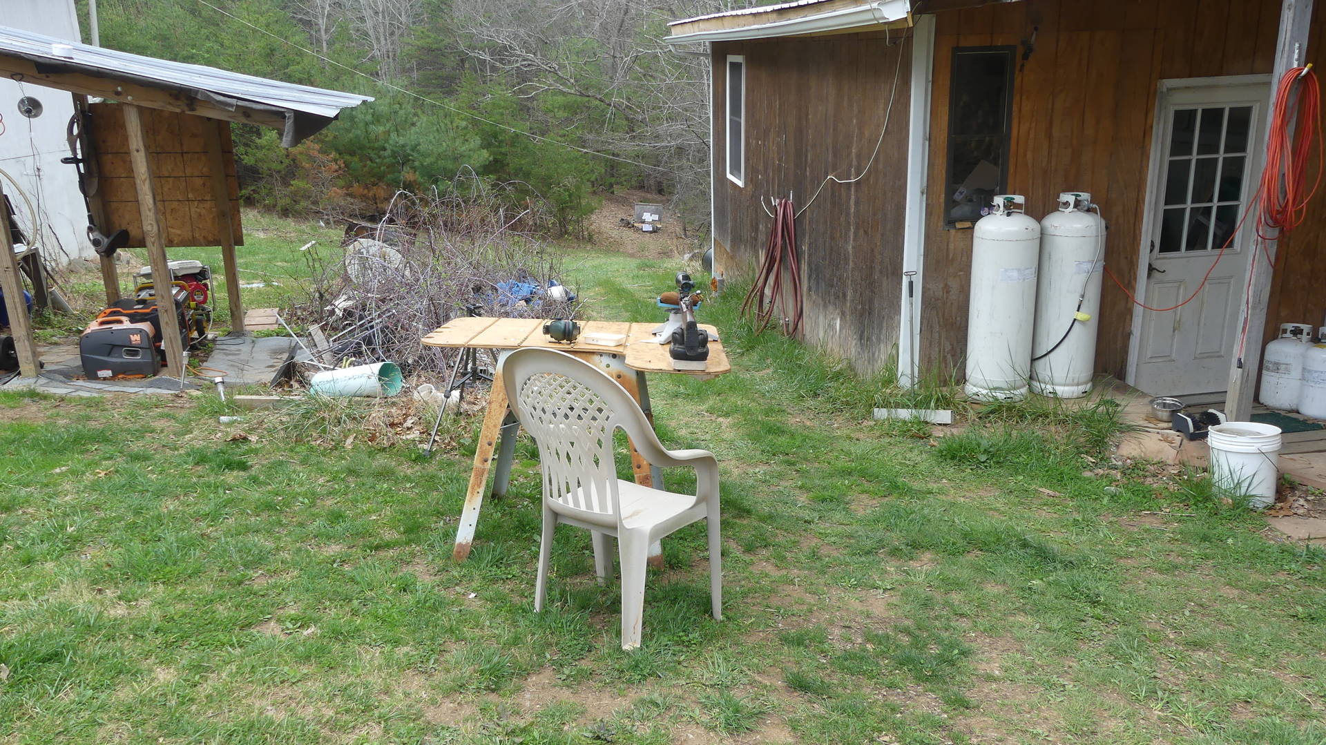

The range I'm using - nothing special other than you should be jealous if you don't have one like this (or the big one in the back). Makes this work easy and more fun. Shown is the gun I expect the least accuracy or looks from - This is a good one to make any mistakes with. I shortened a Douglas barrel because mud wasps had made a nest in the end, and SS does rust if you leave things like that in there long enough.
I can miss my house from here.

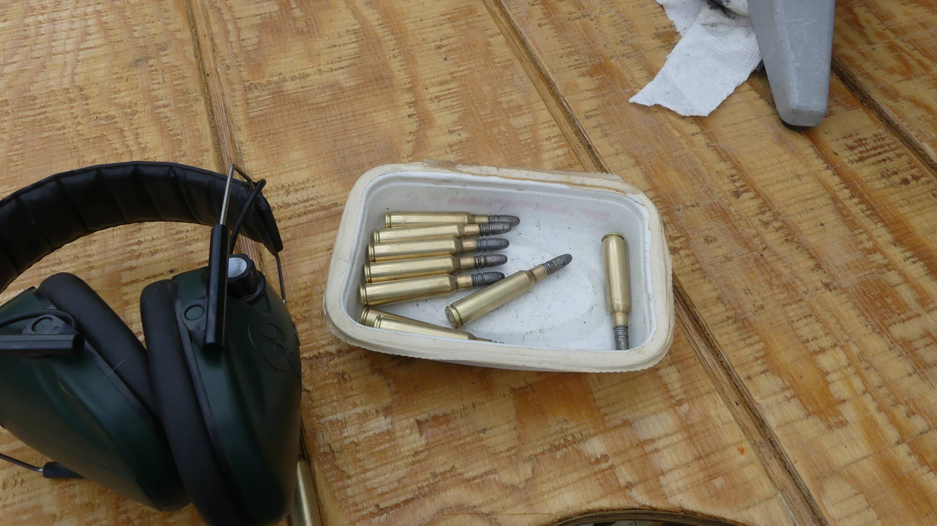

The bullets I'm testing - these are roughly at the lands due to very blunt tips. Jacketed ones have to be a little off the lands to go through the magazine, or for that matter, be in the neck of the brass.
Same results with FLR as with fireformed brass
- I got this chamber perfect.

The front of the log.
You can see the .223 group - none of those went through - since this gun puts that load all in the same hole at 200 meters...I guess I wasn't on form, but then again, it hadn't been fired in 2 years, so this isn't bad from a really cold and old bore.

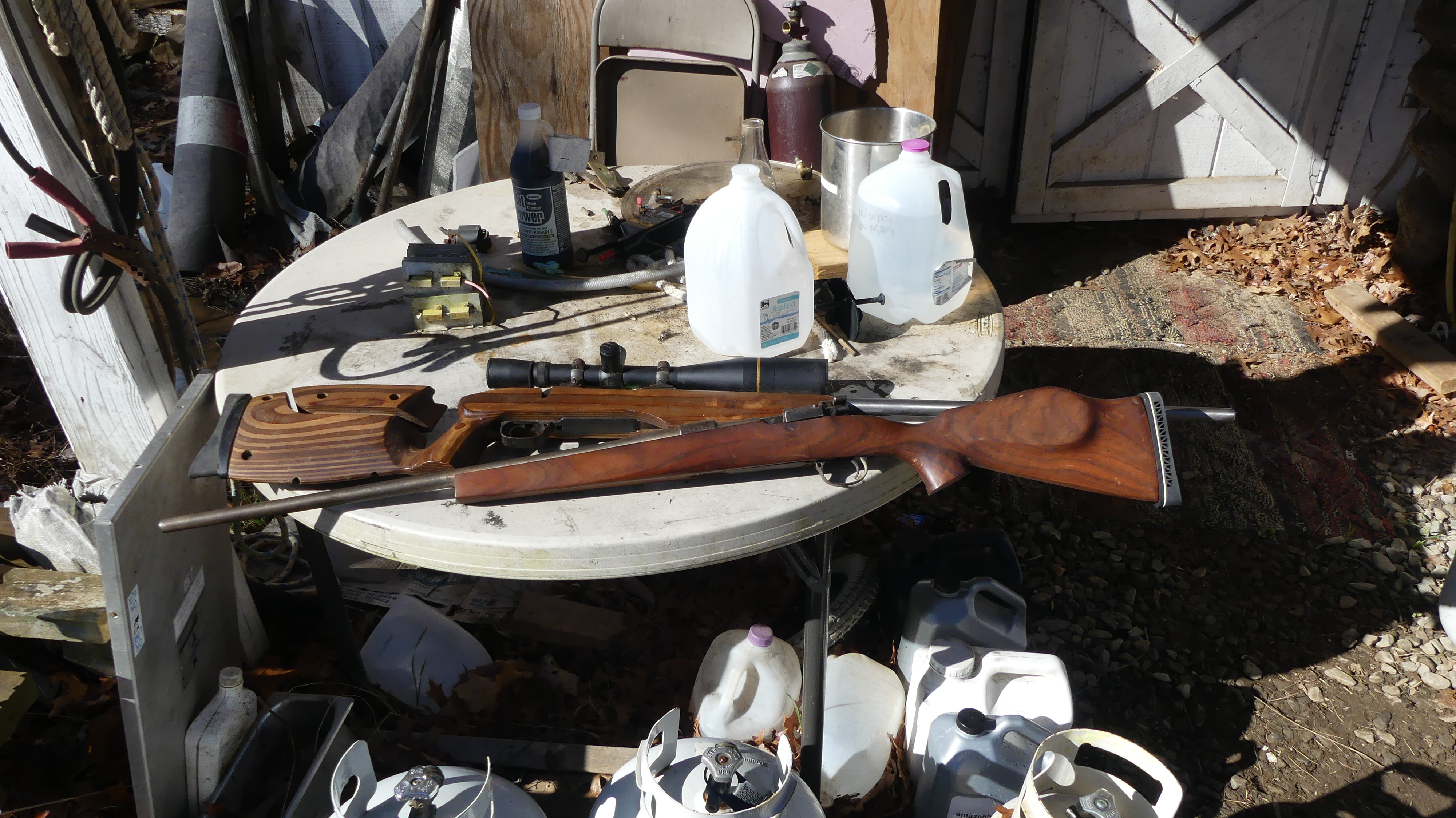

Soon, They are works in progress, this one is particularly ugly right now...There are half inch gaps in spots where the inletting in this surplus stock didn't match the surplus Czech M98 action...and so on. I'll be fixing some of that with dyed bedding. It'll never be pretty, but gee. One of the others is going to be a beauty queen fer sure. The 1907 original Swede is...what it is. And the one with the fancy handgrip stock looks like one of those, but I'm butchering it with saws because - the forend was so rounded it tended to jump off the bags and the bench as soon as you let go - bzzzz, now it's flat. And the length of pull on the fancy adjustable buttpad was an inch too long at the shortest, so...zzzt, that's going to be cut off...and so on. I mostly go for guns that shoot, if they look nice, that's a bonus, but if they're downright ugly, well, I show the targets!
The plan is to change a couple of these into a couple thousand bucks once they are at "aspirins at 400 meters" goodness. Shouldn't be too hard. I've pulled this off a couple times. You just go win a match, or almost after blowing like one shot - then say you're disgusted and the thing is for sale. Guys walk up with rolls of dough and start peeling it off...."I'll keep that nice scope, but OK".
Here's a teaser of the chassis gun and the purty one before I fit the recoil pad, make a scope mount, and finish the wood. That one has a "sleeper" cheap A*B barrel that 'just happens" to shoot insanely well after only a few tens of hours of lathe work on it and the action.

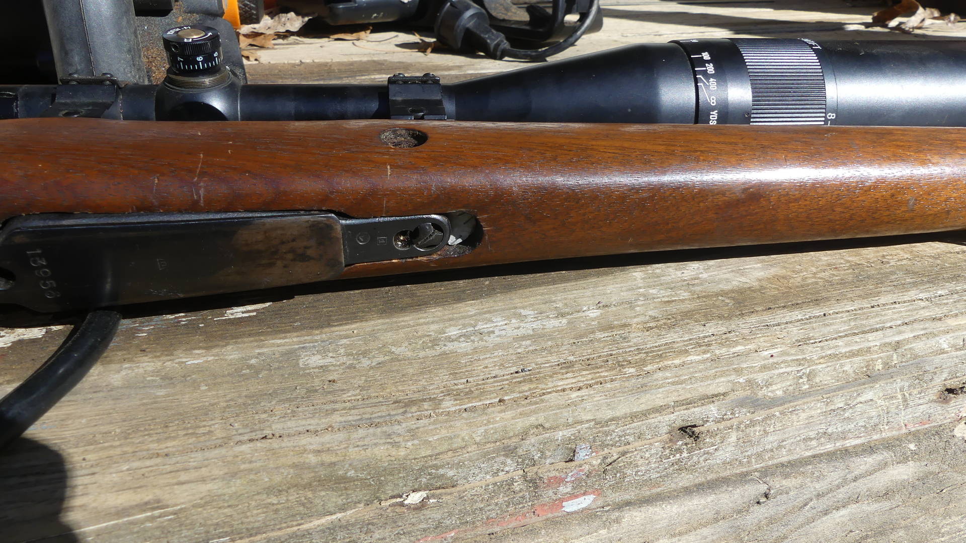

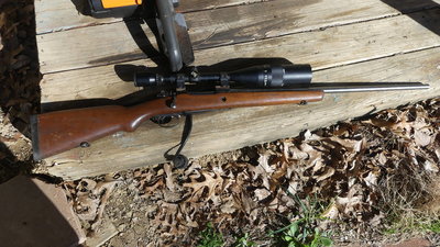

Here's the one I'm working on, warts and all. I expect this to be the least accurate one, but it's also the most practical one to carry around, perhaps, being the lightest. It'll be as good as the 3-9x44 scope it's probably going to have in use.
Aftermarket bolt handle weld is bent, and it's an insanely bad fit on what was a pre-inlet stock. I had to carve the crap out of this to make it go in, and had to remove the cross bolt for the recoil lug (there's another one in there now, glued in, but it's not touching yet - there will be glass bedding...someday).
Here's the ugly one.
Did I say badly inlet? Holy crap. But it was a way to get the rest going and tested. If I like it I can always get another stock.
Rather a mess. I made a little shim to plug the hole so bedding wouldn't drip out when I apply it.
