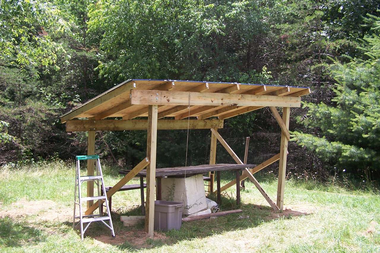

I'm lucky, I have a lot of land. So I have not just one, but two shooting ranges. The one "in the back" is the larger, and recently we upgraded the tent over the rifle bench to a real shed roof.
New bench

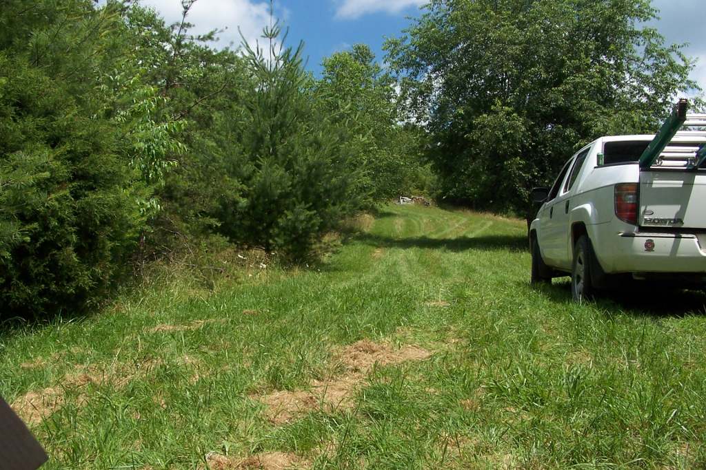

Looking from the vicinity of the bench downrange:
Have a whole mountain for a backstop.

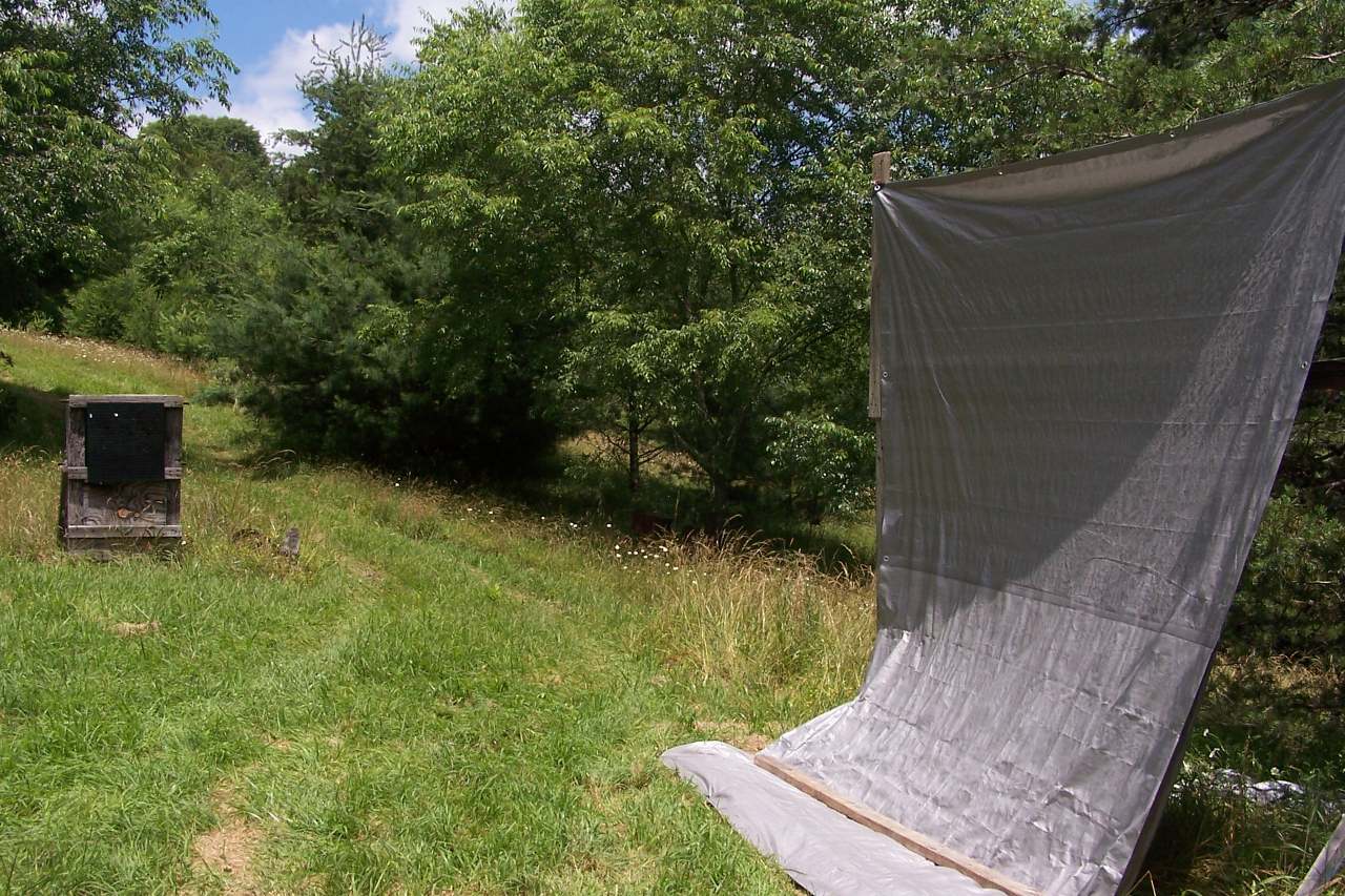

Of course, even though I don't rate for competition, I shoot handguns too:
Handgun backstop with brass catcher tarp stand
