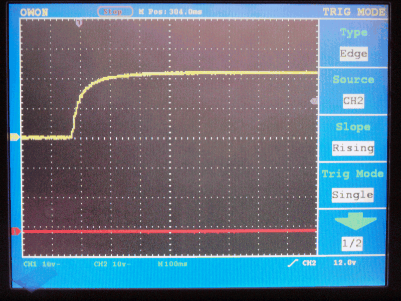

I think I'll 'scope it, just to check (and also to check whether my meter might be getting confused by the underlying 50Hz signal). It might be less .. or more than the value I was reading.
But in this particular circuit it is very unlikely to be high on switch-on. It is driving 5 DC cooling fans, with a combined draw of ~2A, so when they are cranking up as the voltage comes on, [I reckon] the volts are sure to be pulled low.

Postby Starfire » Tue Jan 31, 2012 2:00 pm
You will need a very fast scope to see it - the first spike is only a few pico-sec but the rated voltage can punch the dielectric occasionally.

Postby chrismb » Tue Jan 31, 2012 3:08 pm
No spike here, John! 8-)
Actually, looks like I seriously overdid the capacitance. Can't see any ripple voltage at all! Maybe the inductance of the multiple motors it is driving also serves to filter the voltage content.
