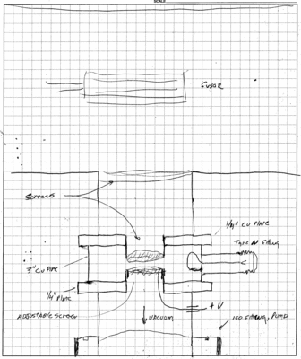

For this sort of thing, what you want is an E field that a lot of volts/meter (concentrated) for the amount of power input, crossed with a static H field at the cyclotron strength for electrons at the frequency in question. For 2.45 ghz that's in the 980 gauss range, not too difficult for modern permanent magnets, even over a fairly large space. But getting a high E field to power ratio needs something more than a waveguide. In the previous design we used a quarter wave tuned line to get high voltage at one end. In this design, I'm going to use a re-entrant cavity for that purpose, and build the thing right into the ISO nipple between pump and cylindrical tank, leaving the tank innards as pristine as possible. The idea here is to have it close, straight shot for the ions to get into the tank easily, and simple (at least in appearance )

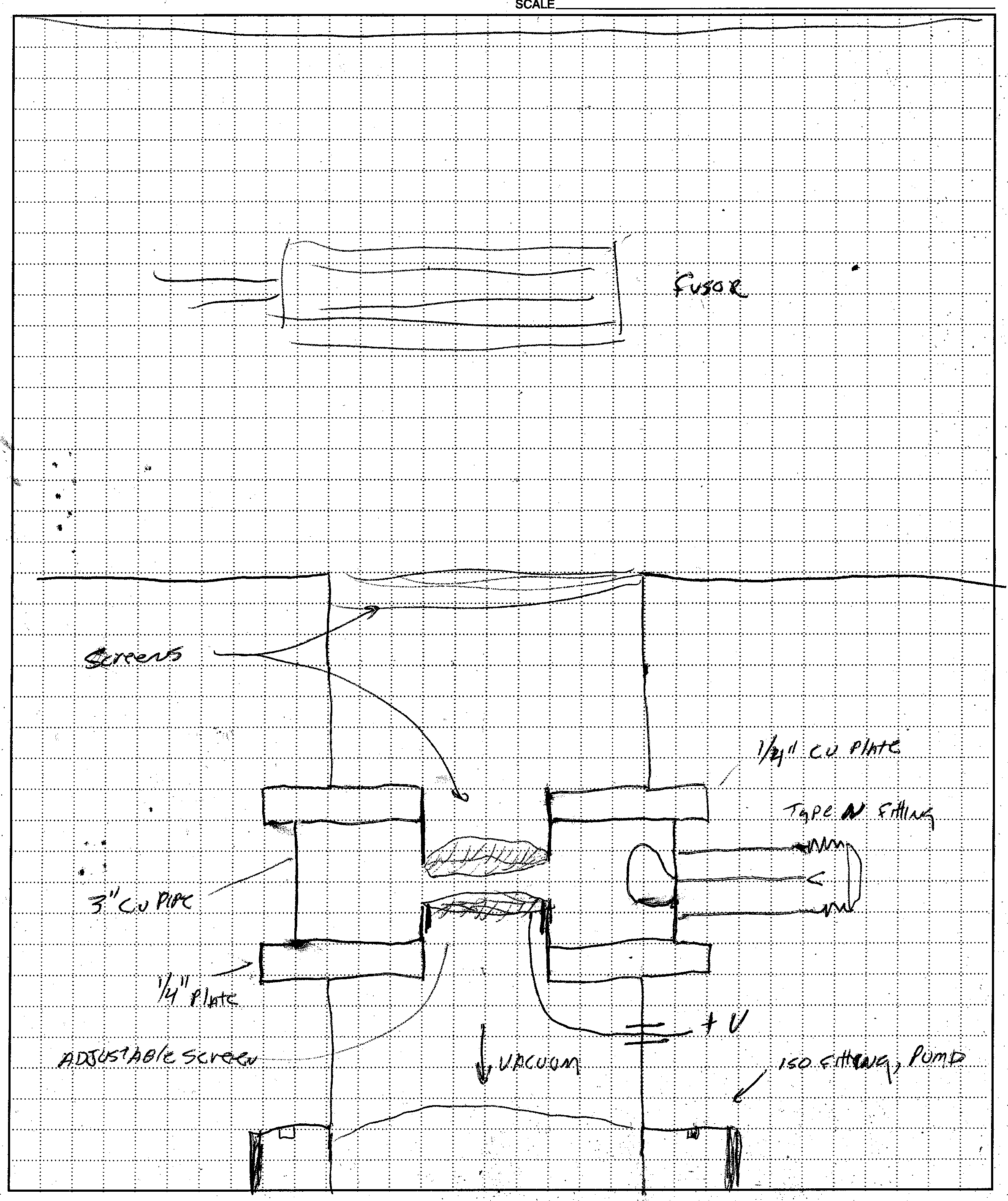

Here's a rough drawing.
From the outside it will just look like a fat place in the vacuum line pipe, with a couple of FT's brazed in.
You can think of a cavity of this type as being tuned by the capacity between the screens in the middle, across the inductor that is a torus around the outside. Energy is coupled in with a loop from a microwave source (in this case, an oven magnetron at 2.45 ghz). The E field is concentrated between the screens here, vertically. A static magnetic field on the order of 980 gauss will be applied horizontally with permanent magnets to get electron cyclotron resonance over some of the area between the screens -- it's that trick that makes this work down to very low pressures, otherwise known as long mean free paths, as the electrons just go round and round until they finally hit something and ionize it.
Tuning is a sensitive function of inter-screen distance (eg capacity). So at least one of them has to be a sliding fit and adjustable. If it's mounted in the end of a slightly smaller piece of Cu tubing that is insulated from the 1" tubing by mica, it's at the right potential for RF, yet can have DC applied to it to "push" the ions out into the main tank area. Various other schemes could work as as well, or be added to promote ions into the tank through the final, grounded screen that keeps the in-fusor DC field shape uniform (eg no big dip where the hole would be).

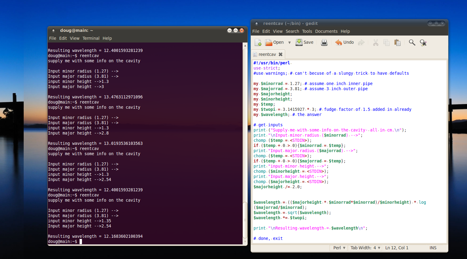

Here's some code I wrote that does the equations from Terman. The book claims the original equation will be off by factor between 1.25 and 1.75, so I built a 1.5 factor in -- 2 pi becomes 3 pi.

To run this on a windows machine, you have to have Perl (free from ActiveState) and probably change the "shebang" first line to point to where perl lives on your system. Or just read the docs for the one you get. They're recently broken the Tk interface for Gui's on this, so my gui-perl won't fly on windows without getting the Tk module from the perl repositories. This one is just a command line app, so no sweat this time.
Here's how I see this when editing it in linux/gedit, a lot more clearly.
All this is in centimeters, and for reference, we are trying to tune for 12.24 cm wavelength here (eg 2.45 ghz).

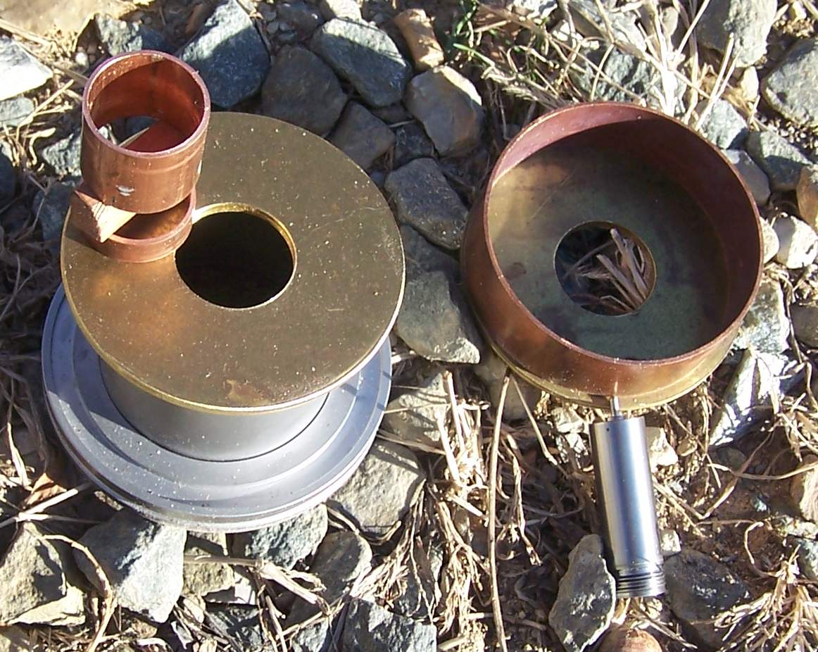

I have some defaults you can override in the program, but the assumptions are using 3" Cu pipe for the outer part of the re-entrant, and 1" for the inner size, though it's possible to make this tune with 1.5" inner size too -- just pickier. I believe that a 1" hole will let enough pumping happen for a small (6" diameter by about 1 foot long) fusor, if it has no leaks and few extra surface area contributing "warts" welded into the tank. I plan to use glass ends, covered by screen wire, one drilled to let the HV feedthrough be glued in. Viton o rings for the glass to metal seal to handle the tempco force monster there. Might even use an ignition system to run it pulsed mode, there's some good stuff out there for hot-rods that makes 50kv and more at decent currents.
