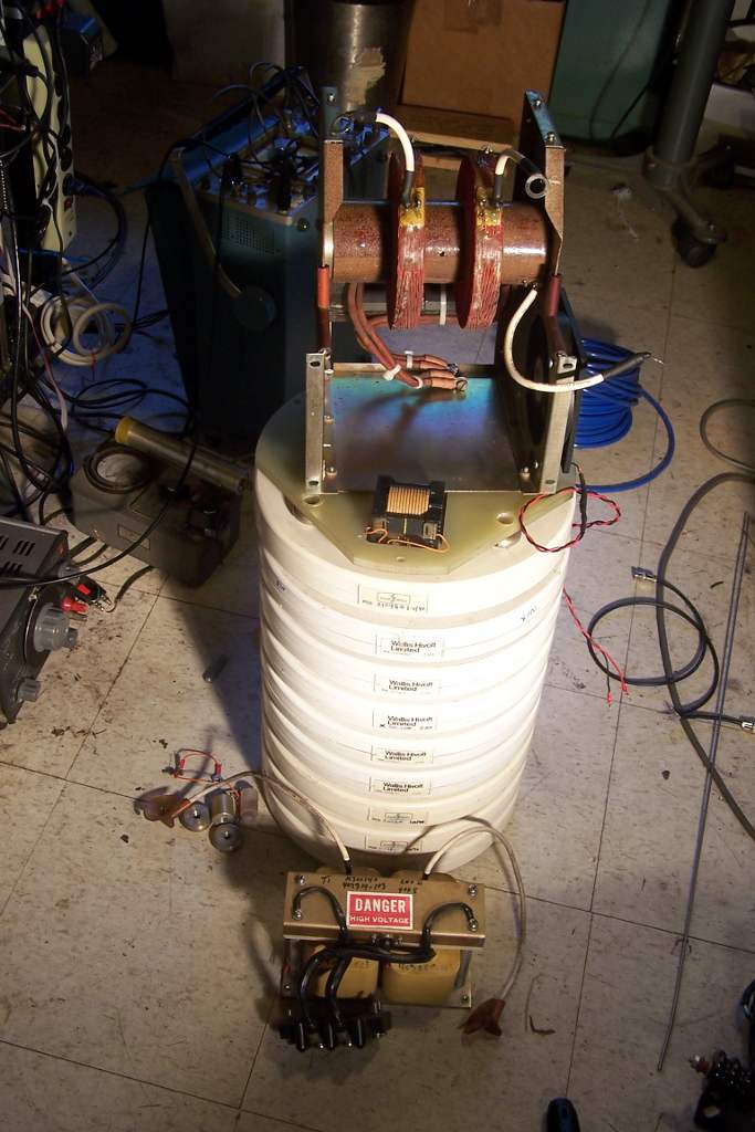

Bill, our master scrounger, just came up with the pictured stuff (among other cool things), and I have some questions for anyone (Cliff? John?) who might know more than diddly about this stuff.
Here's a pic of some of the new goodies.
New HV parts

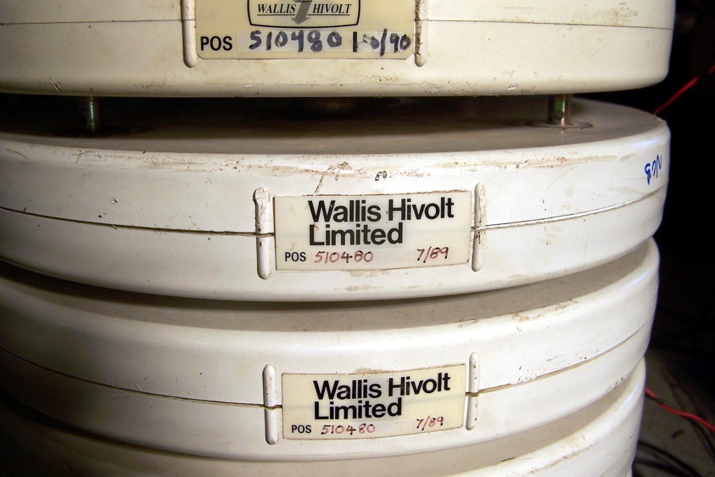

Here's a detail of a stack disk:
Stack disk

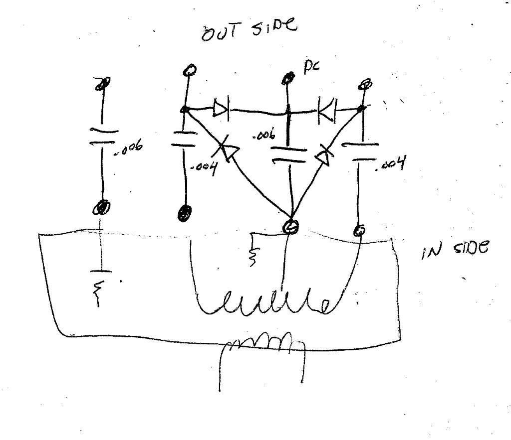

And here's what my sleuthing says is inside one of the disks:
Schiz of a disk
Now for the questions. The seller says each disk is rated at 20kv output -- does this sound reasonable, or can anyone find data on these? Seems Wallis High volt was absorbed by another company that has a not working web page. As these are full wave doublers, that implies I need on the close order of 20kv pk-pk on each drive phase.
The smaller transformer appears to be a Spellman, identical to the one CarlW has been talking about on fusor.net, and mine resonates at 11.5 khz, quite high Q.
The huge Wallis transformer is about 85::1 turns ratio each side, and resonates at 127khz, also high Q. It's all FAT litz wire, even the secondary is fatter than number 20 solid.
Ah, perhaps I got faked by a parastic (leakage L) resonance on the Wallis. It has another resonance at 28khz or so, which acts like a 50::1 turns ratio too.
Starting from here....and assuming I really need 20kv pk pk -- what would y'all do? I can pretty much make anything electronic, no troubles. I see Carl has used an inductor across his transformer to raise the resonant frequency some -- a good idea, but it would seem to have some limits due to increased circulating current. I'd guess you'd do the opposite on that Wallis transformer to lower the resonance some, I kind of doubt the stack diodes are all that fast. (or see above, maybe run it at the lower resonance)
What's everybody's favorite topology for this sort of thing? I can see where the circuit that Carl wound up with is good, and solves the problem of eating the harmonics on the drive waveform so these big resonances don't draw tons of current during switching harmonics, for example -- possibly an added feature of having that extra series resonant circuit in series with the drive?
Having looked inside a couple of Spellmans, I know they like the lm3525 kind of pwm chip (and so do I, I've been using them for other things for a lotta years).
I am not looking for super output power here -- just don't need it, my Spellman SL2KW is way more than enough watts, just not enough volts for some things I want to do here, and sadly, Cliff, I can't afford to buy a higher volt one new right now (maybe next year). I'd have to take my wife to Hawaii to calm her down after that and I can't afford both ;)
It's interesting that these stack disks have a separate cap in them. The fiberglass board sitting on top seems to be a choke with 2 47k resistors and 2 spark gap arresters series-ed across it, which would seem to be intended as an output filter using that extra set of caps. (the spark arrestors appear to have taken some heavy abuse).
I'd prefer to use the Spellman transformer if possible -- it looks better-made, and is obviously a lot smaller, which will simplify packaging -- if I can run it fast enough to get to voltage before I get to saturation. From the size, it will do plenty of watts for my uses.

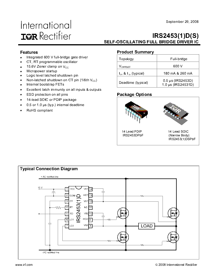

Here's a dirt simple driver that I like when I can live with its limits....I did up a PCB for this guy and have used it for testing things. Amazingly, the FETs rarely need heatsinking if things are right otherwise. Click the pix as usual to get a larger version you can actually see. I only add some proximate stiff power supply filters and an RC snubber to their example here, and it works great -- you can add an open collector to the RC timing to get current limit/shutdown and that works well too. Of course, you can't change duty cycle, and deadtime is a function of the fet and gate R (it works well if you get the R right), so to change output, you change the input volts. I run mine on a 7815 from a separate floating xfrmr. Hard to beat for simple, but not flexible.
IRS sample circuit
I've used this one with great success to drive a Glassman stack and transformers with, just straight in, no fancy L's and C's outside their little TV flyback-appearing xfrmrs. Those have two primary windings, one on the opposite side of the core, I'm guessing to get some amount of leakage L. They used a half bridge with 6.8 uf in series in their (super overly complicated) circuit.
That thing must have had 40 trimpots! So I ditched it and just kept the "good parts".
Thoughts?

Yes, the 180 kv "rating" on this seems a little optimistic -- it's only a little over knee high, not much to stand off that much voltage. It did come with a large corona donut.
But the disks aren't that thick (about 1.5") and those bolts and sockets imply that the spacing internally between inputs and outputs is pretty darn small. I mean, OK they are potted and maybe use PCB material or better for insulation there, but....20kv sounds a bit much -- and it's more than I actually need anyway. 100kv would be a huge step up from the 50 I run now, and require a lot more work on keeping us safe and getting it to the inside of the tank.

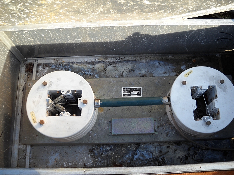

hears a pic inside the HV stack I've got
is it similar??
I took the Al corona shields off to show internals of plastic blocks
left most rectifier stack right most capacitor stack through big series resistor
Note I got it wrong only 4 caps per stack
allegedly a 50kV 100mA supply

Similar but my stacks have more connections - 4 innies and 4 outies -- see schiz -- that second cap stack is also in each disk and the center hole is round and smaller. I think all these of this sort of design were meant for serious power. In my case, I'm interested in more volts, don't need too much power, but do need the push. I am going to turn these upside down (have to add two initial caps to do that) for negative output, as I have an 11 stage Glassman stack rated for 125kv at 50 ma (zowie) that works already, and would be a lot harder to "turn over" than these. So if I wind up with plus and minus 125 kv, that's power for a beam-on-target machine that should really sing. Of course, handling those voltages in air is going to be a trick -- I'm going to try and avoid oil, but may do some encapsulating and use some thick plastic pipe etc. If I wind up shooting at silicon wafers from both sides one of those supplies should do it, but I also want to play with "harder" fusion fuels and will need the volts for them to "go". P-Li (17 Mev output) has been a favorite of mine, but the instrumentation to see hot alphas in a sea of hot protons is going to be "interesting" at best. Nice thing about DD is the signature neutrons (and also, the thing you hate once you've had enough of them for long enough). So I'm using DD to learn as the metrology is easier for that, but planning to move on if/when I get to a really good place on that. If others want enough neutrons to activate the whole periodic table, I have no argument with that, but it's not my focus --

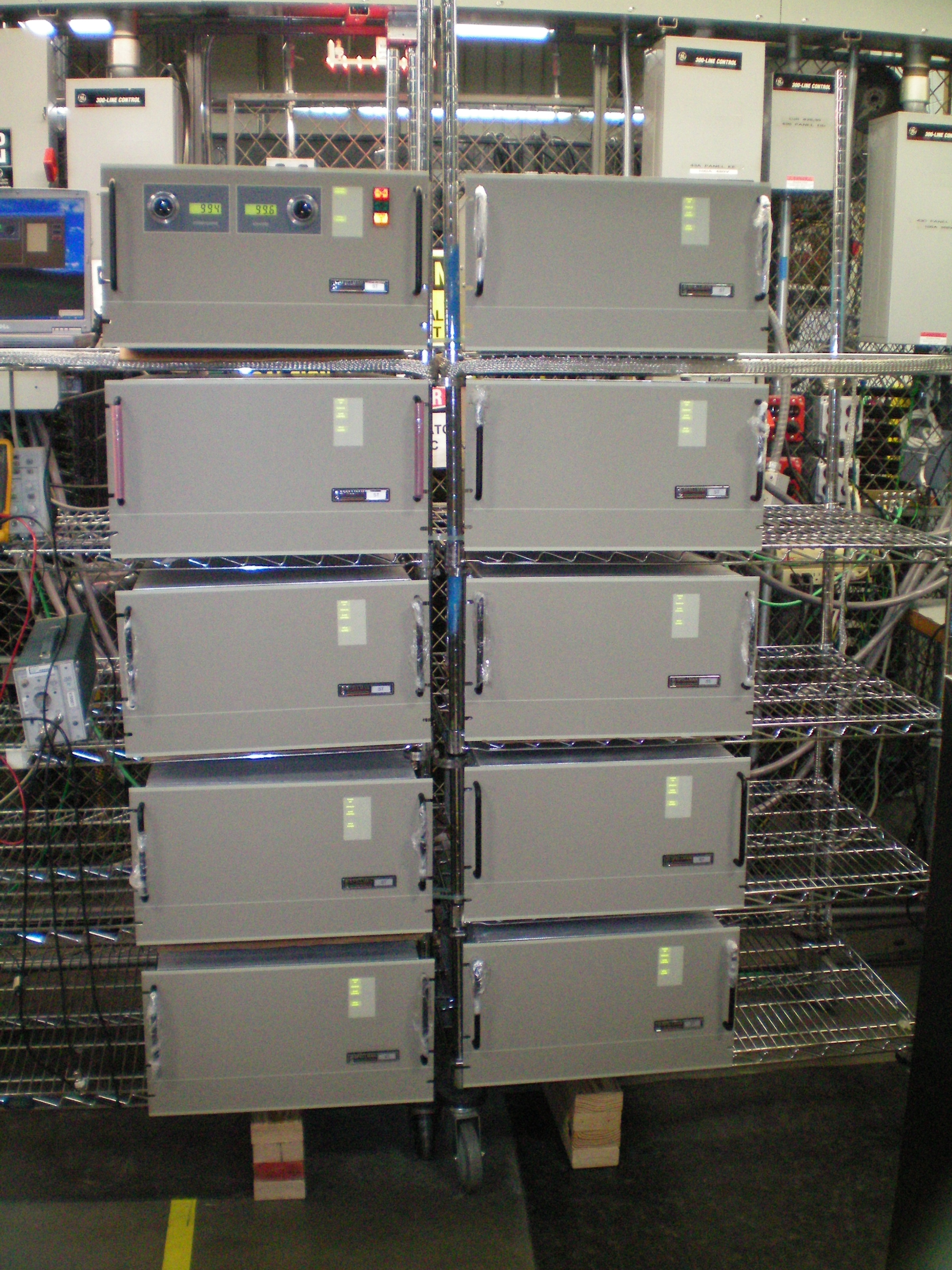

I am familiar with these stacks. They are used as the accelerator supplies for ion beam implanters for wafer fab. 160kV is a very common voltage. 20kV per stage is very typical. We have stages that run up to 25kV per. From the date codes on the stack “wafer stages” I would say these stacks are no more than 10mA, as that was near the limit for implanting at these voltages back then. Even today, still the power for high energy implantation does exceed a few kilowatts. Low current implanters can reach up to 40kW, and some specialty apps, even higher. See pic attached. This is a 120kV, 1A, 120kW implanter power supply we recently developed using our new ST 12kW rack line.
I also am familiar with Wallis HV, as one of their founders was a close colleague of mine. After he left Wallis, he went on to start a new HV company in the UK, “Start Electronics”. He partnered with Spellman in the mid 90’s, and when he retired, we bought him out 100%, and now that facility is “Spellman UK”. Wallis is now known as “Hitek”. (http://www.hitekpower.com). They are a smaller version of Spellman, and still make these types of stacks, as does Spellman. (Our SLS series, http://www.spellmanhv.com/en/Products/R ... s/SLS.aspx ).
The small inductor/R/SG’s are not for arc limiting as John thought (sorry John). They are the LR for the filter stage, working with that “extra” cap you see on each stage. The L needs to be clamped so it doesn’t see high voltage across it during arcing in the implanter, (and boy do these babies arc!). Often there would be an external arc protection resistor, external to the stack. There may also be “distributed limiting”, R’s in each stage of the stack to limit discharge current.
The Spellman DXR XFMR may not drive to the full voltage you will need to get 160kV out of the stack. This would require about twice the voltage drive. I don’t think the secondary layer to layer insulation will hold that off for long…but maybe… You will need to drive the primary with 300V, since the DXR drives to 150V. You will need to double the frequency the DXR runs at, typically up to 25kHz, (go to 50-60kHz), in order to avoid saturation. If you don’t have any luck with XFMR’s, let me know. I may be able to scrounge a set of coils from our “25kV per stage” drives.

The 10mA is both...total and each stage. At least as far as the DC average current goes. The lower stages charge transfer is higher of course. 9 times or so for this 9 stage beast. But the average current in the diodes is pretty much the DC output,(more or less...OK more).
Variable frequency on the series resonant: The series resonant topology, operating below resonance, is a really efficient and low EMI topology. The only (simple) way to keep it such, is to frequency control it, below resonance. Once you start going near the resonant frequency, approaching it from the below resonant side, you will start to go into continuous conduction, chopping and slamming diodes off. It too works, but you have now don't have the true ZCS effects like you have operating far below resonance. The big negative operating below resonance is high rms currents, and low frequency operation and instabilities at light loads. Operating near, at, or above resonance has some good advantages on delivering high power, especially over a narrow range of output conditions, with some tough tradeoffs when you have a large load variations, that could range from 0 volts, full current, to full volts, no current.
As I have said in some of the other posts, there are countless ways to control the countless resonant topologies. Spellman has two patents to control series resonant topologies in ZCS mode, while maintaining high frequency. I spent years of my life getting them to work in practical applications.

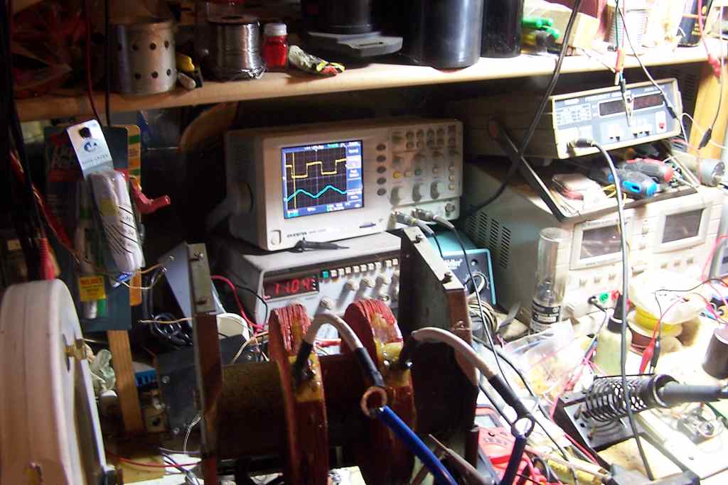

Here are some pix of the thing on one of my benches.
Benchwork
Note scope probe near the right hand secondary winding to pick up the "blue" waveform via cap coupling.

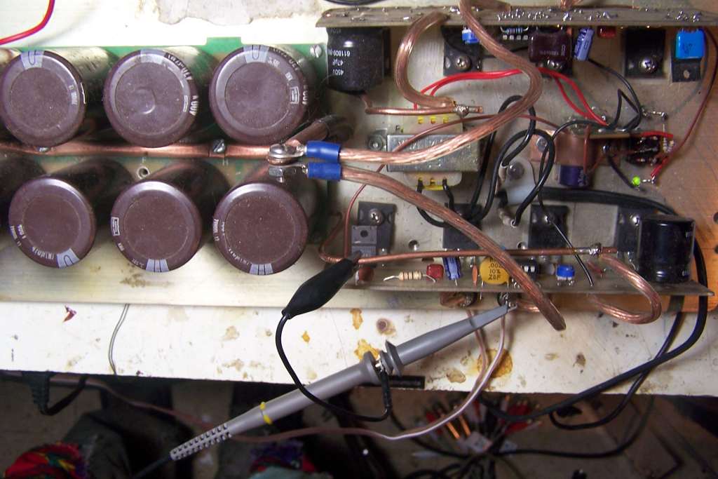

H bridges
This is a little platform I built to run a couple H bridge boards off a common large main power diode/cap setup mostly swiped out of a large commercial supply. I can enable either H bridge, the other one on top is tuned for my 35kv homebrew stack. I retuned the lower one for this range, it was originally set for 2khz to drive an old iron-starved X ray supply.

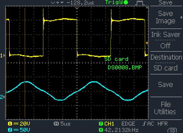

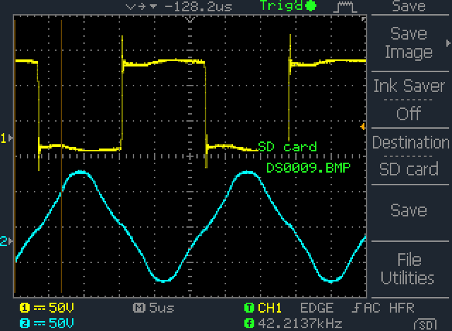

OK, you can see me being lazy here -- that scope can provide a perfect bitmap to put here (see the SD card? Well, my helper Dave has also coded that so if I hook up a cable, I can see it realtime here on the PC --in linux), but....I just took a pic. This was at 30 something volts in, about 5kv out of the one disk.
Top wave is half the H bridge output (see probe in previous pic) and the other is a probe near one of the secondary windings. As I go up in volts (to 125 so far) those edges get "faster" and my snubber starts to moan (only a 3w 1k R). Further, the distortion you see in the secondary wave becomes a bit more pronounced, a little peakier with the shoulders lower in voltage. Remember the differentiation in that second waveform due to the unique coupling method.
Also, the waveform rise and fall times on the drive get a lot faster, and hit the other phase during the dead time, bouncing off the FET diodes. Doesn't seem to hurt anything, and if experience is a clue, will largely go away under load. I tuned F for lowest no load loss about twice this level, and half max. Seems to be an OK place to be without fancy tricks.
I'll post another scope trace when I get another snubber made with more than a 3w 1k R for that part....you can see the difference in effective impedance in the load at higher oersteds (though the no load current merely scales linearly more or less), and it's kind of cool. In the trace above, it's hard to see the dead-time, but it's obvious when you cross that point and the load flips back on its own when let free. That usually has a lot less energy in it if there is a good load.
Edit:

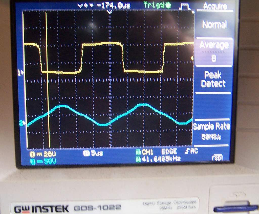

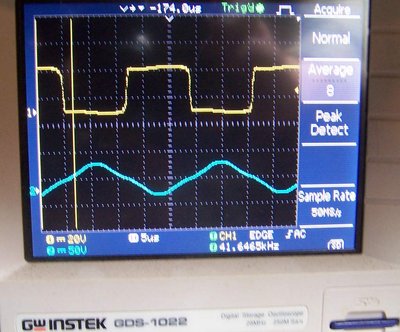

Changed snubber to 1k 10w WW (wow, that seems pretty inductive even at these speeds...the wave changed a lot for same conditions) and good .01 good cap (I'll have to pull the other one off the board to find it, but I think it was a different value -- I just lifted the burnt R to add the new one in instead).
First trace is after some retuning (note F diff on scope) for min smoke, with about 55v rail (about 110 pk pk out).
55v rails, new snubber.
Second is at full snot for my bench supply about 125v.
Full output
I note much faster risetimes, and some scope probe and ground loop ringing off the catch diodes. Draws a little more now when tuned (it's a touchy adjustment with a too wide range trimpot), but it seems mostly in the snubber (based on what gets hot, I'm blowing about 1/4 to half the power into that snubber now, probably need to reduce both C and R). Seems to always be flipping during the deadtime with this snubber.That slight shelf before full turnon is a bit worrying, it's probably where the rest of the power is going. It's been there throughout. But the fets aren't getting hot at roughly 70 w input here (no load but the voltmeter on the output with HV probe).
