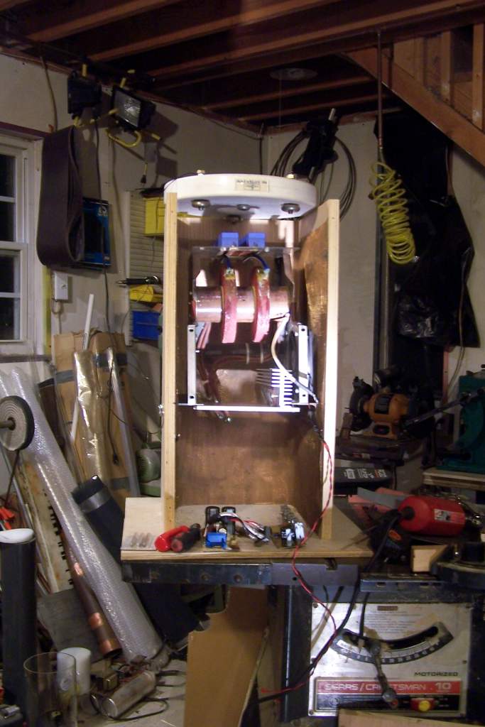

Mockup of most of the parts
This is at the point where I know it works. I've full-power tested it with one disc of the multiplier on the bench, but to fool with it much more in reasonable safety, it was just time to get the box going on, get the HV parts mechanically stable and so on. All this stuff is heavy, and just propping it up doesn't get it for the fiddly parts of the work, like driver optimizing. I scrounged the mains bulk supply and heatsink out of a battery charger (Thanks BillF), to use with one of my full bridge drivers, with perhaps a switcher in between to take care of providing the main bridge in current mode, so as to be able to vary the output easily. Other schemes are possible, but I've also made the buck inductor for the front end supply, so that's probably how it will go.
This stuff is surprisingly heavy -- the xfrmr or one disk weighs nearly 20 lbs. So it seemed a solid mount was in order before progressing too much further.
Since I'm shooting for the 100-120 kv range for this, we will probably use only 6 of our 9 stack disks at first, which means lower current at the bottom of the stack for a given output current, nice and conservative.
Not coincidentally, the resulting height will be just right to mate to the main fusor HV feedthrough.

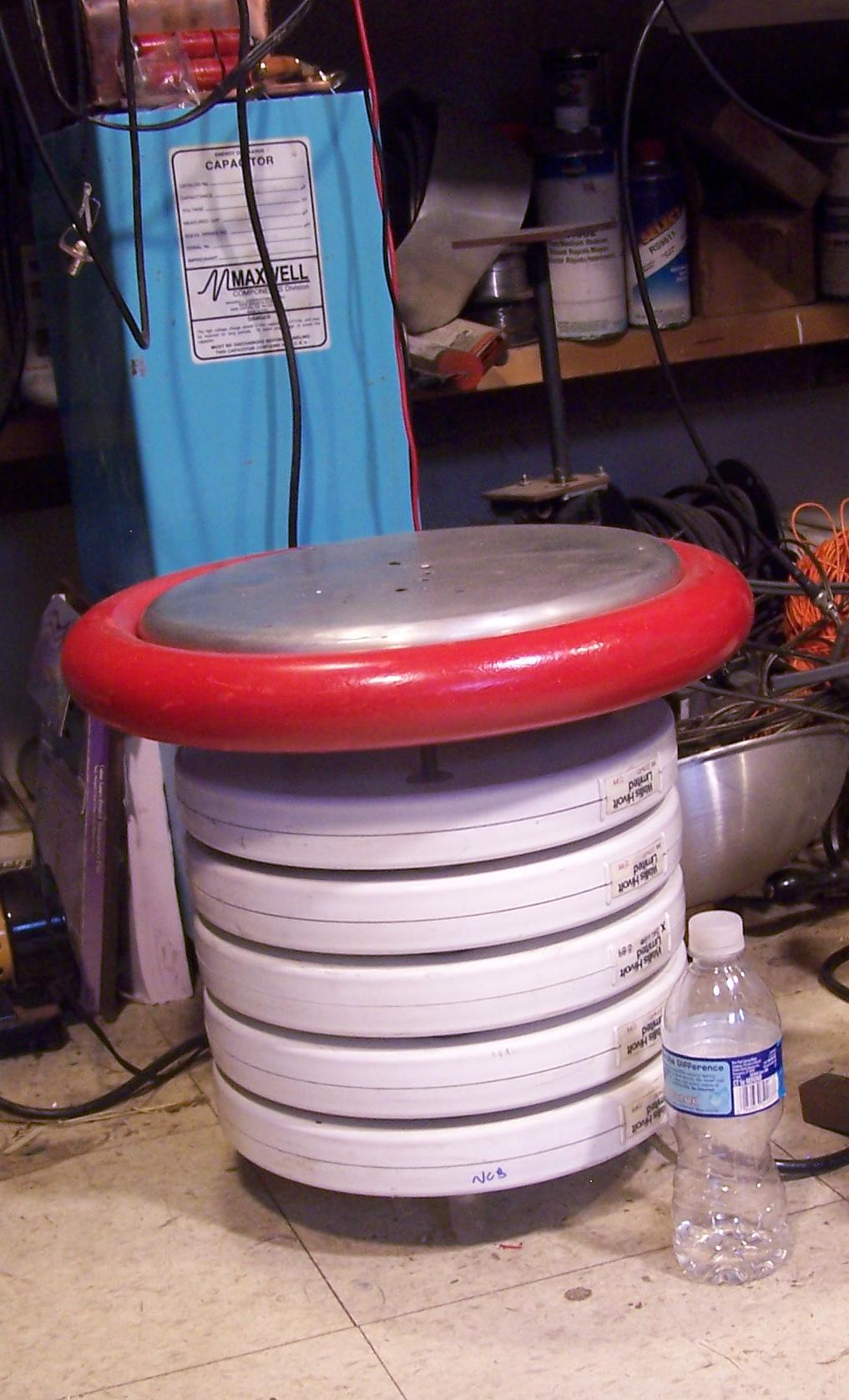

I will, John. The thing came with a big ring/hat for the top, but my experience is like yours. At 20kv losses start getting serious. At above 50kv or so, it seems any air gap can be breached via the streamer phenomenon -- unlimited length sparks more or less. So if you can force a situation where the air never sees more than about 20kv across any gap, you're way ahead.
I am wondering if I could bend some 1/2" or 3/4" annealed Cu pipe into rings that would mount at the interdisk gaps without wrinkling it too badly. Can't go much bigger than that or they'd be touching -- the disks aren't all that thick. They do have little round corona nuts on all the connecting bolts as is, but I suspect you're right (again) that they won't quite get it done. The good copper screen in there is to prevent emi coming out of the drivers messing up other stuff, and to make sure that arcs do have a place to go -- other than to me, but again, I saw a 100kv system toss a spark 6 feet out, then back to a couple inches from the beginning. Once was enough for that, scared the .... out of me. I'll get a pic of the stack up here in a minute or few.
Stack. One more disk will be added to this in first use.

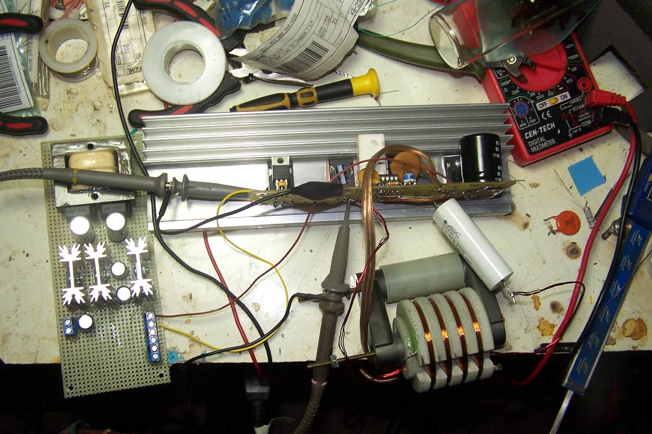

Ok, here's a video of the thing with another load. I built up a new driver board for this one, using fets better suited to the speeds and feeds I expect, in this case lower voltage but larger current ones. The interesting thing is with some loads, the fast drain transition of the fet is enough to overwhelm the 25.5 ohm series resistor in the gate and turn the fet back on momentarily! Gotta fix that, and I'll embed another video of the fixed version when I do. I'd used the R to try and slow the fet down some and hide some of that deadtime, but obviously that is NOT the right answer here. For one thing, the evil current spikes are causing an on board bypass capacitor of 82 uf to get hot.
Sorry about the lousy focus, I'll dig up another camera and see if it has a macro mode.
Driver is an IRS2453, fets are IRFP 264's in a full H bridge. I am basically using the schematic in the chip data sheet, with a .002uf timing cap, and a 2k + 2k pot for the timing R, and 25.5 ohm gate R's. That last is the parameter I'm tuning on right now. The chip has what I'd call fairly extreme dead time, and it's not known at this point whether I can make the R's large enough to eliminate monkey motion there without having what we see in the movie -- the miller capacity of a fet can turn an "off" one back on when the drain waveform moves too fast, which will only be worse at the higher rails voltage in real life, or so I think. Hopefully I won't have to add some npn/pnp emitter followers (complimentary symmetry) to stiffen the outputs...I am using an RC snubber across the bridge outputs of 100 ohm and 1k pf, swiped from that battery charger supply -- it had about the same speeds and feeds...I may try increasing the C to the point the R starts getting hot and see if that helps any, but I think the load will kind of swamp that unless I get ridiculous there.

The Wallis transformer hits rated output for the stack disks with 125v input to the bridge rails, so I went to lower voltage fets that can hack the higher current here.
The "real" transformer isn't as tough a load (at no load) as the one I'm using on the bench is, but the one pictured is more representative of someone's homebrew transformer (because that's what it is). It lights up gas tubes nicely from a decent distance, particularly if you're holding one end of the gas tube.
Pic of the electronics and transformer test load
Here's the electronics involved. The perfboard is the "housekeeping supply" to run various things like the H bridge logic and fans, a simple building block that emits 15v, 5v, and unregulated 20v on one winding, and 15v and unregulated on the other -- the output float from the line, and each other for convenience. It turns out this driver circuit doesn't mind one bit about what order the supplies come up in -- so you can have it running, then apply main rails voltage, or the other way around, nice. I added the series C in the transformer primary to see if that had an effect, re walking into saturation as mentioned in that excellent book JohnF recommended (and now I recommend it too) but in this case no change at all occurred -- the driver is very symmetrical it seems, even in the funky modes shown in the movie.
